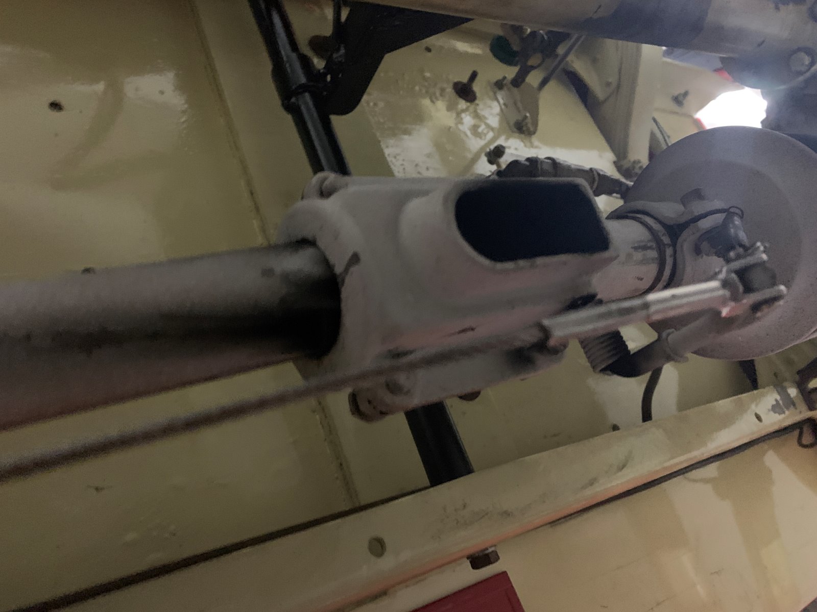

I have this exhaust attachment which seems to be for a whistle but I cant find any information about it.
There is a foot control activator on the floor.

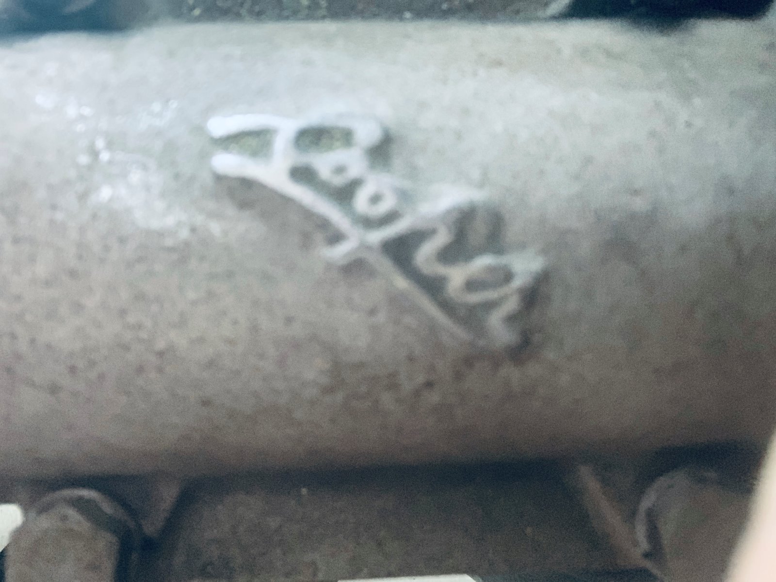

The embossing on the back of the unit looks like Cooper, but may not be.
I suspect that the whistle itself is missing.
Does anybody know what it is?

It is a cut out, not made for a whistle, makes cool sounds when activated, Bob
Posts: 5545
Last Name: Gregush
Location: Portland Or
Re: Exhaust Whistle
Post by Mark Gregush » Fri Jun 19, 2020 11:15 am
Back in the day it was also called a motor tester which I think is how how Cooper marketed it. :lol:
