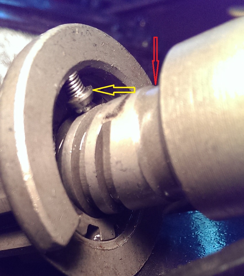

Could be the spring loaded drift pin on the Bendix counterweight is missing or stuck.
That little friction making piece keeps the Bendix gear from running forward on the screw shaft back into the ring gear.
The knocking may be the gear running into the ring gear and bouncing back off.
