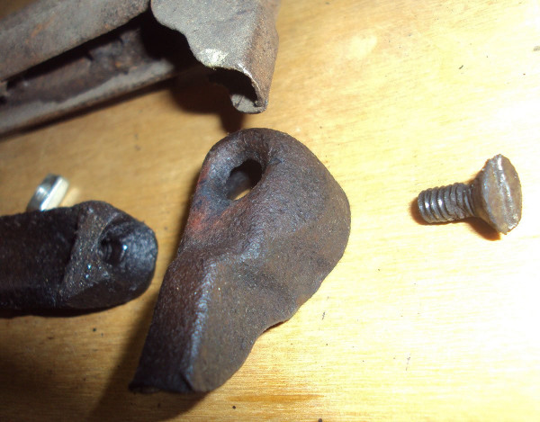

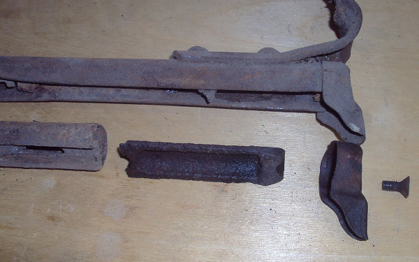

This is what is going on there. I don't know what years used which screws but this one is a #12-24 x 1/2 lg steel screw. I have seen longer. That cap matches the '15-'22 in the catalog. Hopefully you can check your size with a tap in the filler block.
