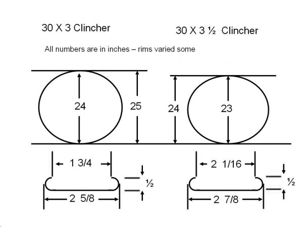

It took awhile but I finally finished the analysis of my tire slippage problem.
I have put together my findings in the attached document.
I believe there are two issues in play.
One with the wheels.
One with the particular tires that I had.
let me know what you think.

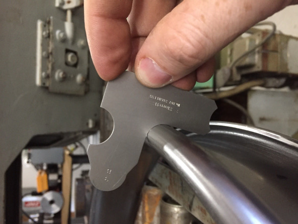

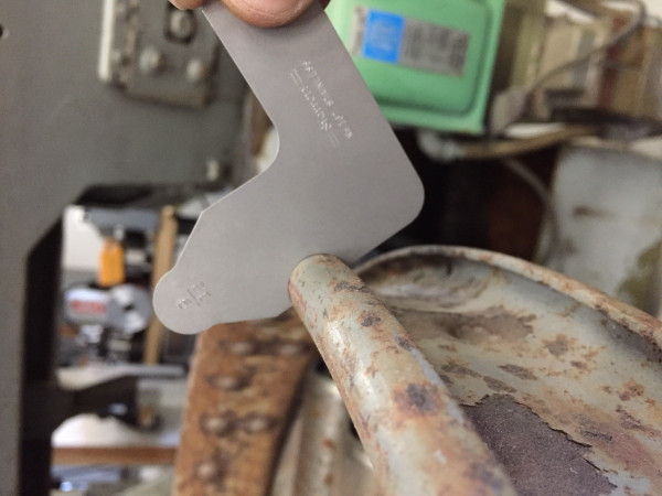

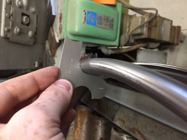

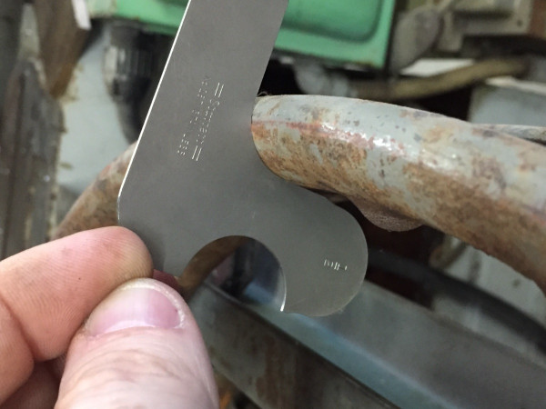

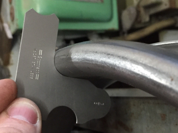

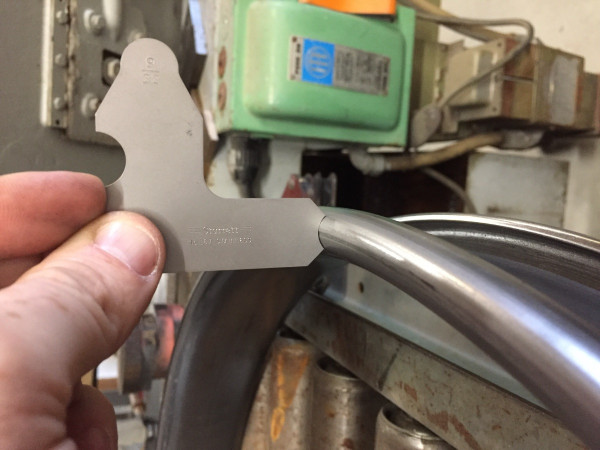

I never put much thought into the subject of rim profiles, as I have always been under the impression that the reproduction rims available in recent years were made to original Ford prints. I have seen reproduction rims made in the 70’s that were of thinner material and clearly different profiles, but thought those times were behind us.
I pulled a really nice original non-demountable, a McLaren, and a New Zealand rim to compare the profiles against one another. Due to the (undoubtedly many) variations in original parts, I make no claim that this original rim is “correct” in any way. I also do not have access to the Ford drawing.
First is the original rim. The bead section blends from the flat center at roughly 1/2” radius to the widest point, then wraps the remainder at 9/32” radius
The McLaren has a similar 2 radius profile, but starts with a smaller 3/8” radius, and wraps with a larger 11/32” radius

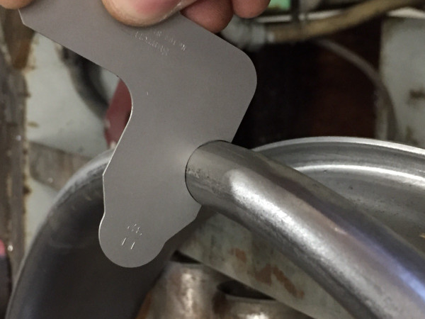

Re: McLarn Wire Wheel Tire Slippage - In Detail
The New Zealand rim has a more complicated profile that starts with a 20-30 degree angle, then a 9/32” radius peak, and a 3/8” radius return
So in conclusion... I have come to no conclusion!
I don’t believe that the original rim manufacturers were any more consistent than what I have shown above, and I suspect that the modern/original tire manufacturers have/had similar inconsistencies as well.

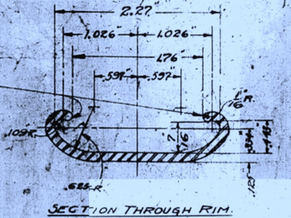

Most times the issues with slippage is flakes of rust, undercutting the clincher curve, leaving sharp clincher rim. With edge less than the 1/8" smooth rounded thickness, lets the tire casing gets rim cuts and can slip or worse.
The only Ford print located is this one, early clincher rim, 3 1/2", plain rim for wood felloe.
Close up of print, posted years ago on forum.

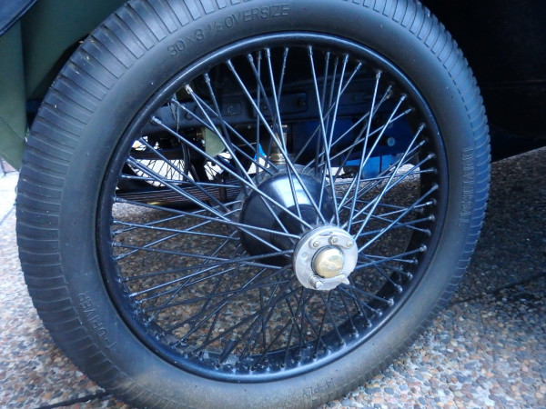

Well said Pete, but until you have to change the tyre, just put more air into the inner tube 10lbs at a time until the inner tube stem remains vertical. I run my T drivers at 100lbs on a 1500Kg English Crossley to cure tyre slippage....N.

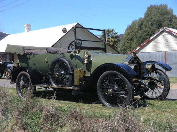

Thanks Peter for the photo of the tyre/wheel(front).
You will notice the inner tube valve stem at the 7o'clock position is at 90 degrees to the rim and is pointing to the hub. 80 psi was required to stop the tyre from creeping on the rim.
100psi stops the rear tyres from creeping which I think is due to the braking forces. ....N.
