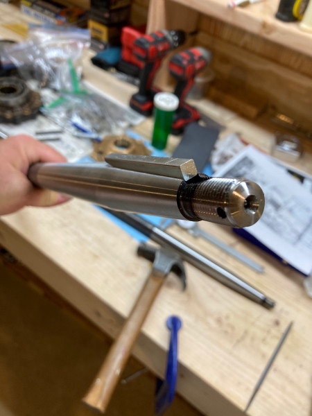

I am on my second pair of new axles. The keyways on the first pair were not machined correctly so they sent me a new pair. The keyways on these measure .245-.246”. The Ford drawing specifies .247-.248”. This doesn’t sound like much of a difference but axle keys are nominally .250”.
The keys fit in the new axle shafts very tight and need to be seated with a hammer. Is this normal? I have not actually tried to drive them home because I do not want to damage the axles in case I decide to send them back. I realize that my original Ford axles are probably worn a bit but the keys fit in them snug, not forced fit.
I am hesitant to dress down the keys because the hub is probably already worn and I do not want play there.
Any ideas?

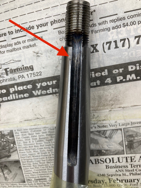

Post by Dan B » Mon Jun 22, 2020 10:22 pm
Here’s a pic from the first set of axles received. Both were the same. I’m this close to putting the originals back in.

Thanks to Scott for the kind words. Some know that I Iost more hair sorting through this recently. The nice thing about the axles you're using is that they are consistently wrong and the outer keyway seems to be the only real issue with them. In all other respects they are pretty nice. I tried a set from a different manufacturer trying to get away from this issue and they were all over the map with several dimensional issues that made them unusable. So far as I know the ones you have in-hand are the best available.
I was going to post documentation photos that I took at the time but the forum software doesn't like the dimensions and I don't have my easy resizing software since a recent hard drive crash. With four axles in-hand all the the keyways were 0.247 when checked with gauge blocks. The key stock I used was 0.251. In the end I think I left the keyway about 0.0005-under after taking an equal amount of material off of each side. That made for a nice tap fit in the axle and took care of some of the issues with the hubs I was using.
