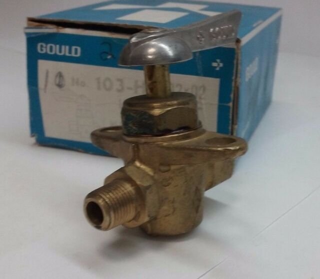

- Posts: 5552
Re: Electric Fuel Shutoff Valve Installation Question
Something like this would take a lot less plumbing then the Model A valve:
