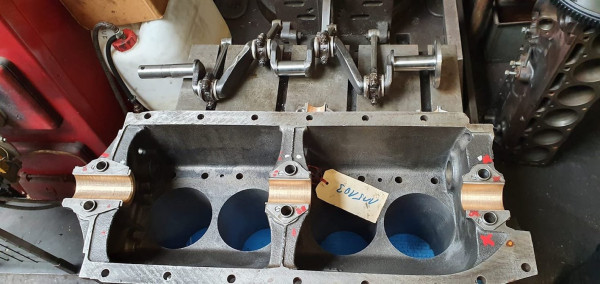

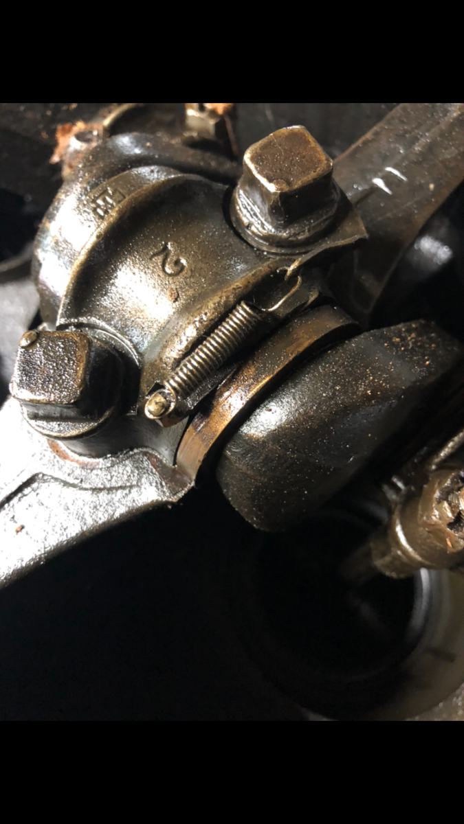

Saw this on MTFCFB. What do you engine rebuilders think of it?
- Posts: 4089
Re: Instead of pouring Babbitt...

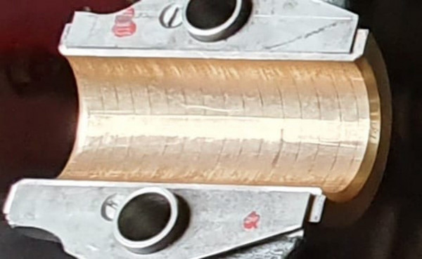

Looks like a bronze liner? Held with screwed down plates. One cap with liner shown in foreground with the crank. Don’t know if that’s good or bad.
More concern is no radius to the turned crankshaft journals.
Ford babbitt bearings last long enough for most T’s.
How is oil supposed to get to the mains?
- Posts: 5545
Oil pump to the caps maybe?

If the caps are babbited, it'd be very similar to a very early engine, which I believe, had cast iron bored-in-place bearing surfaces in the block. Not the longest lasting design.
On close inspection of the first picture, it looks as if the caps have bronze, too. If the caps are bronze, I don't think much of it at all, and without super-duper oil filtration, the crank is going to score pretty badly pretty quickly. The babbit digests all sort of junk, allowing it to embed harmlessly out of the way...not so with bronze. Bad idea.

I have to agree with Scott. Babbit is so forgiving. If you think triple gears take a hit, I do not believe under load that engine will last. The oil has to be so perfectly clean as stated by Scott in order for in to hold up.

Charlie, I don't think that route would be any cheaper than a babbit job. First, the block and whatever caps are used will have to be accurately machined to accept the bronze liners. Then the liners would have to be machined to fit on their outside diameter. Then each liner needs to be locked in using the set screws and plates shown, once the plates are made. Once fitted, the whole would still likely have to be line bored.Then there still needs to be work done on lubrication methods/internal pipework. That's one heck of a lot of accurate machining/fabrication to be done.
From my memory, Dodge used such bronze bearing shells, but these were babbit lined so that in effect, one had replaceable babbit bearings.

With a couple of thou of babbit on it I’m totally good with it. Of course I’ve done something effectively similar on a set of T rods and they are just fine with about.002-.003 of babbit!!

With Les on this, good with it, would be better if it had a swipe of Babbitt on it.
The American Lafrance V12 engine had 1\4" thick Bronze replacement bearings as did many WW1 Europe aircraft engines, cars and trucks, and of coarse nothing new when it comes to steam engines and pumps etc, used and around long before Babbitt.

Hey, Babbit washed bearings are a little different than bronze/brass bearings.

to add to what you mentioned regarding early engines, for others thinking that reverting to 100 year old technology as an improvement, one thing the designer needs in any plain bearing, particularly in reciprocating bearings, are features of embedability, formability, and compatability with the material it is in contact with.
Bronze bearings were in a number of engines of the day, and as was found around WWII, SAE tested and found that those engines so equipped benefited from hardened crankshafts, resulting in more robust bearings (less damage to crankshafts). As a design, it's clear that bronze bearings in engines did not give way to babbit because babbit had a stronger lobby.
Les' solution is similar of course to insert bearings and in fact is an insert bearing. That babbit is performing a function.
That said, no one needs to avoid using uncoated lead/brass alloys in automobile engines because I said so. Defying good known engineering principles, and disregarding it's total relegation to history as a practical solution is no skin off my nose. Knowing what we know today, it's just stupid.
My heart goes out to that shop's customer. He has no idea what he is in for, and the shop better pray that the engine sees infrequent, easy use until out of warantee period.
One final note with regards to use in steam engines. First, the oil was a total loss system on reciprocating parts, constantly flushing out contaminants; embedability is far less important. Second, the lubricants were essentially boundary lubricant, not hydrodynamic lubricant, and babbit would not last at all on reciprocating joints under those conditions. Finally, steam expansion while extremely powerful, does not have the impact of an internal combustion engine, nor suffers from extreme pressures exerted during preignition which can occur with gasoline engines. In steam engines, tin/brass bearings were ideal, and frankly after all of these years, still is. Any comparison between steam and internal combustion engines' reciprocating bearings is comparing apples to oranges

Calling it, reverting to 100 year old technology is one way of putting it but in saying 100 year old technology that still works today is another.
How may of us have pulled down modern engines that are running on the bronze/brass/ copper alloy of a slipper shall and the crank is still in spec for a new set, well I'd have to say over 50 years it as been many for me. Engines that run no filters, low oil pressure, poor servicing, high mileage and 3 times the rev range of a T.
Would I do it myself for a T engine? No because Babbitt work is easy for me.

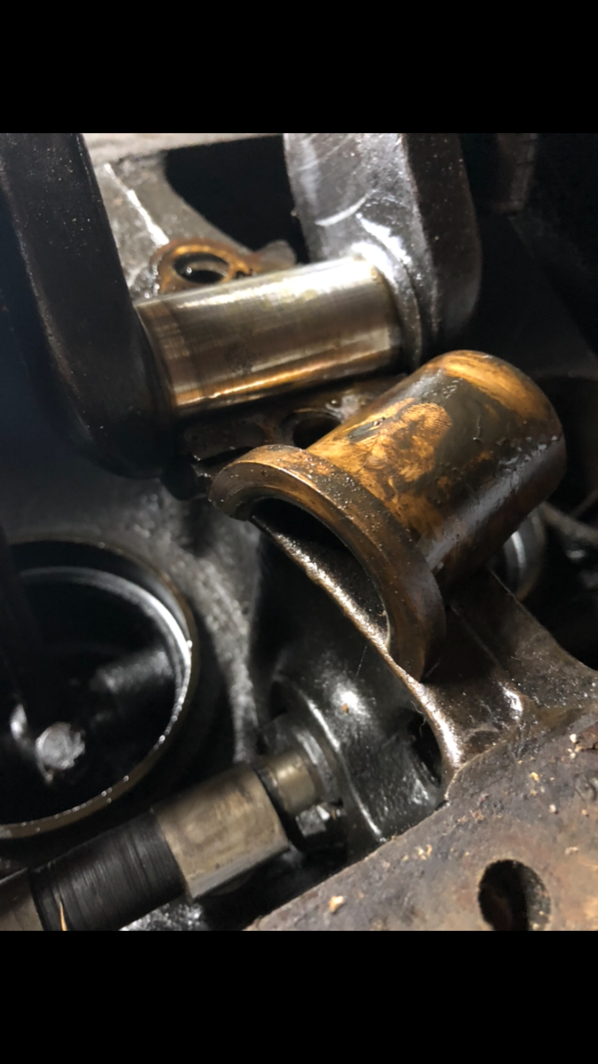

I have rebuilt two A's that had inserts in them that spun bearings out of them in less than three hundred miles,the problem was they did not run a filter system and it spun them out, some may like this ideal and it may work for some applications but I will stick to the Babbitt. Just my thoughts on this one!

Those engines you refer to were designed and engineered to work that way from new. Model T engines were not. Besides, I believe modern engines use hardened & nitrided crankshafts. Still, babbitted inserts, done well, should work, (as others have attested to from experience). In my case, my dad installed a bronze bushing in the the 4th main of my '21 Roadster. After 30K miles it was inspected and still had the .0015" clearance he made it to.

I think the bronze, not brass,bearings will be fine as long as they get lubricated, I am seriously considering installing bronze in my Maxwell 11AB engine. I am a rock crusher repairman, some of these crushers use all bronze bushings. The ones I have worked on for over twenty years run a minimum of forty hours a week and many run two 12 hr shifts 6 days a week! It was recently decided to rebuild these,( just because), and very little wear was found. No pinion shafts or spindle shafts ( the steel components that run directly against the bronze) needed replaced.The shafts and spindles are not hardened. These run with an oil pressure system at 20-30psi. The oil is easily contaminated, and usually is contaminated with dirt and water. The 400 horse power bushing crushers are amazingly forgiving. These crushers have so much belt tension on the pinion shafts that you can't turn them over by hand, even with the oil system running. Yes I think that wiping the bearings with babbit is a great idea. I'm not sure that they needed to install locking plates where a simple dowel would have worked. It appears that they are also running inserts in the rods. Something that is very important with the bushings is to have oil groves, hopefully they put some distribution groves in all their inserts, all of the crusher bushings have oil groves. On the Maxwell, one of the fixes for rods is to install model A rods, because they are lighter and better the way they bolt on the crankshaft. Maxwell's have a 1-3/8" journal and model A's have a 1-1/2" journal. So very thick babbit or some type of shell, and the main bearings are brass/bronze bushing though still babbit lined. Like Less, I think that the best oil system is a pressure system though my model a engine in my race car is running inserts with non pressurized mains and dip system for the rods ( stock oil system). The fellow ( Ron Kelly) that built my engine has engines with over 60,000 miles still running with no problems. I am very interested in how this works out, so keep us posted.

Jerry. That's the point about the posted question, A model T using bronze instead of conventional design or engineering. It worked before and after so really the question still remains on will it work for the T? We need an answer from someone who has done it before and give a result, just like your 4th bush, other wise we are working only on speculation and opinions.
Checked my engineering books and the min amount of Babbitt on building a shell of copper alloy/bronze crankshaft bearing is just .001 thou.

no one has mentioned using brass bearings. I have mentioned tin/brass (bronze). What bronze alloy will you use? How will it be finished? Do you know why the steel parts wore more than the bronze bearings in the rock crusher? In nearly every instance, where there is any possible source of contamination, the bronze will embed with particulate and the asperities will gleefully cut the steel to ribbons.
Before you commit your Maxwell's crank to a premature demise, do yourself a favor and do some study on bearing design and do not cut metal until you understand what Conformability, Embedability, and Compatability all mean with respect to bearing design.

I think that if there was a place that I'd put a bronze bearing where it wasn't designed to be, the 4th main would be the place. It's isolated from reciprocating forces and has a steady diet of a little clean grease and some dirty oil. That is the precise type of shaft and lubricant environment bronze bearings were historically alloyed and used for. Still, babbit is better suited in that location due to contaminants, and vendors do a very nice job and for less than I can install a bronze bearing, so will stick with original design. And due to the potential for flexing and minor misalignment at that location,I would personally use bronze or babbit before a ball bearing, to be sure.

The bronze insert against the Model T Crank will be too hard and quick failure will result.
Where it's a splash rather than high pressure system the bearings and crank will not survive in the atmosphere of a Model T.
They chose babbitt because it's a softer material than bronze and it has ability to eat the dirt so as not to destroy the crank journal surface.
Modern insert bearings have micro layer of babbitt and have high pressure to wash debris away so that the crank rides on film of oil constantly.
In same situation if there were high pressure using a bronze bearing it still wouldn't have the ability to digest the fine debris that is always present in an engine. Note the picture; this is a rear main of a Model T that had been done by others and according to customer only had 10k miles on it.

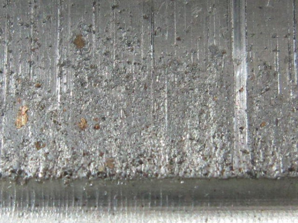

See the amount of debris stuck in babbit, You can identify each piece, bronze, rust, glass beads. This engine had a Dubats crank in it and other than polishing crank would of been fine.
This is a testament of babbitt considering a poor engine rebuild the crank survived.

Bronze worked before...that's true. And as a bearing for crankshafts and such, it (bronze) was abandoned. It is not speculation to state that the bronze will embed with particulates and slowly cut the steel to ribbons. The most successful early engines using bronze bearings also sported very hard crankshafts after designers came to this conclusion.
Those same particulates will also embed in babbit, but far further in, leaving fewer asperities protruding to cut the steel, and when pounded on, simply embed further, safely away from the bearing surface. It is not speculation or opinion. It is one of the natural features of a very lubricious material (babbit), which has made it so successful in so many applications for so many years. It has been supplanted by more modern materials in recent times, but typically in every one of those applications, superior filtering of the lubricant was provided for. The T was designed over 100 years ago, to run at about 1200 RPM for a few years and some (my opinion) ran for more than 30,000 miles over maybe 10 years. We on the other hand, run them flat out, well over designed RPM for many 10's of thousands of miles for sometimes 30+ years, all after they are 100 years old! I will reitterate for anyone who missed it before: it is just plain stupid to put bronze bearings on a crankshaft in a Model T or similar.
I am not the be-all and end-all for this subject, but did spend a career in precision lapping and honing, bearing design and gas-bearing manufacturing. If you want a good lap to cut even the hardest materials, the lap is the softer material. It is then embedded with desired compound, and much harder materials are lapped. One of the more interesting gas bearing gyros we made used Ferro-TCc material. It was a metal matrix of stainless steel with Titanium Carbide evenly dispursed. The aluminum lap flattened the material to 1 millionth of an inch flat, and then we gently polished the stainless back, leaving islands of super-flat TiC. It was an extrordinary example to new engineers in the ability for a prepared soft metal to cut away one of the hardest materials there is.
The softer the material, like lead or tin, the shorter the time the lap is useful, as the particulate continues to embed and ceases to cut. Brass, bronze and aluminum are much better at lapping things because the particulate stays trapped on the material's surface and will cut like crazy until the particulate is literally worn out. The old boys knew this and wrote books about it. Folks today are too smart to read those books, and claim that the ones who really know are just sporting "opinion". I know this because most everyone I worked with were far smarter than me, but in the end accomplished very little in their career other than making sure everyone knew how smart they were. I spend my time either in the shop or the clean room using time proven methods on new materials and developed a number of successful products and processes which have been in production now for over 20 years in the guided missle business.

I could understand going to the effort of the thin babbit bronze liner on the main caps because that is where the bulk of the bearing load is. When I did my thin babbit bronze liner rods it was just on the rod itself and the caps are just babbitted like usual because again that is where the bulk of the load is.
Just my thoughts
Just my thoughts

Here are some pictures of a motor I bought that had a bronze 1/2 bearing on the center main as part of a device to take up end play.
