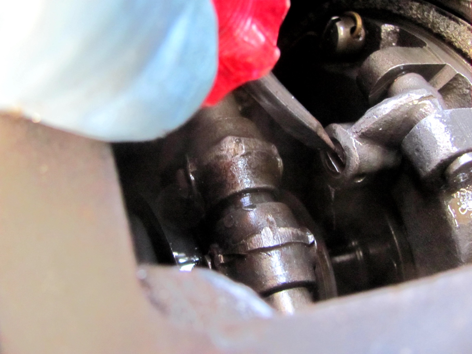

Check first that the handbrake/clutch lever is fully forward and clutch is engaged. Sometimes floor board shifts and causes the handle to not fully release the clutch spring.. verify by looking up under to be sure the adj. bolt on the clutch lever arm clears the cam on the cross shaft.
Then most likely the clutch needs adjusting, follow the procedure in Ford Service book, adjusting the 3 clutch screws in side the inspection cover.

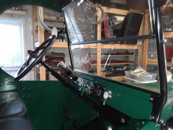

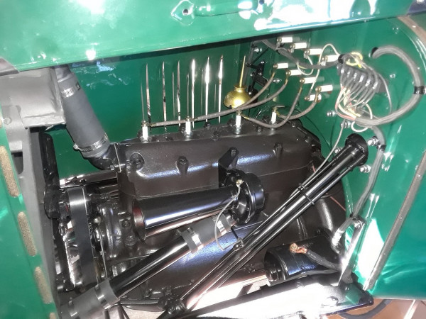

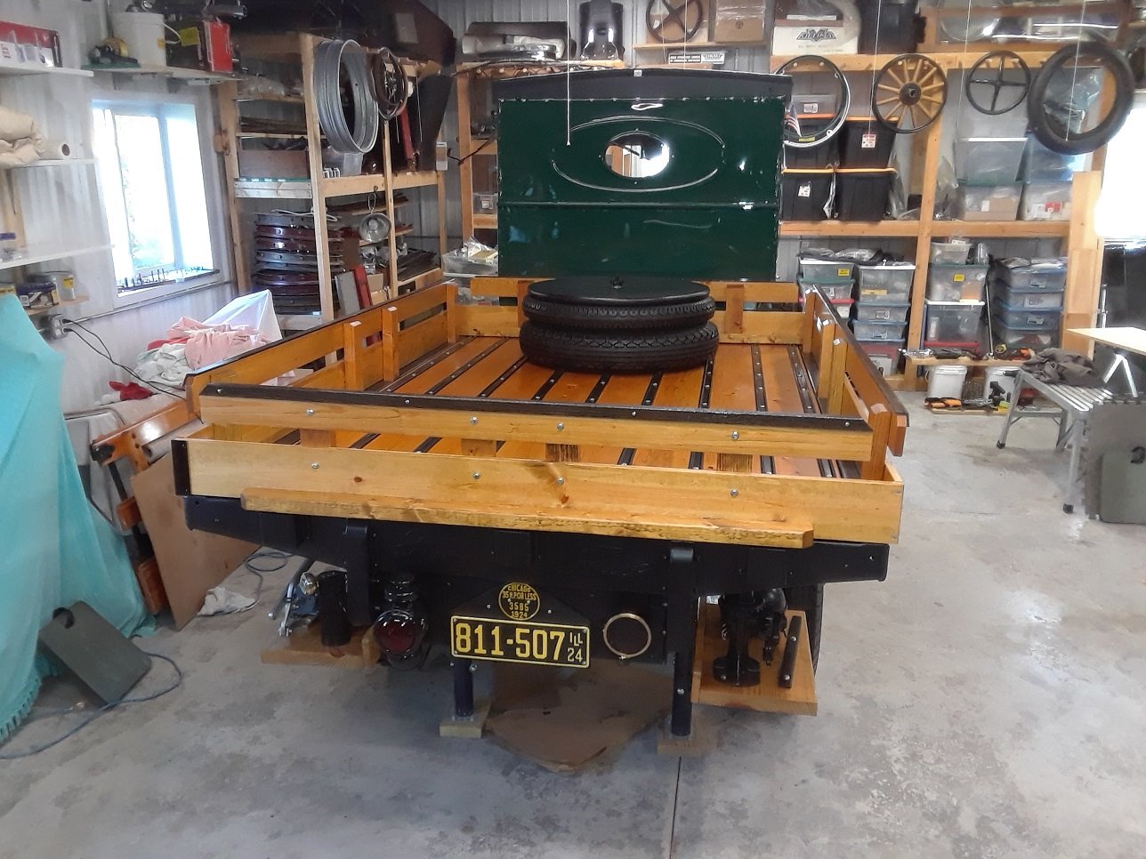

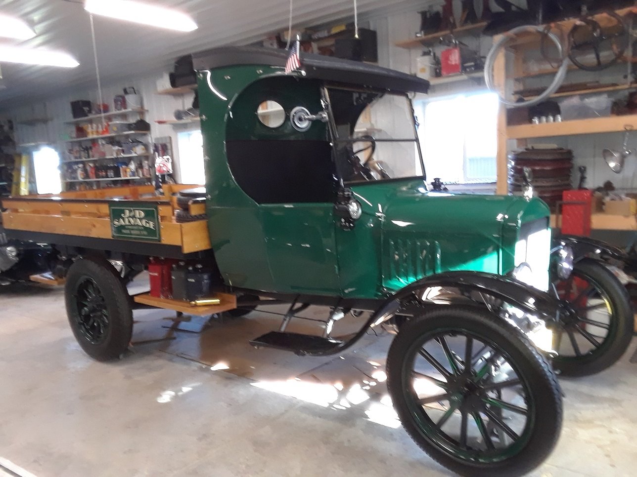

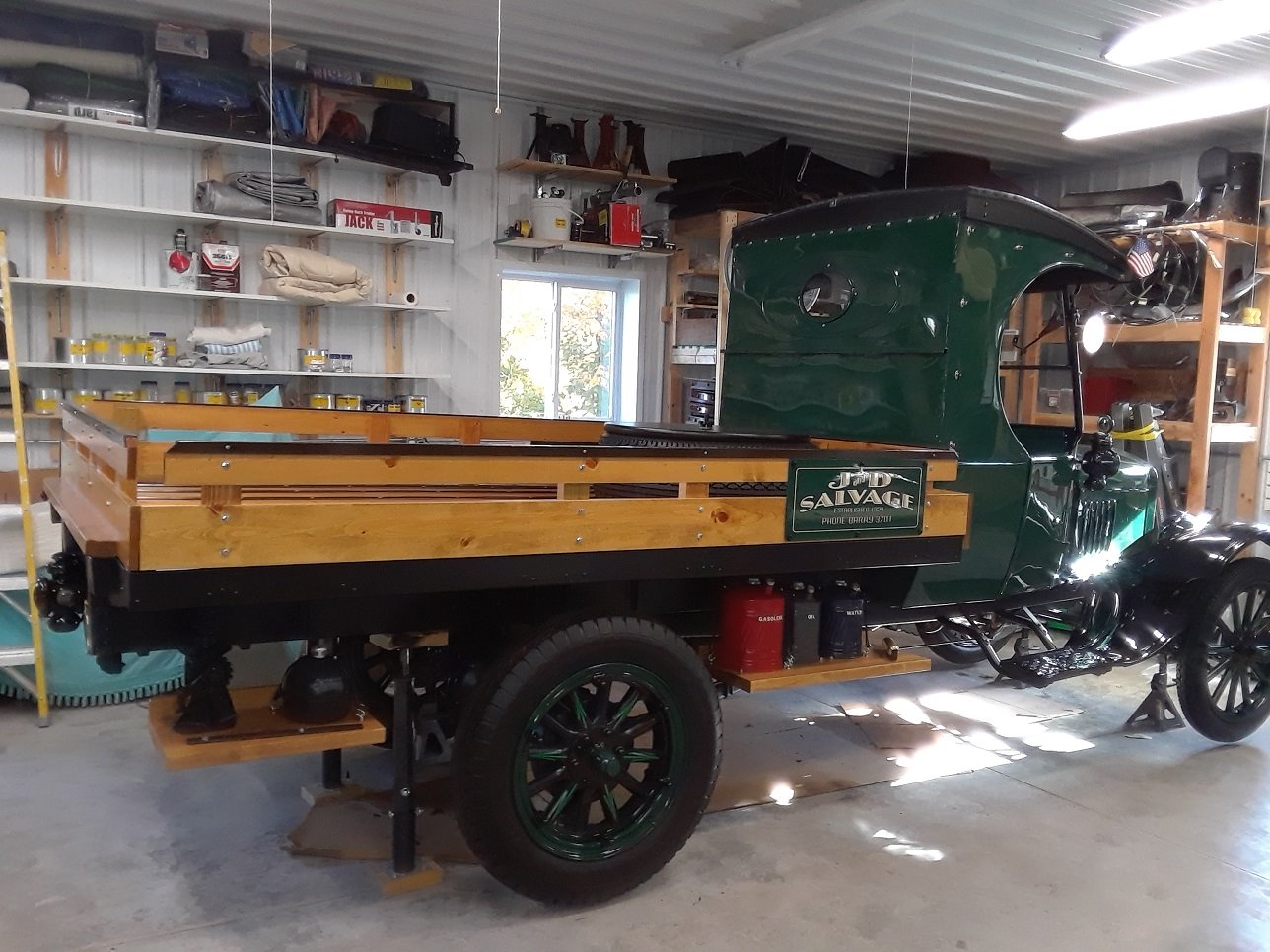

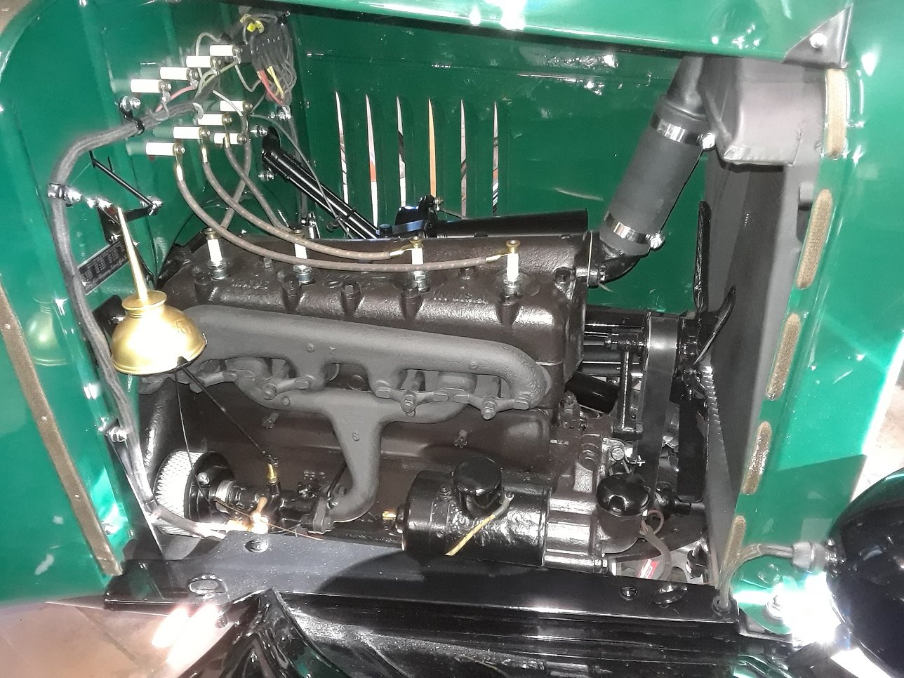

My non Ruckstell '24 TT C Cab would not pick up speed after shifting into high gear. At full throttle in high gear, it would go very much slower than a crawl when compared to a standard high gear speed when the road is flat and even. When there is a slope on the road, with the TT in high gear, it was unable to move forward until a shift to low gear was made. Reverse and low gears have normal and prompt responses.
The previous owner told me that the engine, trans and drive line were rebuilt. I trusted that information and proceeded to completely restore, refurbish and replace all sheet metal and other components as necessary. These were completed a couple of months ago. The weather was good recently and a shakedown run was made and the high speed dilemma was experienced.
I've had T's since 1982 but am not an expert by any means. I have always relied on the advice from other T enthusiasts and from the T manual. I have two TT's with the first having a fully rebuilt engine, transmission and rear end that I contracted to a professional. When comparing the two TT's, their operational characteristics and engine sounds are very similar, almost equal, except for the high gear condition on the second TT.
I suspected that the problem was due to a clutch adjustment. Before I proceeded to tighten the clutch fingers and adjust the low speed connector clevis and lever screw, I thought to post my dilemma into the Forum with the hope of affirming my prognosis and to also garner additional advice.
Attached are pictures of the TT C Cab. Not a complete OEM factory replica but reconstructed to suit my personal choices and preferences. Just having fun.
I appreciate all comments and advice. It is a way for me to learn more.

Nice looking TT Jay. Keep us posted as to what the problem is after checking some of the advise above.

OOOOH Eye Candy!!!! Nice Ride!

It is about Hanks color green. Its a real looker Jay.

LOVELY truck!
