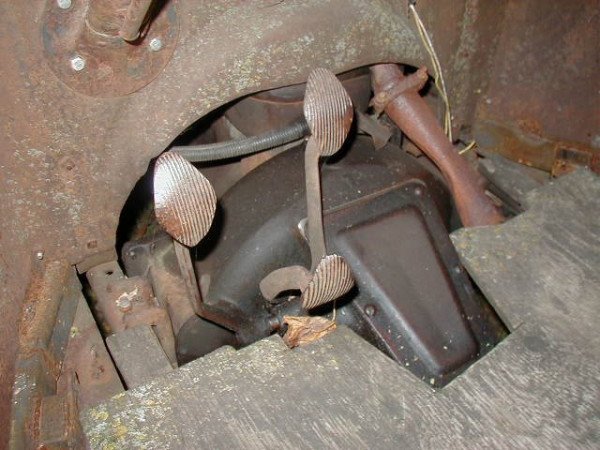

I "borrowed" this photo that was posted by Duane from another thread . It shows the exhaust pipe with a dent to clear the hogshead.
Duanes hogshead.JPG (66.86 KiB) Viewed 6726 times
My pipe does not have a dent but it is really close to the hogshead. It is about 1/4" away and I'm concerned about what the heat would do to the hogshead and oil inside. I don't have much experience with my Runabout yet, having driven it all of 7 miles. Is my concern unwarranted?

worry not.

What Scott said. The photo appears to show a non-original exhaust pipe setup, what with the flange thingy on the manifold end of it, so possibly the heavy dent was necessary because of it. As long as you're not touching the hogshead with the pipe you're good. 1/4" of space is fine.

All T's are made that way. Not a problem.

Most hogsheads have a small spot where the exhaust pipe rubbed its own clearance already... and never seen signs of burnt oil on the inside of a hogshead either.

Not all T's were made that way. On RHD cars, the pipe is well away from the hogshead, as it has to get around the reverse pedal. There is a unique set of bends required to get the pipe past the pedals and clear of the foot starter switch. When doing up the packnut I jam a flat tyre lever between the reverse pedal and the pipe, as the nut tightening tends to screw the pipe towards the pedals.

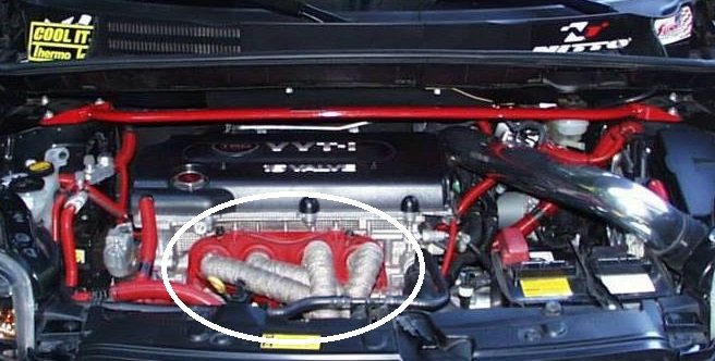

Simple, inexpensive way to go with exhaust wrap. I have this on the header of my daily driver and after, even after an hour of driving I can touch it, something you would never do to a hot exhaust. This company has several alternative methods to a wrap -
Sold in many automotive stores and on-line. I recommend these
https://www.thermotec.com/products/exhaust-insulating
