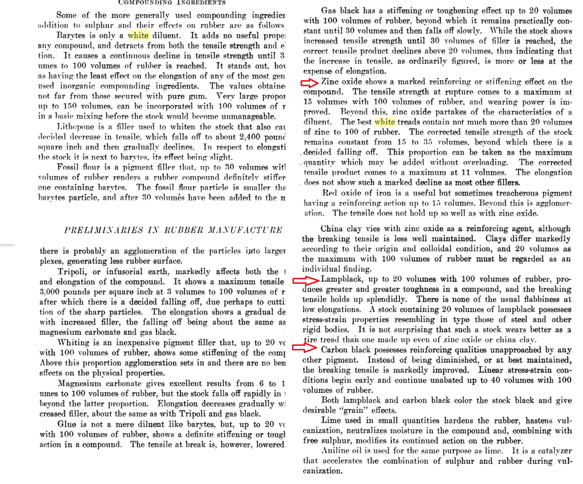

- Posts: 6577
Re: I'm done with white tires
Did some Inter net searching and found a remarkable set of information about tire production in th early days https://books.google.com/books?id=7aI7A ... ll&f=false
I just pulled off info related to color but the article covers production methods etc. And yes adding carbon black made the tires stronger
