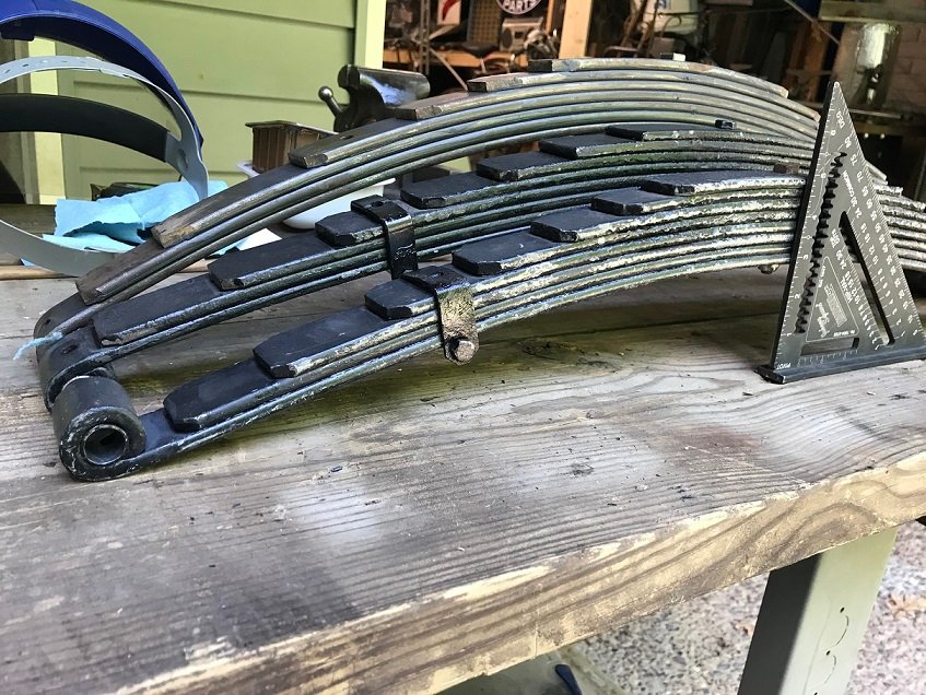

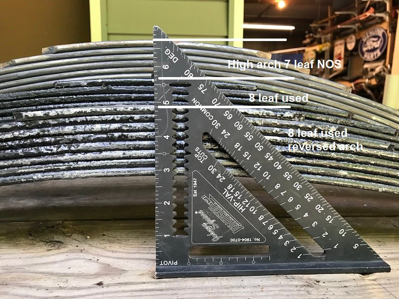

Just happen to be working this out for my speedster -
I re-arched an existing spring myself to a reverse the eye . So in the photo are two used 8 leaf front springs normal and reverse eye. So these two my be a bit lower than when new. The higher spring is 7 leaf (NOS/NORS ?). Lang's indicates that there are 6 (1923-1925 roadster), 7 (high arch 1917-1925) and 8 (1926-1927). according to Land's response 1909 -25 reverse eye - "It can be used on a 1926-1927 spring but it will not give you the full 1" drop, it will only drop the car about 1/2" from what I understand because of the way that the springs are made differently."
So what spring are you working with?

TRD your pictures answered all my questions I have the specs on spring leaf length etc and i now know what the arch should be thanks to all here for your help the spring is a 1927 front spring on a fordor
