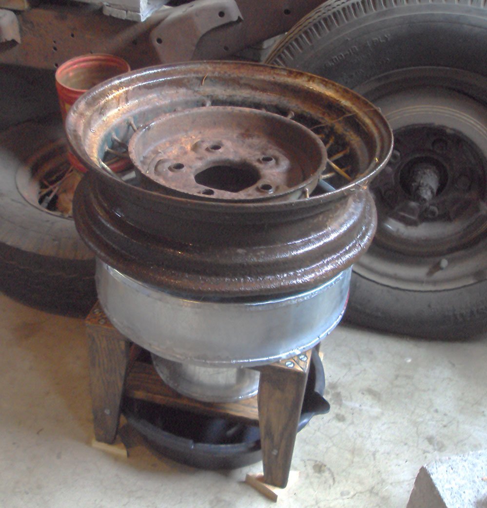

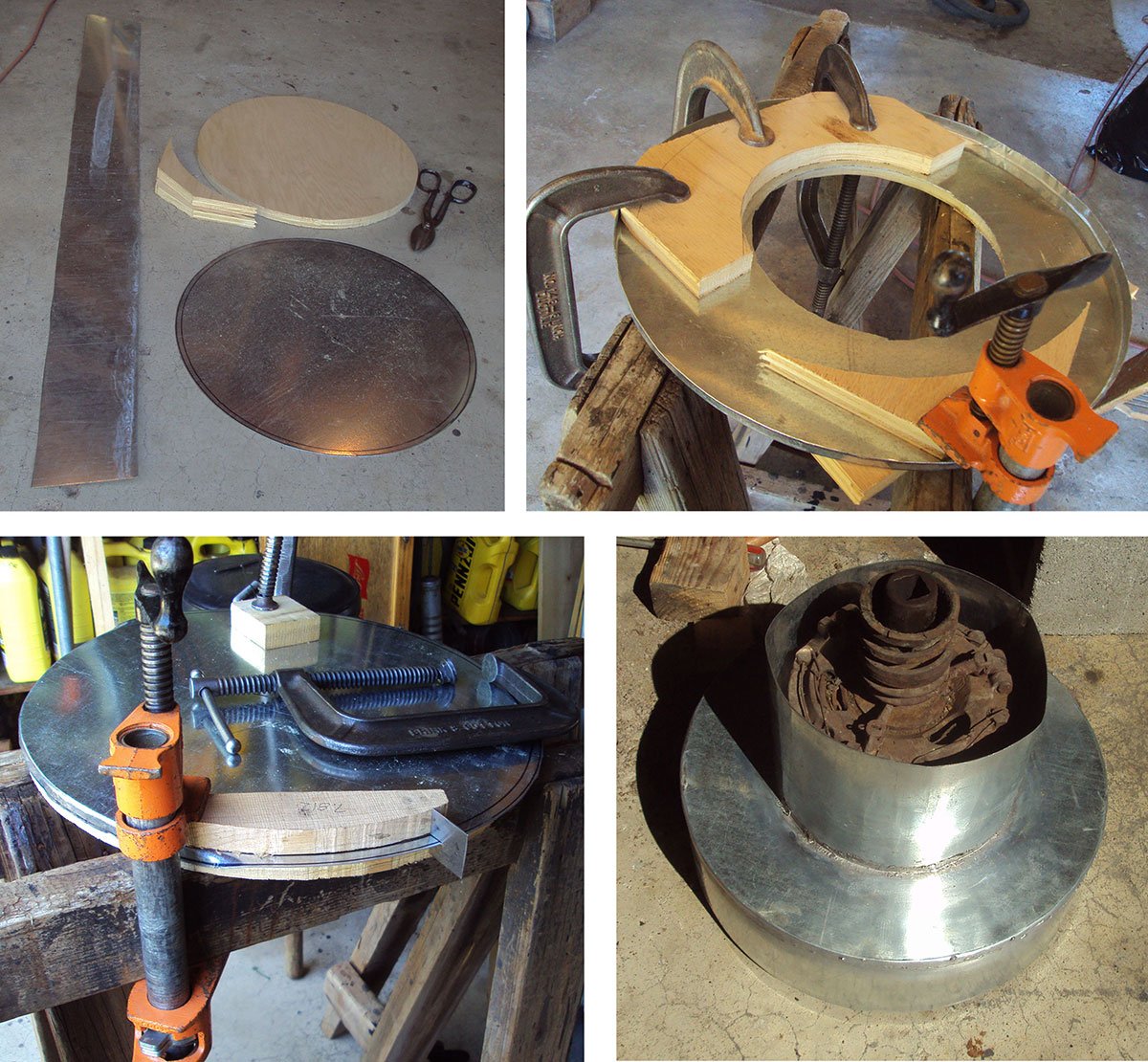

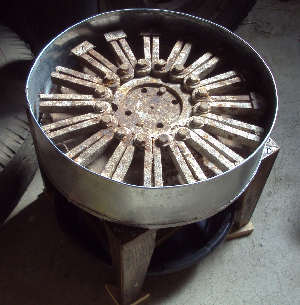

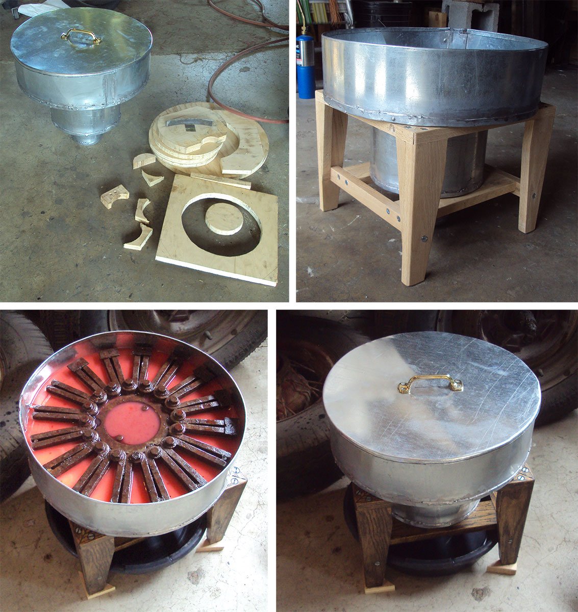

I wanted to save a couple rusty transmissions from the dump. There may be some good parts there if I can get them apart. This week I spent building a pan that fits the profile so not as much penetrant will be needed. In this case I'm using ATF and lacquer thinner.

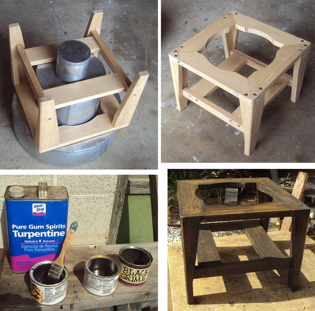

Some leftover 22 Ga. galvanized sheet has been taking up space so I cut out shapes and bent corners for soldering. Some plywood from another project made good forms. It took 4 days to make the pan assembly.
I used water to leak test and only 3 small leaks showed up. I added solder there. The next step was to make a stand for it. I was gifted some oak that also has been taking up space. It worked well using some slotted flat head screws to hold it together. Some old turpentine had turned brown and I mixed it with the dirt, oil and grease I had scraped off my '22 Coupe engine. It was as black as India ink and went on he oak very nicely. It seemed appropriate for this stand which looks a little like a potty chair to me now.
Everything I needed was on hand except the ATF and lacquer thinner. I left clearance for the transmission to slide in. 8 quarts of fluid and it isn't full. With the lid I can let this soak for months until I'm ready to try and break things loose.
It was good to put some stuff I've picked up to good use and kept me out of mischief for a week or so. I might have cleaned the shop otherwise. ;)

What a great project ! Keep us posted Rich, I hope the transmission yields some good parts. That’s a lot of penetrant even with this most economical vessel. I like that you stained the “potty chair” :lol: nice touch !

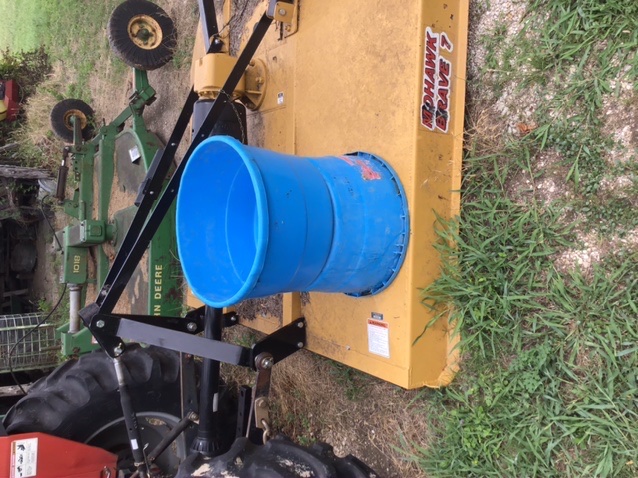

Here is what I use to clean or soak up old parts and these cattle supplement tubs work just right for T transmissions. They are a little over 5 gal. And work just right.
Sorry abt the pic angle! I use mineral spirits and diesel. Works pretty good.

Rich, you mentioned bovalix tubs. Is that the material they are made of or a product tub name? Just curious. Depending how badly rusted they are but having patience seems to be part of the process. I use what I have and that’s diesel. Wal Mart has a decent price for mineral spirits so that’s what I use with it. Kerosene has gotten to high to use. Use to be cheaper than diesel years ago but not anymore!

Full disclosure: On checking the soaker today I noticed and additional item was needed to keep the lid fitting tight to the pan. By not using two complete wooden disks the lid did not stay flat/straight/whatever. This addition makes a better fit.

John, Bovalix is the brand of supplement block I’m familiar with. The tubs are useful but not “bullet proof” :lol:

Rich your right about the tubs not being bullet proof. If they are under a shed and out of the hot sunlight they will last and keep from cracking but long term sun exposure is a killer for them.
I had several I pitched out a while back that the sun did a number on them!

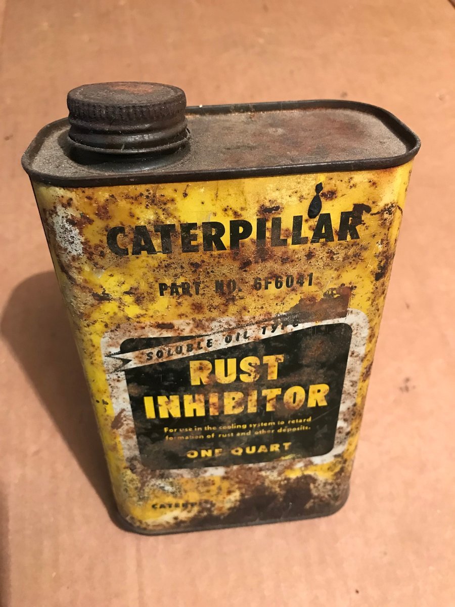

Found this at a garage sale.
The description "Rust Inhibitor" may be somewhat ironic, considering the condition of the can?! Nate
Re: My transmission soaker
Post by Rich Eagle » Tue Jun 30, 2020 12:09 pm
Thanks for the chuckle Nathan. Those things really amuse me.

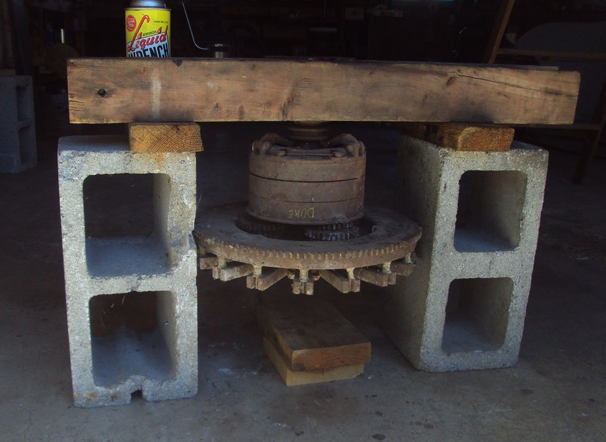

The transmission I am currently soaking had the ball cap stuck on the drive plate shaft. I suspended the cap from 2x4s hoping the weight of the transmission assembly would pull it loose. I applied penetrating oil for days and nothing happened. Finally I put a bar in the square hole and beat the heck out of it. It came off but had really been stuck.
Now that I think about it I could have still used the soaker pan for that. It just wouldn't have fit all the way in.
It was fun anticipating the trans crashing down on the boards.

Rich - perhaps just a bit more "shoring" would have been justified ?
Post by Rich Eagle » Tue Jun 30, 2020 3:21 pm
I thought about adding a c-clamp but it stayed pretty stable even with the pounding.

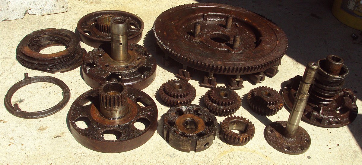

After 27 days I had occasion to lift the trans and try the magnet bolts. All turned without breaking. I followed that by disassembling the whole unit. As rusty this one looked on the outside there was a lot of black oil covering the insides. Shiny surfaces meet surface rust and then pitted metal. Most of the gear teeth are badly rusted. I am toying with the idea of seeing how well rusty gears would work but don't have a car for that right now.
