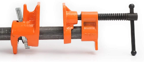

- Posts: 6592
Re: Need to straighten the headlight on a 24 coupe
I have used a pipe clamp & vise to straighten things out. Leaves no marks and a long bar gives you plenty of leverage to move things as much or as little as you go.
- Attachments
- pipe clamp.png (140.39 KiB) Viewed 2557 times
