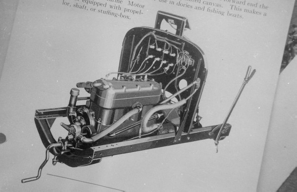

Post by Luxford » Thu Jul 02, 2020 7:43 pm
mario,
here is a photo of the Ford Canada motor, should have added it to the previous comment

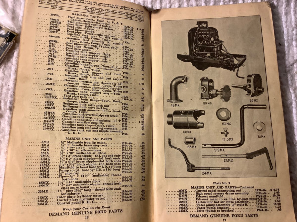

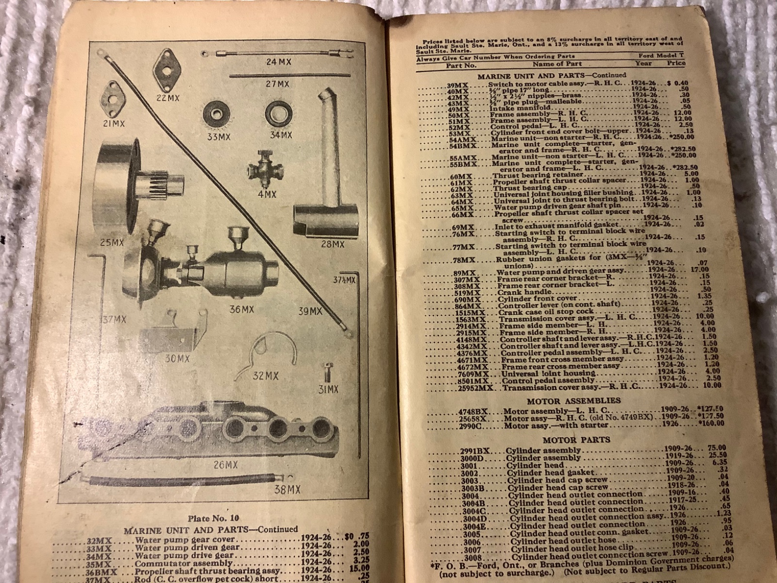

Post by Dropacent » Fri Jul 03, 2020 6:59 pm
I’m missing the cover page but I believe this is the Canadian Ford catalog. Someone mentioned Roberts, that was in Sandusky Ohio. Right at the lakeshore. They made a lot of marine motors, mostly stand alone, but also a model T conversion.
