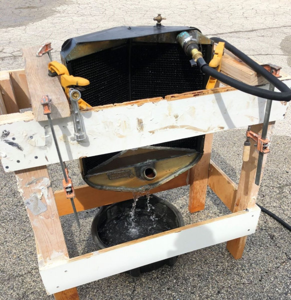

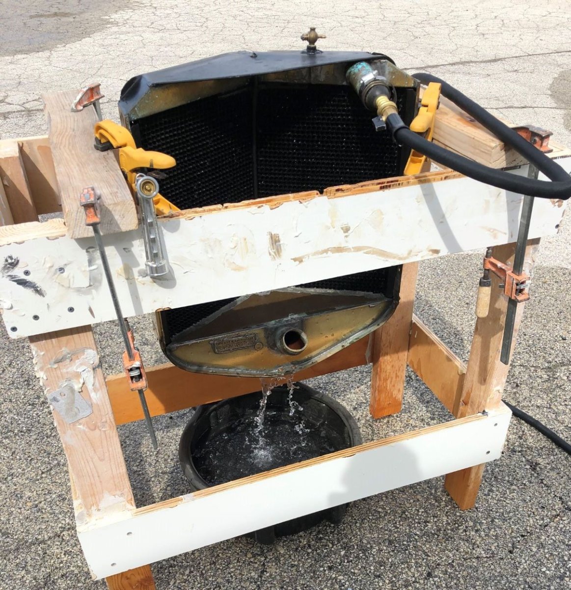

I prefer to remove the radiator and lay it on its front after sealing the filler with a plastic bag and a strong rubber band. Pour enough vinegar in to fill the core and leave for a day. Re collect the vinegar and flush the radiator with the garden hose and reinstall!!
I strongly prefer to keep the vinegar away from the block and core plugs and gaskets!!

I second Les' post. This is how I treat radiators and when possible, keep pretty much everything out of the block other than cooland and distilled water. It's remarkably effective, and you don't need 30% vinager from hardware stores, in fact that concentration brings its own set of cautions and headaches. Off the shelf in grocery store is just fine.
As an aside, more concentrated acid does not necessarily "disolve things" faster. Sometimes it is a weaker solution that is more agressive...just depends on what the acid is being used for.

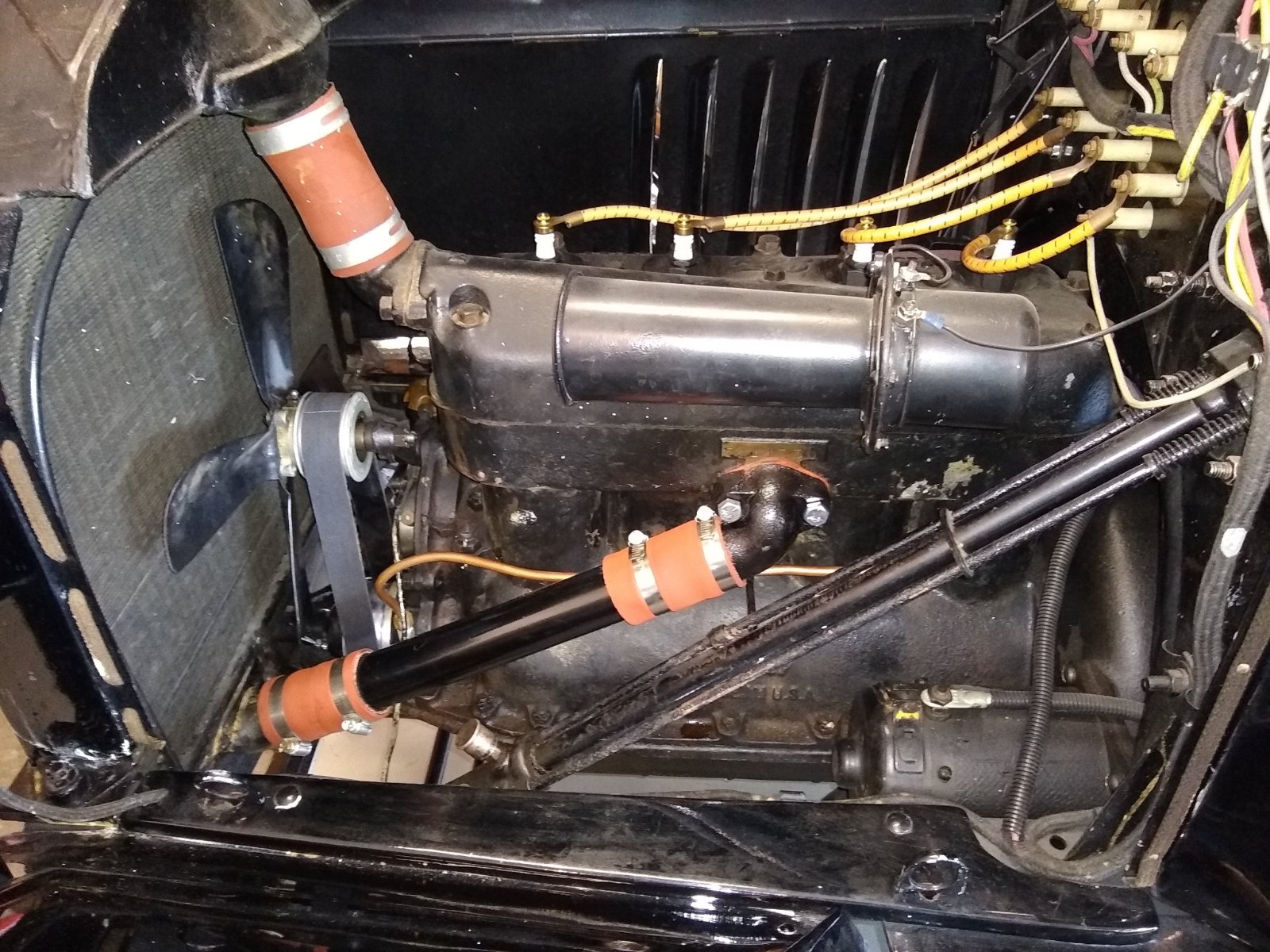

I like it when original posters provide an update to their original question, so here's mine. I used a gallon vinegar mixed with water and let it soak over night. I then poured enough water through the system until it came out pretty clear. There didn't seem to be that much crud, thankfully. Yesterday I got the new inlet port, gasket, correct length coolant tube and hoses that allowed me to finish the job.
After filling with coolant, I took it for a spin when it was 90 degrees, which included a couple a couple of slowdown or stops at intersections. I had run it earlier to check for leaks, so the coolant was initially above ambient, but below the bottom of the thermometer gauge. I did notice that the temperature registered earlier on the gauge than when driving under similar conditions with the Berg water pump installed. That makes sense, given that the water pump starts circulating the coolant from the moment it starts, whereas I believe that the thermo siphon system circulates the water slower initially. The coolant temp did not get up summer average while driving, and it was steady or would decline during the longer straightaways. I don't think the temperatures are any higher than when I drove the car with the pump; the coolant temp just gets up and stabilizes quicker without it.
Working on a T is sort of like working on an old house. You never know what you will find. My "surprise" on this job was that someone had removed the petcock on the bottom of the radiator and replaced it with a short 5/16 or 3/8 fine thread bolt... It couldn't have been the original restorer, as he seemed to do a proper job everywhere else and doubt that he would have done something so stupid. I chased the threads with a 1/8 pipe tap and installed a brass pipe plug, but it is still dripping a bit...
