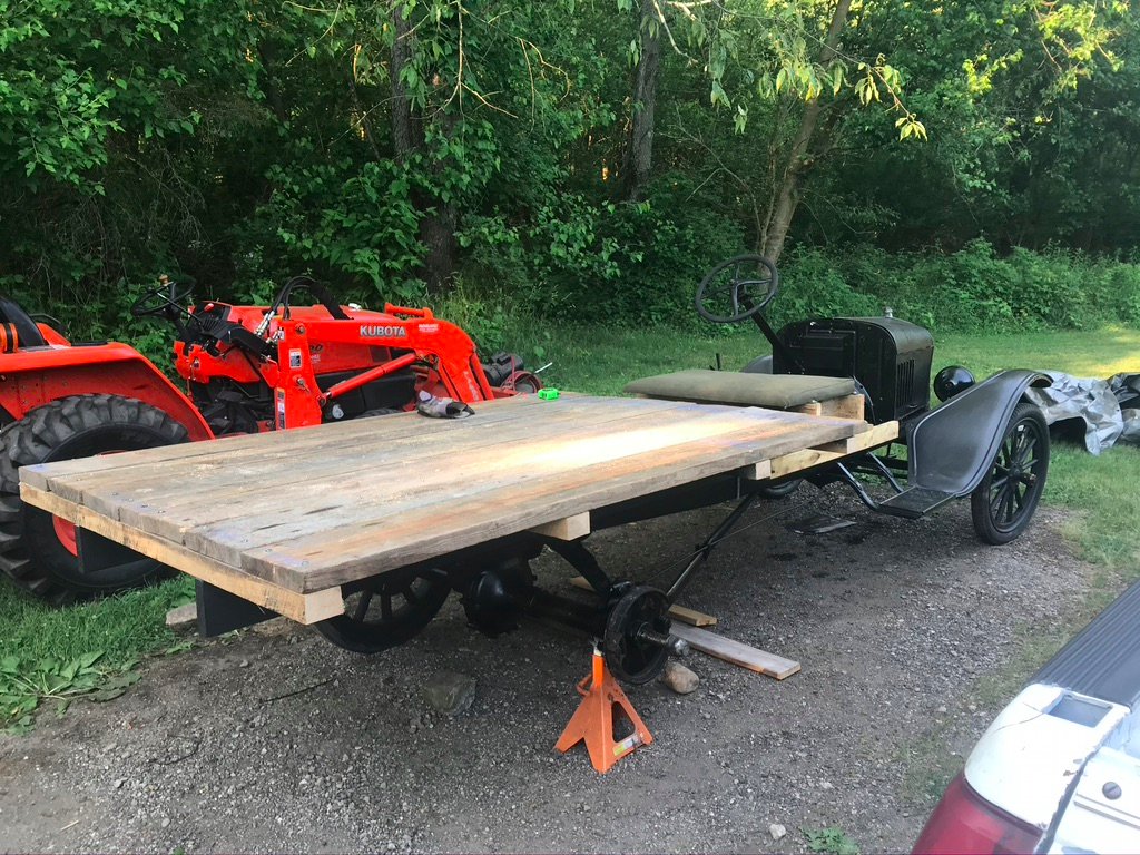

I'm still waiting for the Amish Wheel guy to get my wheel finished. It's taken longer than expected.

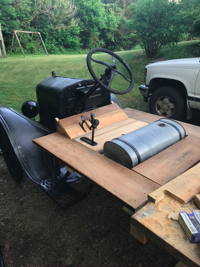

I got the bed put on and I'm going to round up some stake pockets and make a stake bed.

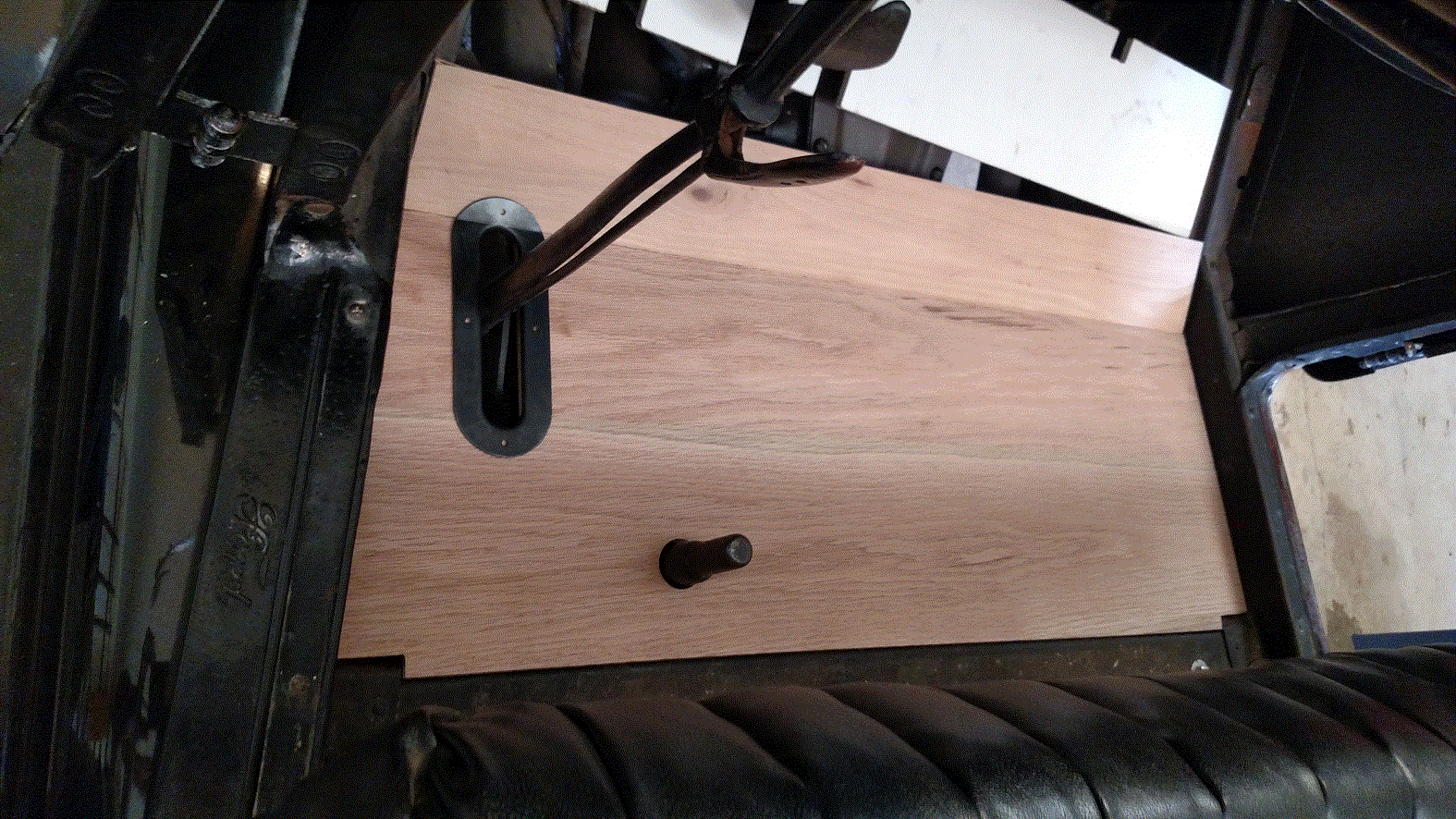

I got the floor boards put in. I'm going have to change the angle of the front floor board to get a little more pedal extension.

a word of caution: ensure that the slope of the floorboard is not so steep as to limit the natural full travel of low pedal and brake (and reverse), and that the slots in the floor board will not limit same. IE, if pedals hit floorboard necessitating tightening the bands too much to activate in a short throw, then the bands may drag and at best will make crank starting harder and at worst will cause overheating and potential drum/transmission damage.
Good luck!

Ya, I'm going to have to modify / change the angle of the front floor board to get a little more pedal extension.
Those are sold rear tires and the felloe was loose on one of the rims. The wheel guy thought that the felloe rotted on the bottom part of the wheel where it was parked for a number of years. He was going to make new / steam bend up an new felloe for me. Said he broke off a spoke tenon or two in the process.

Scott, its looking good. I see you have extra room built in the cab behind the tank for your long legs. Good idea. Mine is not made for tall people. Steeringwheel to back of cab is not great. My belly is not huge but putting a backrest in my cab will be a challenge not to be up against the wheel. Getting the floorboard around the peddles is a challenge with no pattern. Been there, redone that.

Scott, when I made new floorboards for my '26 Runabout I measured the angle of the floorboard supports in the body. It measured exactly 30 degrees. I don't know for certain but I suspect that TT floorboards would have the same angle since pedal geometry is the same.

Initially, I wasn't sure of the angle as as I eyeballed it and found that it was too much. Now that I'm inside and after doing a little math / trigonometry I found I had 7" of rise and 10" of run which gave me a 35 degree angle (too much). Next go round 'm shooting for 6" of rise and 10" of run, which would give me 30 degrees. Too funny...Mark Nunn wrote: ↑Tue Jun 30, 2020 8:26 amScott, when I made new floorboards for my '26 Runabout I measured the angle of the floorboard supports in the body. It measured exactly 30 degrees. I don't know for certain but I suspect that TT floorboards would have the same angle since pedal geometry is the same.

30 degrees and a 10" run has a rise of close to 5 3/4".
