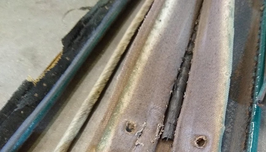

I've been working on the interior on my 27 coupe, and noticed that it has weatherstrip, of sorts, at the front of the door, and above the door. These are both welt, as I understand what welt is. The vertical piece (the one that's opened, as well as the one to the right of it that's still closed) might be Naugahyde, wrapped around a rubber rod. The horizontal piece (on the left in my picture) might be Fabrikoid, wrapped around a paper cord.

The window channels you can buy in long lengths or ready cut to length for your car. Snyder’s and Lang’s carry it I believe. I bought the long lengths for my 24 Coupe and cut to fit. It’s pretty close to the original size and look.
Don’t know for sure but Model A felt window channel may be close to the same for the metal frame T doors like yours. It was sold like that because it was the only avaliable channel at the time. Maybe be different now and more types may be avaliable.
The rest of the door trim may not be exact either. It wasn’t when I was working on my 24 Coupe. I bought and used what was avaliable at the time.
