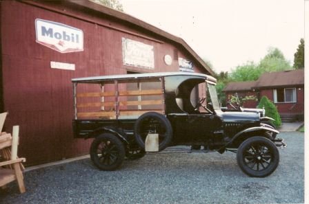

I'm the caretaker of a "family owned since new" Dec. '23 (1924 model) TT C-Cab Express - it has the shorter running boards.

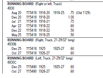

It looks like they appear in the parts book starting Dec. 1925. So maybe a mid-year '25 change (?) There were some changed made mid-25 when the close cab came out, so maybe early 25 (?) I'm not sure how much lag there is between a part showing up on a car and it appearing in the parts book

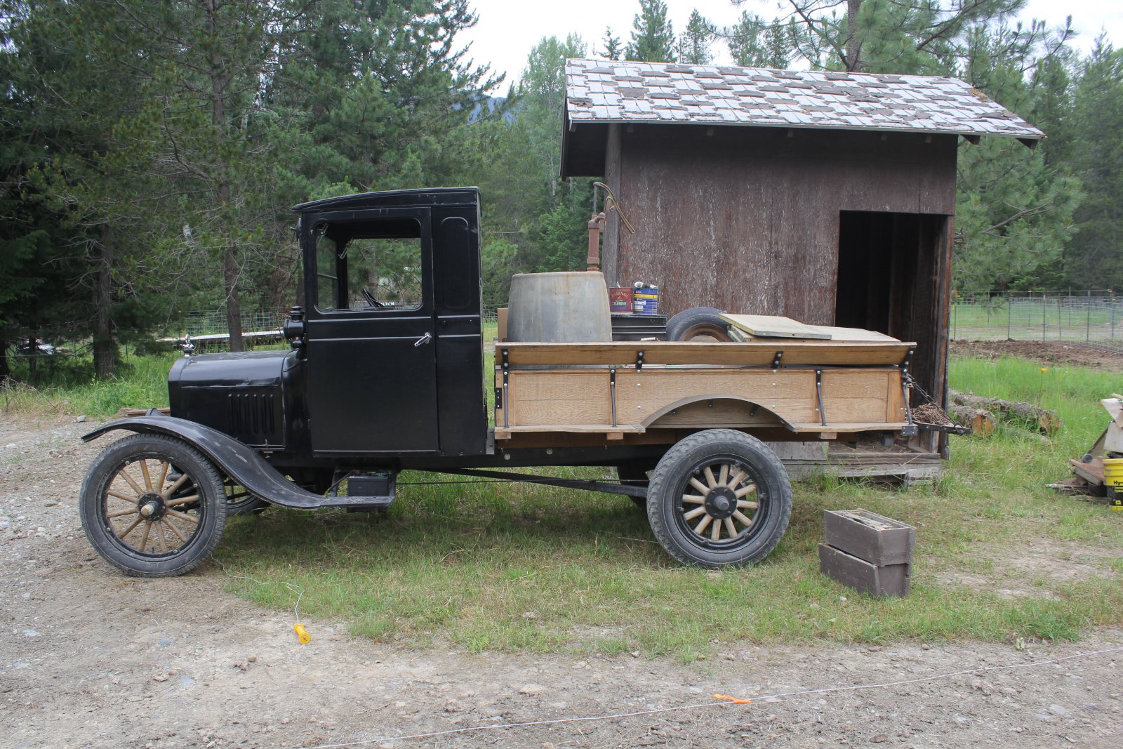

What running board is this on m y '25? I'm not up on the different types.

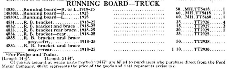

The Aug. 1925 Parts Books lists the short boards, L and R.

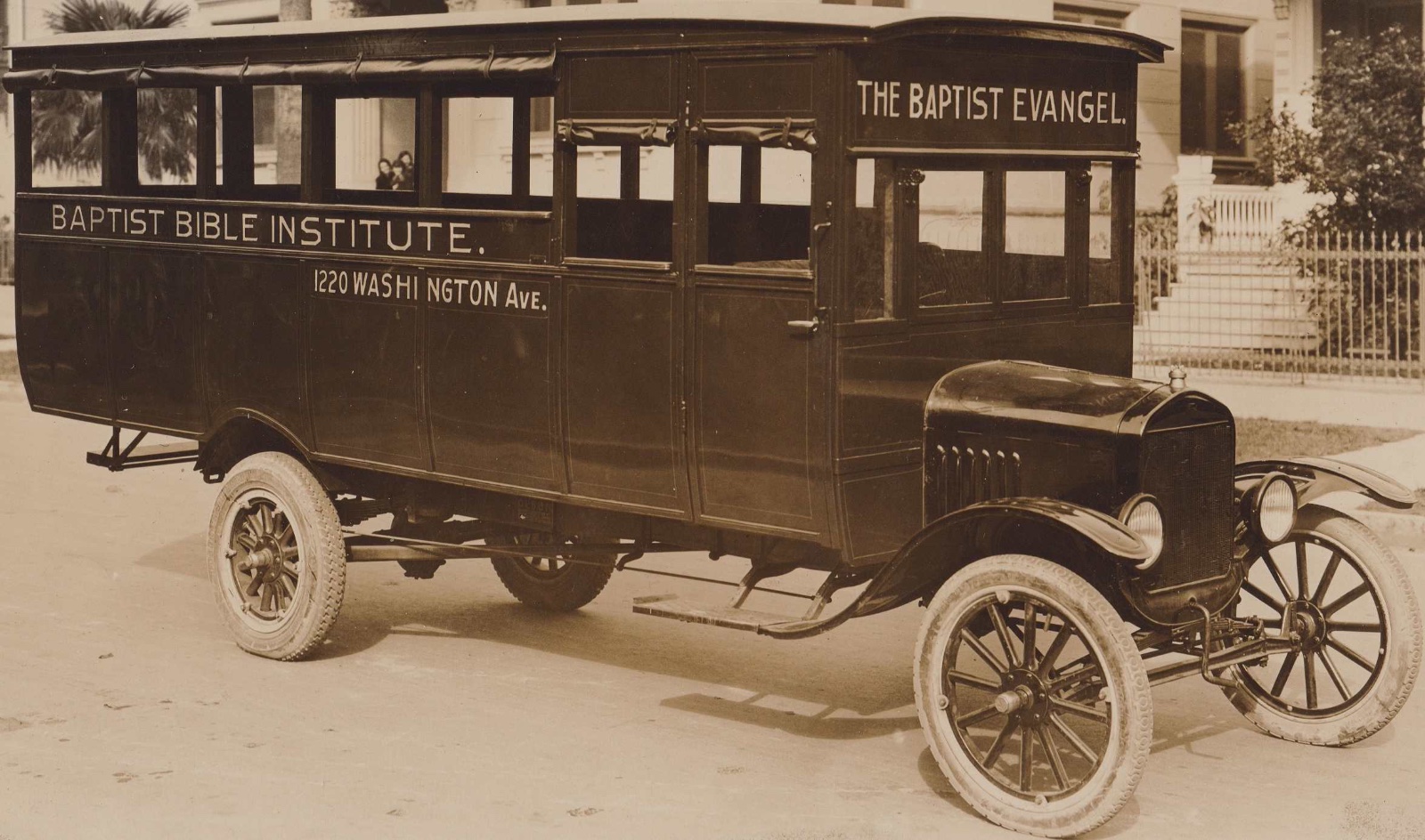

And this nice photo shows good view of the short board with boot scraper upset end flare.

Not correct there, Dan - short boards were interchangeable - it lists 1925 L. & R. which is the "new" style.

Us folks with TT's refer to those as the long boot scraper boards.

Your truck is sporting the short boards, Pat.

So it looks like what I'm getting is that the long boards first appeared in the August '25 parts book and started appearing on the trucks at that time or very shortly thereafter. That syncs with the '25's I'm seeing being about half and half (unscientific and small sample size)
