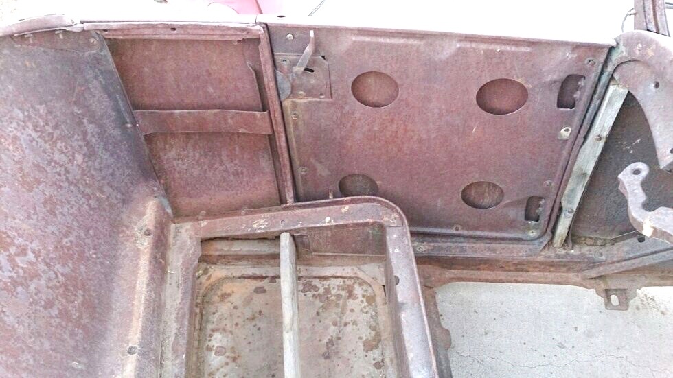

I've got a question. What do you drive the tacks into? There is no wood in the door. Mine looks like there are fasteners in holes with no panel installed. Do the tacks get pushed into the holes of the metal frame?

If those are the original or repro's of the originals, they are spring loaded snap fasteners. There is a small hole in the center and the tack gets driven into that hole. I didn't take any pictures when I did mine, so I am sorry that I have none to post.

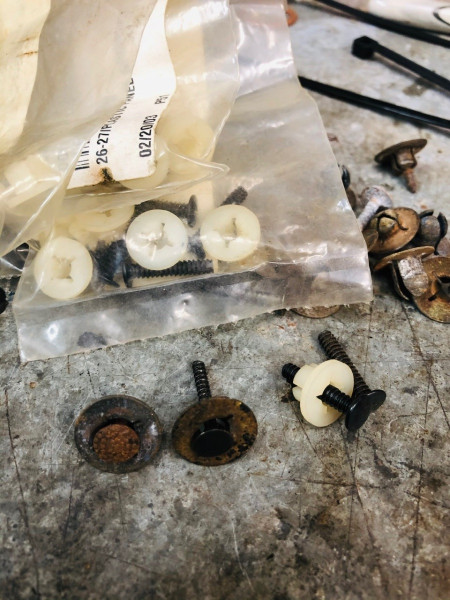

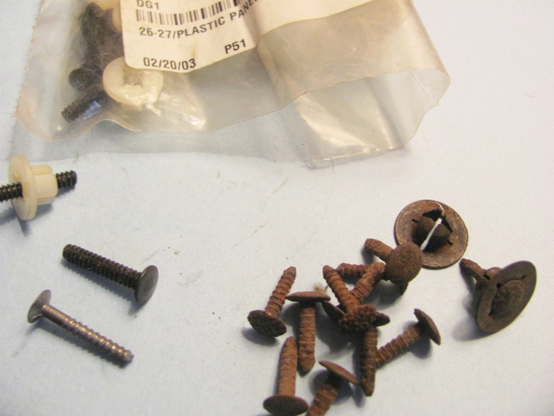

These are the ringed nails, with a large painted head. They drive into the sockets placed in the door metal panel holes that are there for the sockets. Repros come with plastic sockets, but they are thick and stand up a bit, you can sand them down. Or use the original metal sockets if in good condition.

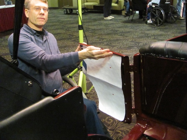

Note where the sockets are, after you fit the door panel, you can use chalk marks on the panel and door edge if you can't remember where the sockets are :)

Professionals use a paper template and mark the socket holes and transfer the template to the face of the new panel.

You know, I could probably use my old cardboard panels as templates. I'll have to look at my tacks again, I remember them as more spiraled than ringed. Got my set in awhile back and haven't looked in a long time. Old cardboard ones installed with upholstery Phillips screws and washers.

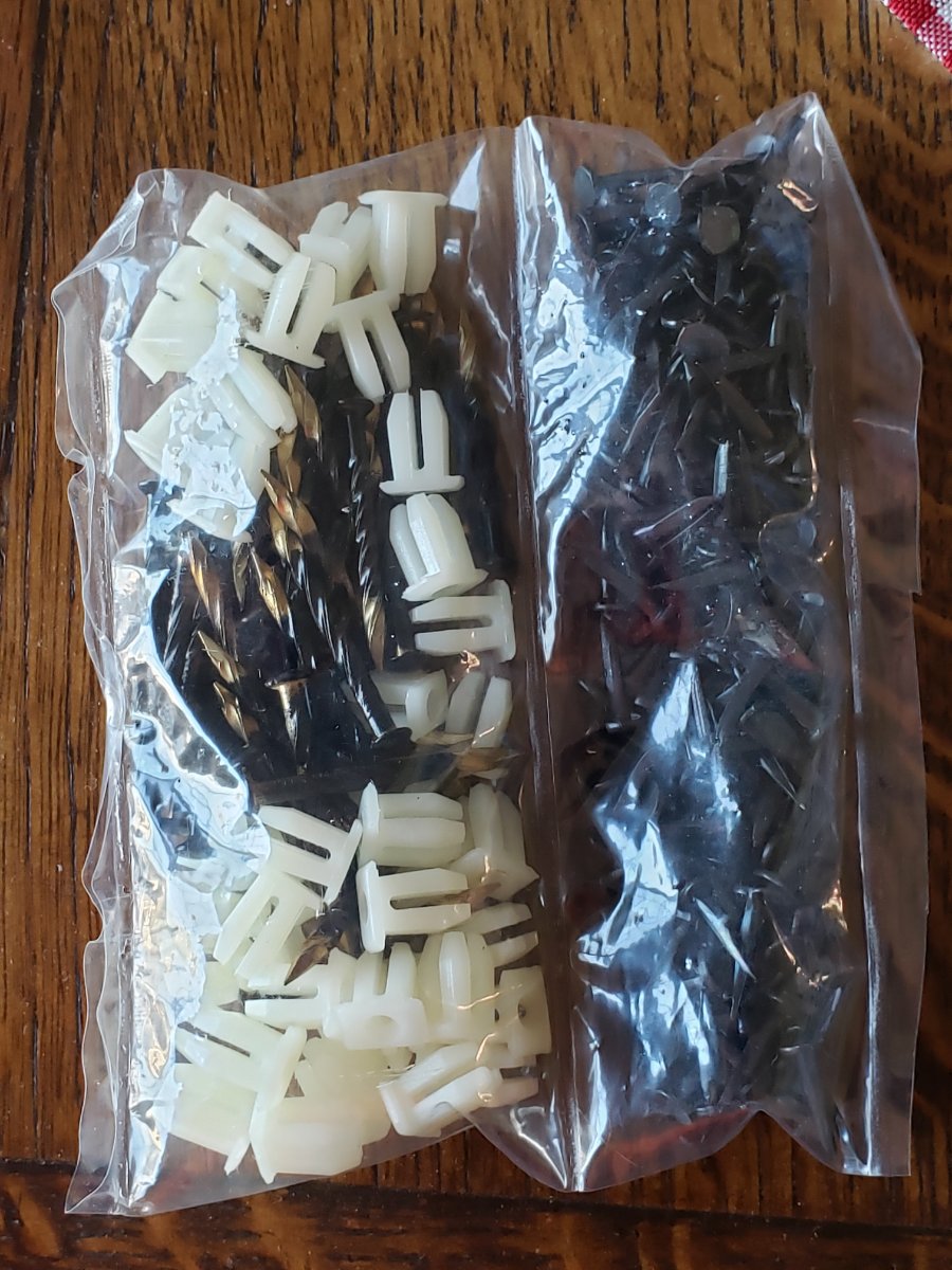

This is the pack of tacks I received from Classtique. They look different than the ones shown. These spiral tacks will work, right? I also read somewhere that the Model A spring clips are a better way to go. Are these the ones that would work? https://www.mikes-afordable.com/product/A46126A.html Pretty pricey but if they work, might be worth it. Looks like the Model A spring clips would work like those on my 68 Cougar. Not sure the diameter of the holes in the doors are small enough to hold.
Thoughts?

The 26-27 open car doors have holes around the perimeter of the inner door panel a strategic places. The sockets (metal original or plastic replacements) are pushed and driven into those holes and are retained by the design of the sockets.
Then the upholstery nail with large head is driven into the cardboard door panel, and into the socket, the rings on the nail shank retain the nail into the socket, and hold the door cardboard to the metal door.
Note the holes with sockets inserted, and some of the sockets still have the large headed nails, as the cardboard panel has weathered away.
The other cardboard pieces, like hip padded panels are held similar, and kick panels are too, held by either metal channels formed to secure the edge, or with same nails driven into the wood framing around the metal structure at certain pieces, to secure the cardboards.

Will the spiral nails in my prior post work? Heads seem pretty small diameter. It looks like Snyder's has the ringed nails. Do they work better than the spiral nails or do they both work about the same?

Those ring or spiral nails only need to grip the socket flanges. You should stick with plastic kit as they are matched to work. Haven’t seen that brand but should work
Do know the factory metal are thin and made for Ford holes. The Ford ringed dome head nail has .300” dia. head, the other brand in my photo is .280” dia. and are metal done like head , smooth finish nails, they also work in Ford original metal sockets. The Ford has a pebble pattern head as the original were pebble grain.
Have some extra pkg. of them.
