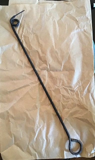

I just brought home a 25 Touring last night and the previous owner sent it with everything that was already under the back seat. Among the goodies were a wheel tool, spark plug wrench, band nut wrench, a petcock tool and this interesting piece. It has 11 file marks up the length, so I’m assuming it is gas tank related. Am I also guessing the curly q at the end is to turn the shutoff lever and the narrow point to clear sediment from the bottom petcock?

If I can remember to take a picture of it I will send one of the one I have. Similar with the fuel marks but lacking the point to clear the petcocks.

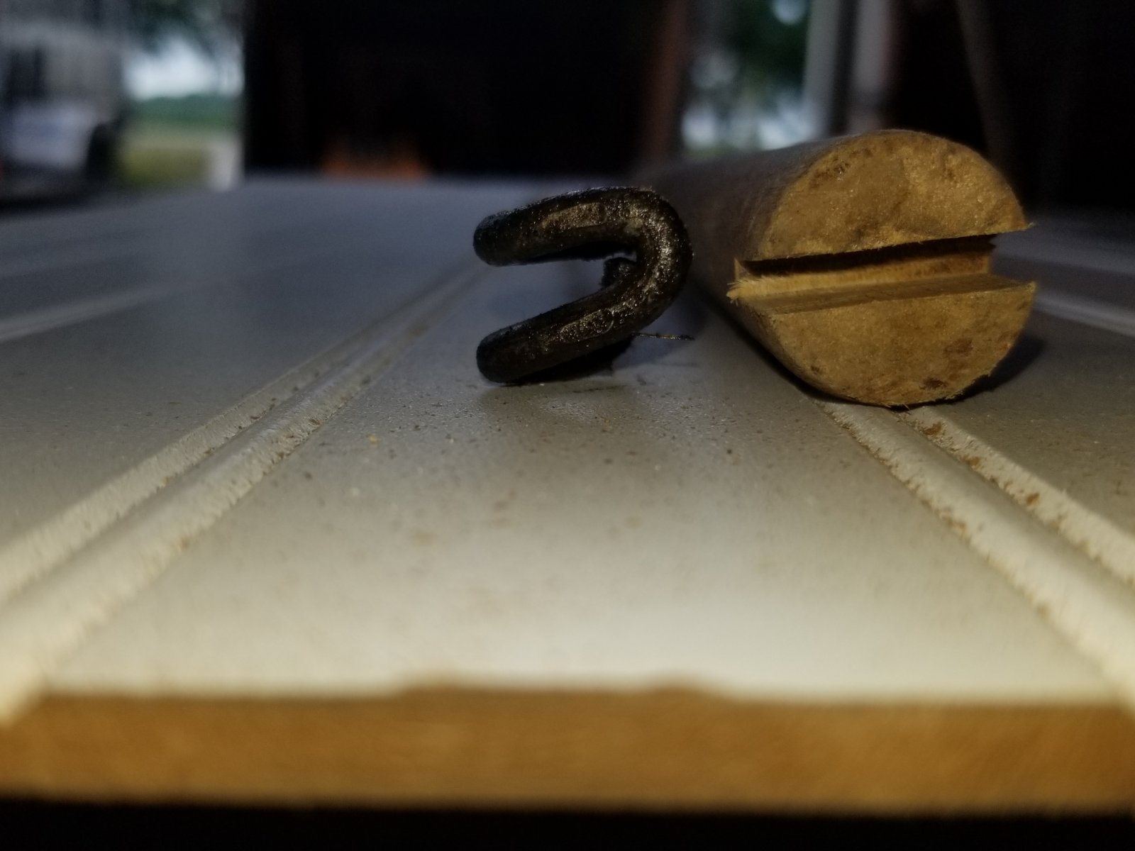

Mine has a wooden handle with the ever-fading name and 3 digit phone number of a gas station that I assume gave them away. The metal shaft is notched to mark gallons in the fuel tank. On the end is a deep notch/groove that fits over the petcocks to allow you to check the oil without having to crawl under the car.
I suppose these were pretty common but its always cool to have one of the old ones. Having one adds a lot to the car...shows more of the history.
Very cool.

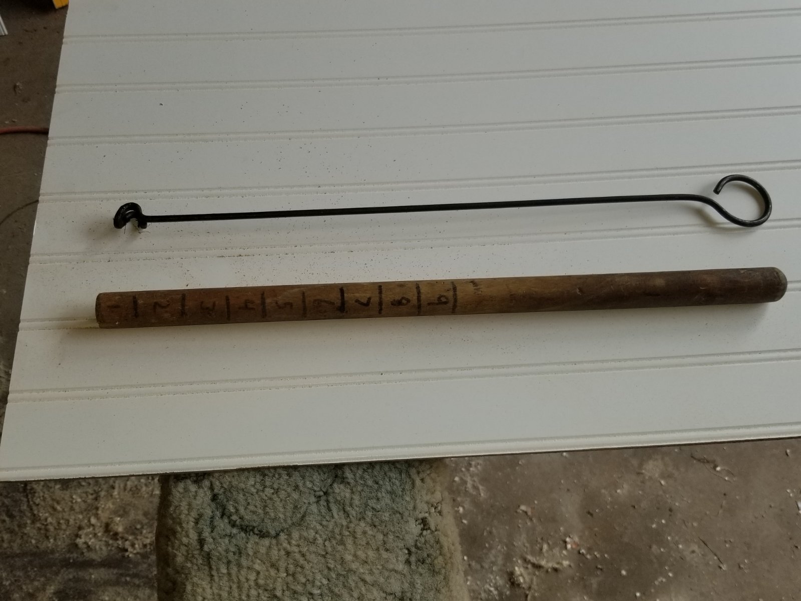

Thats pretty cool. Even clears the hole. I have an old one but I made one that checks fuel and oil. Just an old push broon handle but after another thread I modified it to turn the petcock. I filled the tank one gallon at a time and marked it with permanent marker. Its only accurate on my 26 pickup.

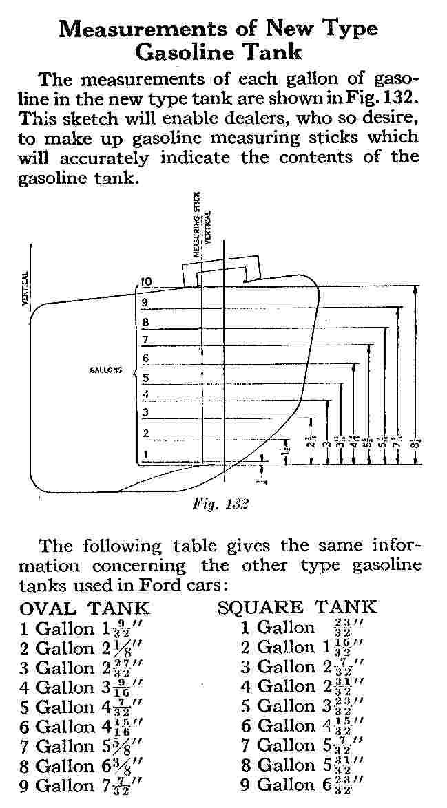

Me Landers, could you send me a pic of your dip stick next to a ruler please? I have a 26 touring the measurements might work for.

There is a drawing of the '26-'27 gas tank fuel level at the bottom of this thread. That should help you make a gauge.
