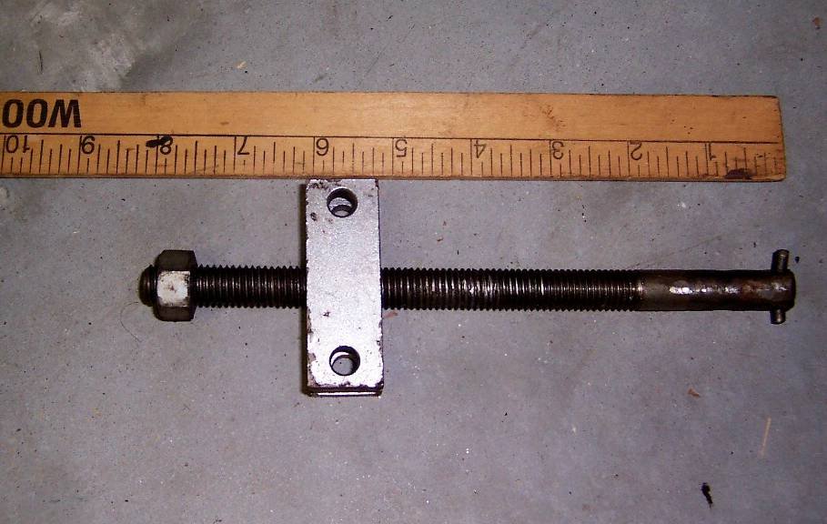

it takes a threaded T rod to relieve the spring pressure. I would suggest you order a copy of the original Hassler instructions from one of the T parts vendors. Once you see how to do it, you can make the necessary tool.

One DIY tool is needed or purchase https://www.modeltford.com/item/HAS-T.aspx.

Thanks guys I ended using a bolt, three washers, and a nut to build the tool. The spring came off like a charm and have now finished cleaning up the rear axle spring and all the hassled parts.
