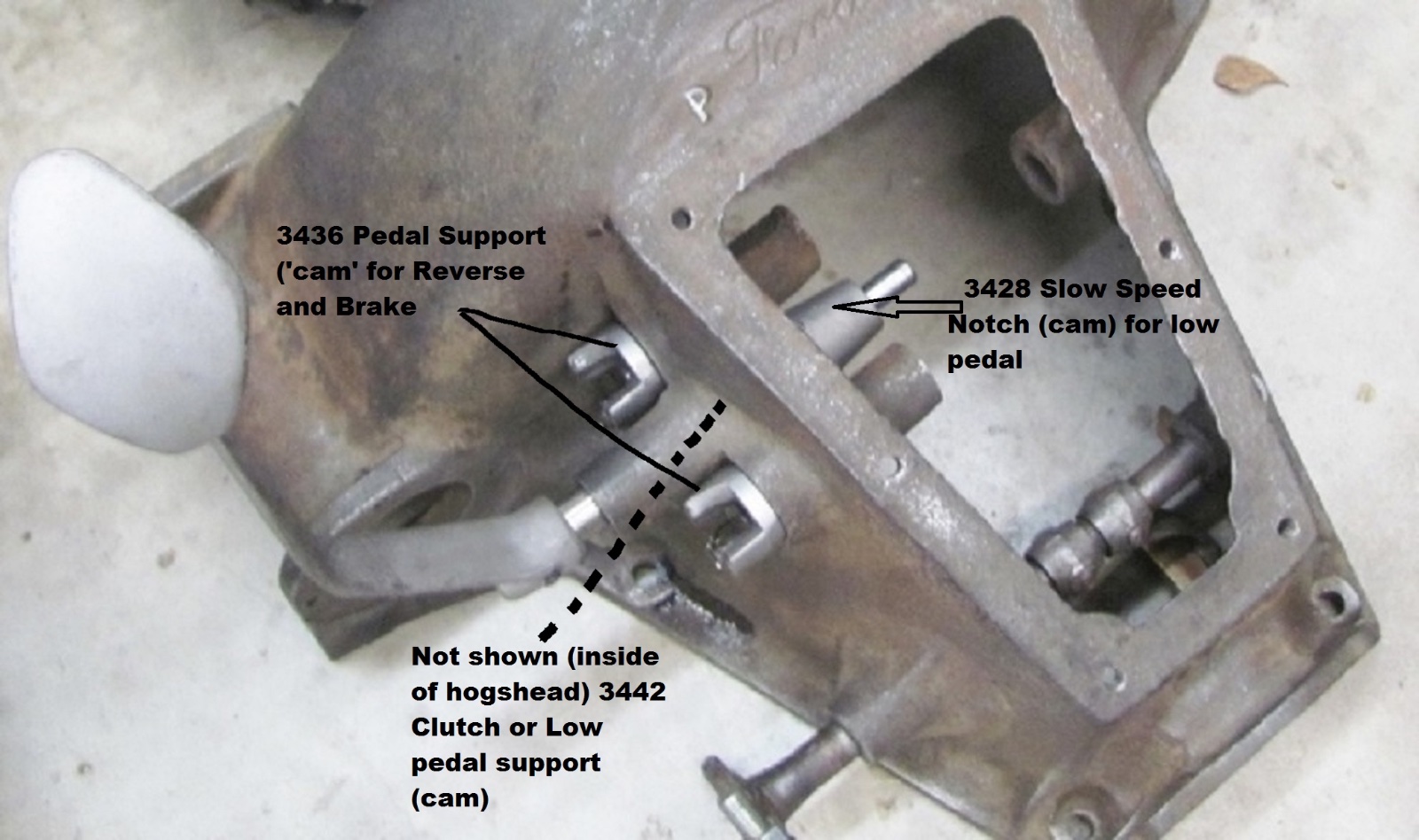

Is the cam for the low speed pedal worn? Was it ever replaced? If not, that's what it might be. If that is the problem you can compensate for the wear by placing washers behind the band ears. Not the best solution but it is a temporary fix until you can pull the hogs head and replace the cam.
- Posts: 4694
Re: 1926 Ford Model T Transmission Bands
Do not drive the car until this is corrected. It could lead to drum breaking.
I agree with Fender. I think the problem is the Cam and Notch. Best fix would be to remove the transmission cover(hogs head) and remove the pin holding on the notch. Then remove the bolt holding the cam. Be very careful not to drop anything into the transmission. While you have the hogs head off, carefully rotate the engine and transmission examining the drums for cracks. Especially the low drum. If it is cracked, you will need to replace the drum.
Replace both the cam and notch and then when you have everything together, you should be able to move the pedal down about one inch from high gear to neutral. Then as you move the pedal farther down it will begin to move the shaft toward the right and clamp the band tightly around the drum. Adjust so that the band is completely tight when the pedal is one and one half inch above the floor.

Here are a couple of threads that deal with the slow speed notch or pedal cam with pictures.
http://www.mtfca.com/discus/messages/70 ... 1489083840
http://www.mtfca.com/discus/messages/70 ... 1502138019
A worn under size drum will cause the same issue. Temporary fix with the washers as noted above or shim under the band.

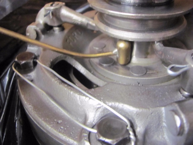

Hey guys
I discovered the following
on the service flap, I have found that when I press the left pedal move two levers, picture hangs
on the right lever is missing a kind slotted sleeve which is secured with a splint, as can still be seen on the left. However, the left is also a bit lame
What are the levers for?
And maybe that's my problem why my first step does not work right
because ribbons are new
drumming good
What do you think is broken? Maybe something with the clutch?
greetz patrick

On your first photo, the adj. screw for low pedal appears to really be about fully turned in, so the low band must be a bit too tight, with new linings.
Can't know why that screw now all the way in, as with new thick linings like the Kevlar, there should be more adj travel and screw should be sticking out more.
On the clutch fingers, that missing piece is a cotter pin, keeps the position of the adj. set screw, and it should be in place to maintain the set screw depth. You may find that old cotter pieces broken in the oil sump, when you drain the oil, good way to fish it out. Replace with a new cotter.
Your photos show the fingers are relaxed, (normal) as the hand lever is vertical, that is 'neutral', Or pressing on that left pedal (low) does the same, releases the clutch fingers so that the clutch disc separate and that is 'neutral'. Only when the hand lever is thrown forward, and the low pedal is no longer depressed, do those clutch fingers push on the clutch disc pack, that makes the T go into 'high' or direct gear.
Clutch engaged, as this assembly has no hand lever or low pedal to pull back on the clutch spring, that has tension on the 3 fingers, Note the cotter pins, in the slots of the small set screw in the clutch finger, that screw puts force to the stub below that is the clutch push plate.
These are the 'cams' that activate the pedals.

On a 1926 transmission, the rear band (the brake) is supposed to be wider. Your Kevlar material is wide, but your band is narrow, like low and reverse. This combination of parts will not last very long and will not provide all the brake power that you should have.
This may be a difficult search for you, but you need to be using 2 narrow bands and 1 wide band. Then follow advice given previously and make sure the low pedal shaft moves in to squeeze the band for low gear, and then FULLY releases it to go into high gear.

The trans drum shown in his photo is a Large '26-'27 style drum. You can see it clearly and the special long boss 3323B driven plate bolts used in '26-'27 too.
Nice about this forum, if you click on his small photo, and allow your PC to run the foreign site, the photo is enlarged to wonderful big size!
And you can clearly see the Large drum.
I only lightened the small one some, but you may can see if zoom in large drum and those 'standoff' bolts on the recessed large drum driven plate.

You're right, but I did not say the drum was small. I agree, it is clearly big.
Now that we're past that... do YOU normally see that much Kevlar sticking out from the width of a wide band? This transmission appears to have a wide drum, wide Kevlar material, and a narrow band that the wide Kevlar is riveted to...OOPS!

You are soo... right! Totally missed that! Large brake drum with narrow drum band.

Scott, I made the same mistake, and I was looking for just that situation. I took the wired bolt heads as those used to fix the driven plate to a narrow drum. Now with Dan's tip to magnify them, I can see what I was looking for in the first place, namely , wide drum, wide lining, narrow band. I guess there is no real problem in use, other than the benefit of the wider brake band will be lost.
