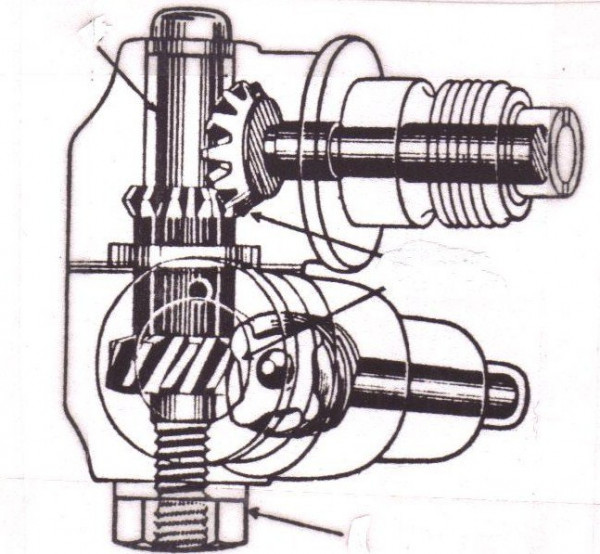

Here is a diagram showing the internal parts of a Model 1913 swivel. I hope this helps.
Russ Furstnow

Re: Need Pictures of Stewart 1913 Swivel Joint Parts
Post by Susanne » Tue Jul 07, 2020 1:12 pm
Helps me! I have one that is skipping, and I was trying to figure out why... that diagram answered the question...
Now all I have to do is figure out how the doggone thing comes apart!
Thank you, Russ!
Posts: 7186
Post by Allan » Wed Jul 08, 2020 10:06 pm
Susan, you need a spanner. :D Put the spanner on that 6 sided thingo on the bottom, and if it fits closely, you can wind that spanner in counter clockwise direction and the thingo will wind off.Then you can turn the bottom half of the housing in the same direction and it will come off too.
Seriously, removing the output end where the cable housing screws on, requires a tapered pin to be carefully driven out. Make sure you drive the right way.
The problem usually come with the input gear and the intermediate where it drives. These wear considerably more than the output end .

OK, so to make sure I got this right... ;)
Take a properly sized dingus (eg not Whitworth, not Meterical), place it on the geegaw on the bottom, do the lefty loosie thingy on it, once off whirl the whole bottom part leftie-loosie as well... get a 2 penny nail, file it tiny and a big ol' wacker, beat the pin until one realized they're doing it wrong, whack it the other way, and inspect the upper (or is it lower?) whirleygig to find the culprit... Wash, Rinse, Repeat. To reassemble turn the instructions upside down, and Viola!
