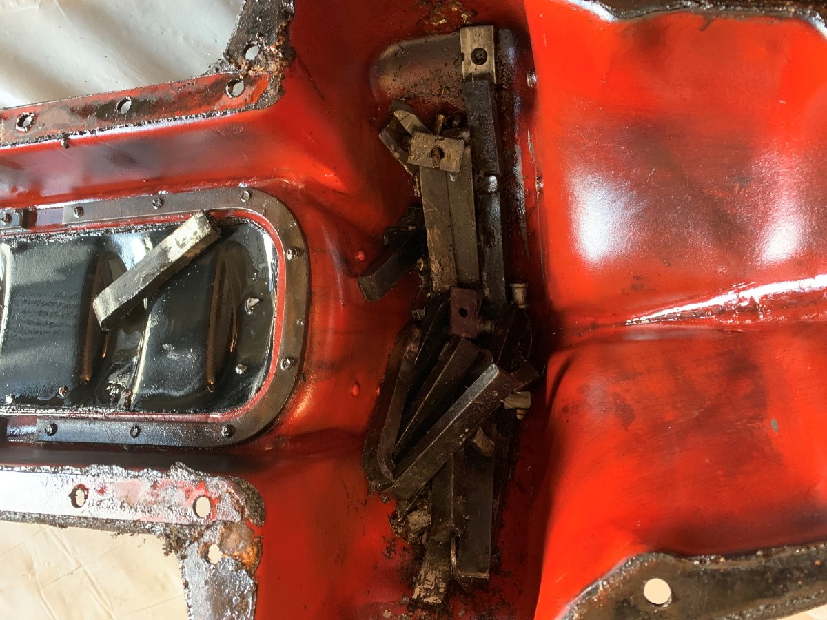

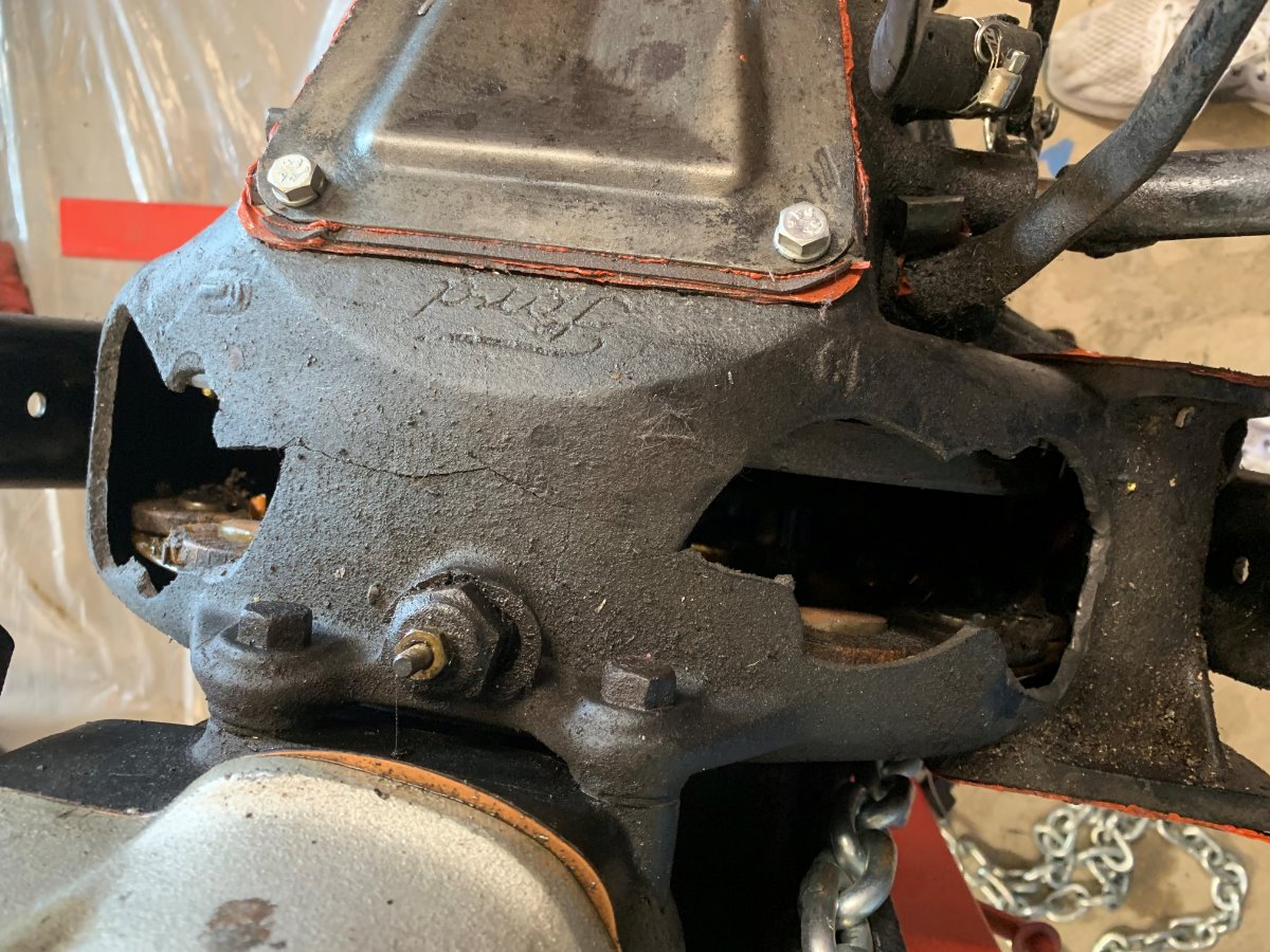

I read a few older posts on this and I see where the exact cause is unknown as to why this happens. Possibly a cracked magnet or a failed brass screw. In the case of my 27 Fordor, I heard a ping almost as if a rock had kicked up and hit the exhaust pipe and then it felt as if I was having a fuel starve issue or the ignition was cutting out. I pulled over and the car died. It started right back up but was running rough. I revved it up only slightly to try and determine what was going on with it when everything broke loose sending shrapnel through the hogs head, floor boards and oil pan. At this time the engine locked up and grey and black smoke filled the inside of the car. I'm lucky enough that none of the pieces hit me when they entered the car. I have taken the engine out and apart this weekend and the pictures show what was found. One piece I am trying to figure out....the u-joint came out when I pulled the engine and I found the u-joint pin broken with both peened ends still in each side of the square end of the u-joint. Not entirely sure how that would happen unless its totally unrelated. I would think that would take forward or backward thrust. Again, I wasn't moving when the mag let loose. Does anyone have any thoughts on this?
I am hoping that this is the extent of the damage after I check the block real good for cracks and put a dial indicator on the flywheel and then the crank output flange. This will go back together with Oil slingers and no magneto.

Welcome to the self destruction club! It really does not take much for this to happen. I would suspect a combination of a cracked magnet with a loose retaining screw on the plate. It only takes one and the chain reaction begins. I hate it for you!

This is precisely why I have never recommended the in-car magnet recharge procedure. Not removing and recharging the magnets individually doesn't allow you to find and remove cracked magnets or other parts of the magneto such as broken magnet screws, all of which, as can be seen here, are time bombs in an engine. Cracked magnets are a major cause of a weak magneto, in any case. I'm not saying that an in-car procedure was involved here, just that it's an opportune time to remind everyone about it. The procedure was popular 80-odd years ago but the magnets and other parts were 80-odd years younger then. There's no need to do away with a magneto. Just be absolutely certain that all parts are known beyond doubt to be good before you re-assemble things.
So glad that neither you nor anyone else was hurt.

Seeing the condition of your hogs head, I'm sure that you had to replace it. Did you use the low pedal as is in the replacement hogs head, or did you replace the low cam and notch? If those are not in good condition, you will find that you can't get the low to work properly. In that case you would need the low band too tight in order to get it to work. If it is too tight, you will not achieve a free neutral. And to get it to work properly you would need to loosen the low band so it would only work in low with the pedal below the floorboard. Another possible cause of a problem would be the clutch lever. The yoke might not be engaging properly with the clutch.
Anyway, check all of the above and also what I posted here. I question whether you have a problem with the ring and pinion unless they were bad before. But if the car came to an abrupt stop when the magneto collapsed, perhaps the jolt could have affected the rear axle gears.

Thank you for the info. When I replaced the Hogs Head, I replace all of the cams/notches and all new pedal shafts. I was not moving when the magneto let loose so there was no sudden stop.
