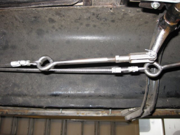

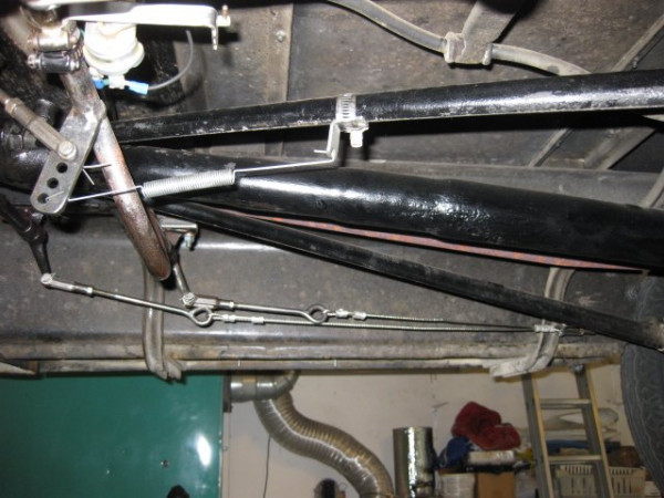

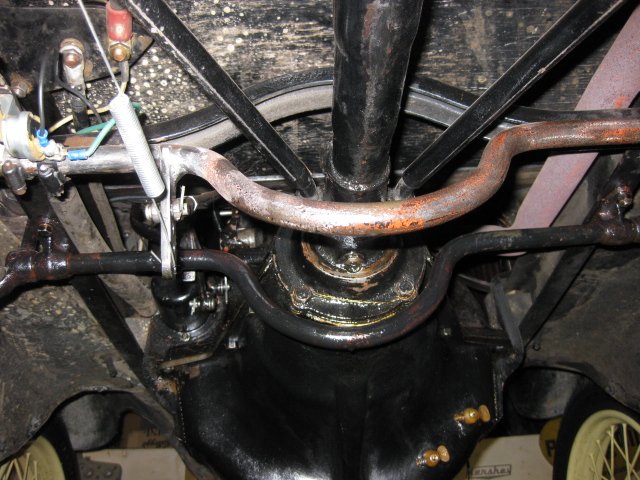

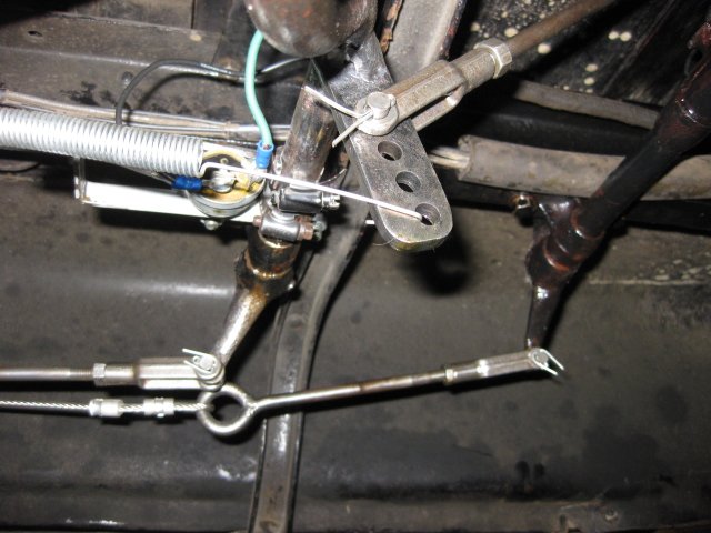

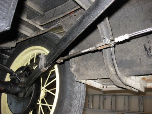

OK guys , here are some pictures. I'm extremely happy with this set-up and the cost was minimal. I do have a hoist that enables me to lift the rear wheels and it was sure beneficial when making adjustments....and I made lots to get he action just right.The "new" service brake hits just before the transmission brake as there is more linear motion involved with the new brake set-up as opposed to the short brake pedal travel to activate the tranny band as well as more connections to have the slack taken up. Note also the arm for the adjustable rod to the brake pedal has several choices for travel and mechanical advantage. More travel here gives more leverage so I had to coordinate the travel of the new set-up with the existing travel of the pedal to fully apply the transmission brake.Also note that the new cross shaft is as far back as I could place it to clear the travel of the original cross shaft as well as the two arms from the U-joint to the backing plates. To get adequate clearance I had to put a 1" spacer between the mounting blocks and the lower frame rail. Photo 1 shows cables with both brakes off. Photo 2 shows placement of the new cross shaft. Photo 3 shows the cross shaft, brake light switch (1949-54 Chevy) and with both brakes off. Photo 4 shows the saved rear section of the original brake rod with both emergency and new service brake cables attached to a common point.Photo 5 shows another view of the two cross shafts and rod to the brake pedal. Note that I initially used the little bolt on cable clamps while getting the cable lengths close. When I was satisfied with my cable lengths I removed the bolt-on clamps and installed the crimp-on clamps that not only look better but they will not slip.

I was going to ask if the transmission brake was still hooked up as well... that is one heck of a balancing act! My hat's off to you, sir... Well Done!

Bruce.....I thank you for taking the time and effort to share your rear brake upgrade. Your results look very carefully executed. Certainly has to provide a marked improvement to the standard "push and pray" Ford foot brake......Regards, John
