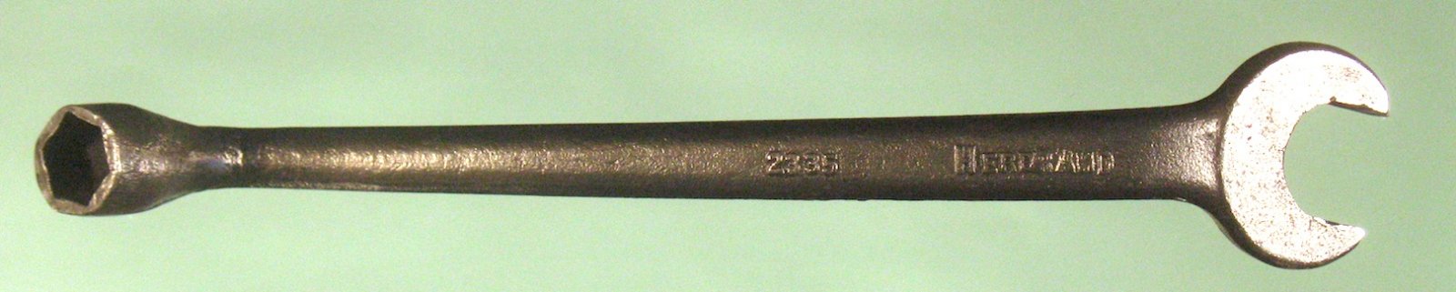

your talking a 100 year old engine, back then there torque wrench was the elbow, take your plug wrench that came with the car snug the plug up tight, then give it one more little tug, your dealing with pipe thread with a taper,that should be good enough, the t plug wrench is the best tool for this job.the other end will remove the rim nuts too.
- Posts: 7388
Re: Spark Plug Torque
What Richard said. Use the #2335 wrench and turn until they feel tight.
