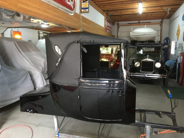

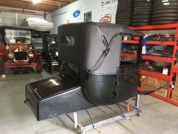

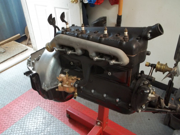

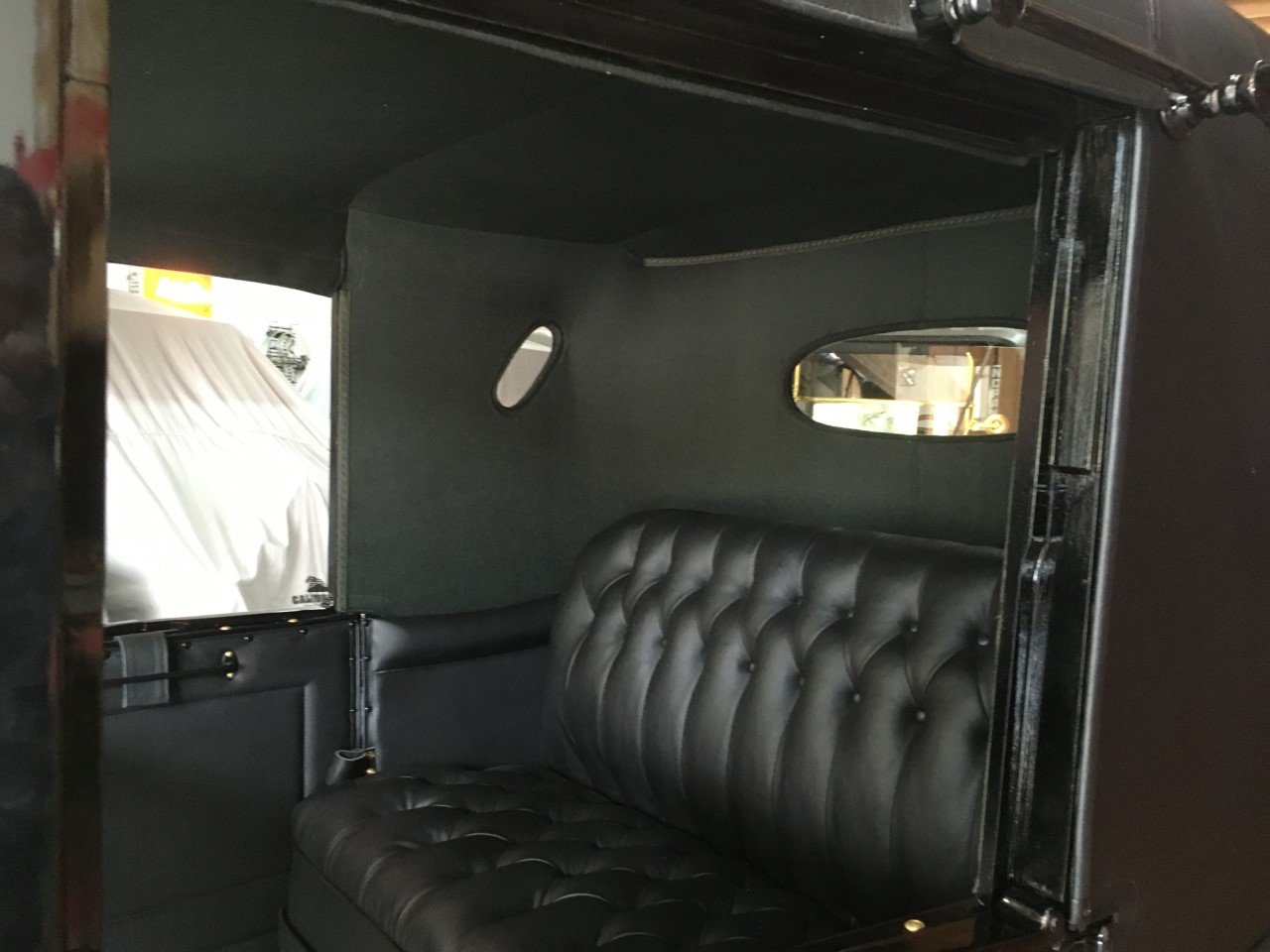

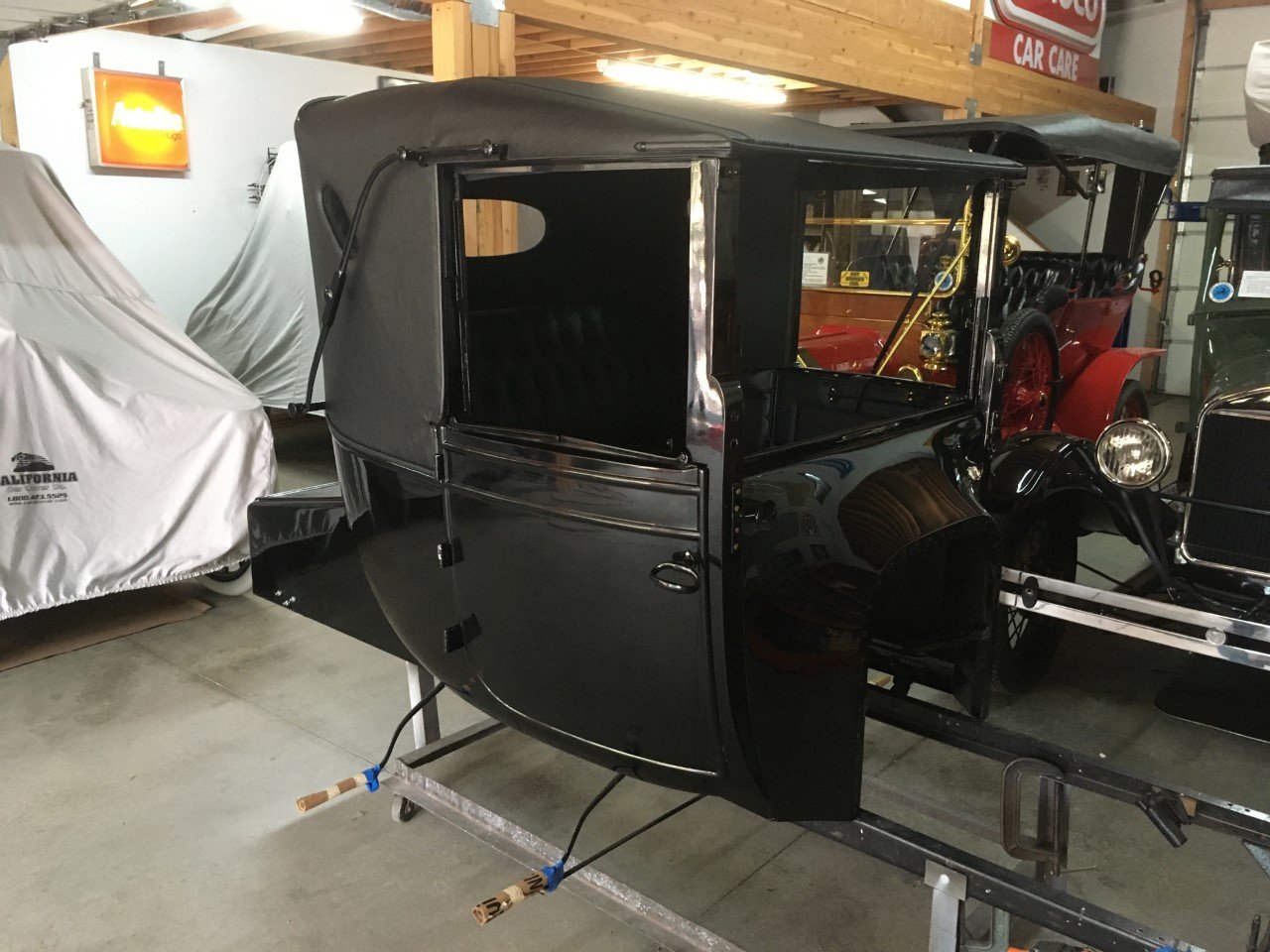

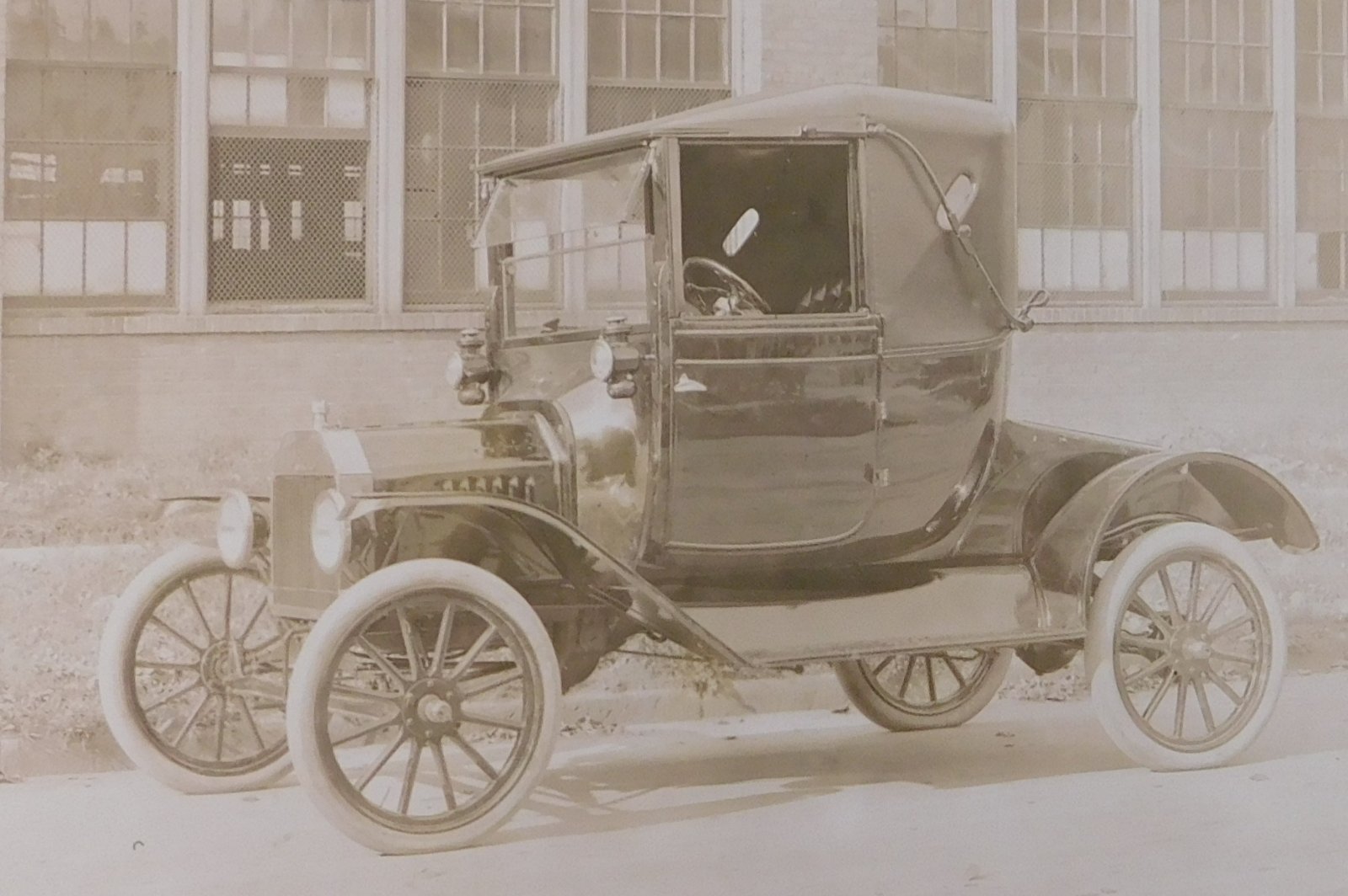

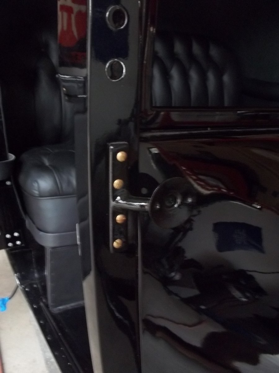

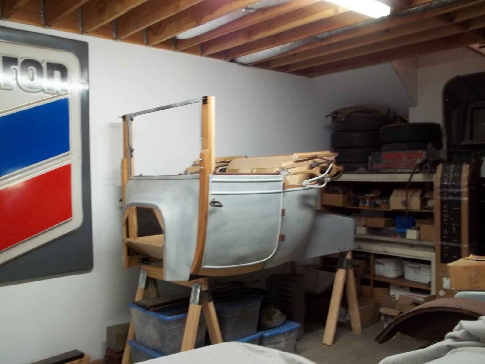

It's time to move along with another restoration, and this 1916 Coupelet is my latest project. The car was purchased by Mike Walker, who had worked on the chassis, but did not get the body completed when I purchased the car from him. I had Ray Wells re-wood the body and had my good friend massage the body panels and paint the car in Limco "Ultra Black" single stage urethane. The upholstery and top were completed by Ernie Romero of El Cajon, CA. The engine was rebuilt by Jim Blair of Tucson, AZ and I completed the assembly and restoration of the engine assembly. The engine, with a casting date of 12-27-15 and SN: 1025XXX, determine that the car was completed on December 30, 1915. Interestingly, I have an original photo of a new 1916 Coupelet at the factory with black and brass trimmed side and head lamps, and I have a set of these lamps I may use. I have completed the front and rear end rebuilds and the frame is also ready to paint. Here are a few photos of the Coupelet:

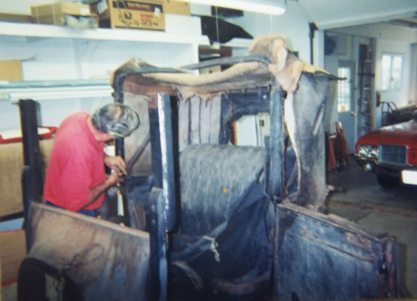

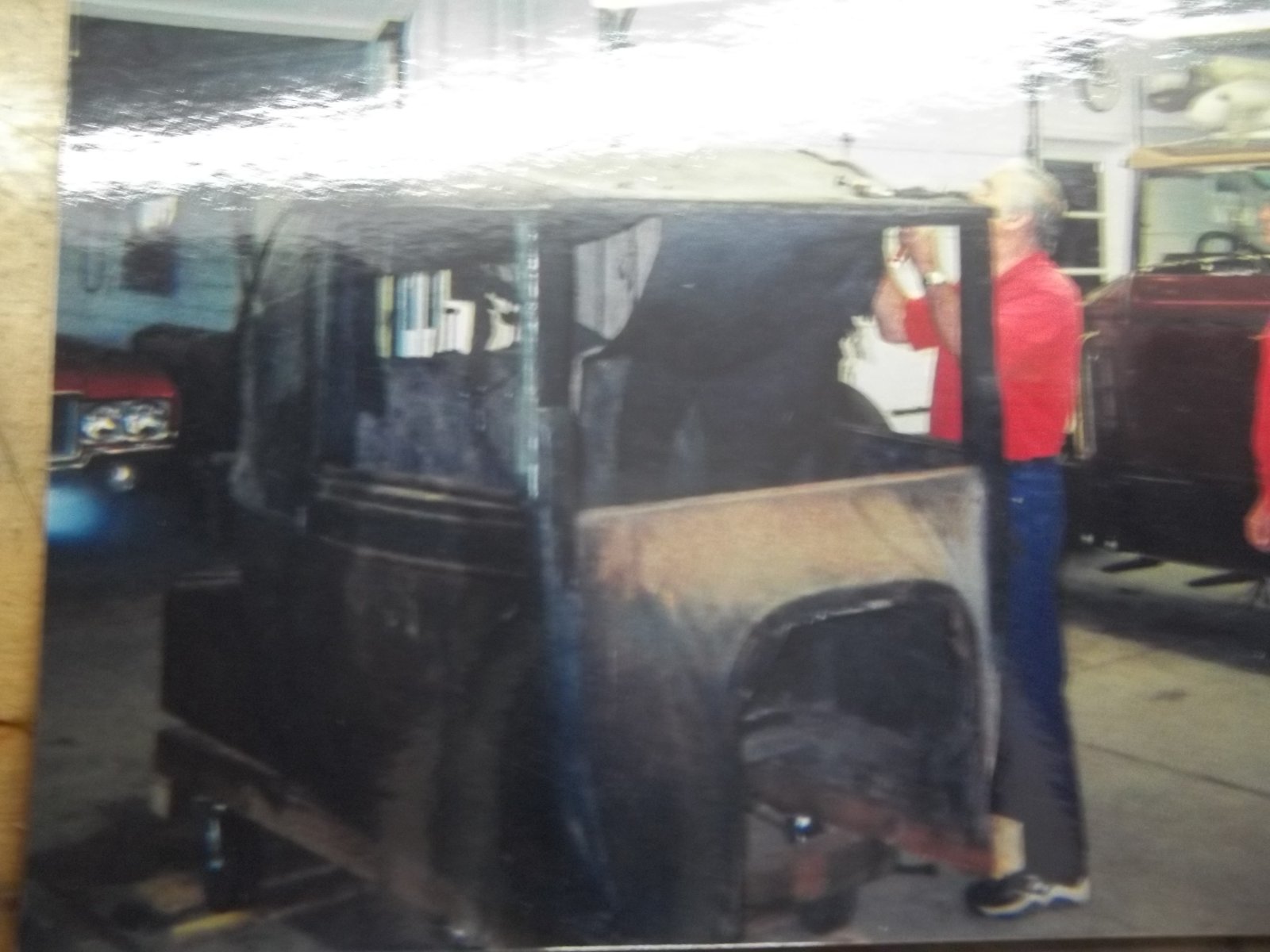

Here is the original photo of the coupelet with brass trimmed lamps and the coupelet body, as found, being initially disassembled. As I make additional progress, I'll add photos. BTW, the 1916 coupelet is a huge improvement over the 1915 coupelet with the small side windows, larger rear window and the trunk lid on the top of the trunk. Also, the 1916 car had a dark green headliner rather than the blue liner on the 1915.

Russ, it's good to see you have the correct breather cap! Remember how for so long I had to fight with you to get you to see what is correct?

Of note, the 1916 coupelet had a trunk lid on top of the trunk, exactly like the later coupes. I believe if Ford had installed this trunk lid and the small side windows in the 1915 coupelet that was introduced in October 1914, the car would have been a sales success. Also, on the 1916 coupelet, there is a license plate bracket that was missing on the 1915. Also, the sidelamp brackets are unique to the coupelet.
