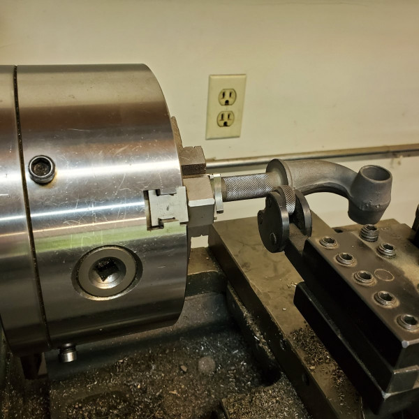

I find the front spring perches are a bit loose when inserted in the axle. perhaps .006" Both the axle and perches are replacements due to the accident I suffered a couple weeks ago. They have been sandblasted. What if anything do people do to create a tight fit? Knurl, shim, forget about it?

Thanks for the input fellas. Wayne, what do you think of the idea of knurling the shafts for a snug fit. If the nuts that hold the wishbone to the perches are tight, do you foresee a problem?

I have never been a big fan of knurling for fit. Although I will admit to using knurled pistons a few times years ago. The problem is that knurling creates both high and low spots in an attempt to raise the surface and make a tighter fit. In reality, the high spots are not even enough unless one grinds or emery tapes the surface for a final fit, which in fact further reduces the surface from what one started out with. Knurling very often begins to wear a bit, and one can wind up with similar looseness as one stated with.
In theory, ANY indentation or cut on a smooth surface is a potential start of a stress fracture, for any item put under both stress and vibration. And spring perches are very definition of stress and vibration. It is unlikely that knurling would result in a fracture failure. In reality, knurling would probably be fine. But one of the reasons I like the "e-evil shims", is that they at worst become a sacrificial wearing surface. The material for the most part cannot work out, so therefore still help to fill the void even if they do begin to wear. Knurling leaves voids where worn material can hide and return to loose again.
Just my opinion again.

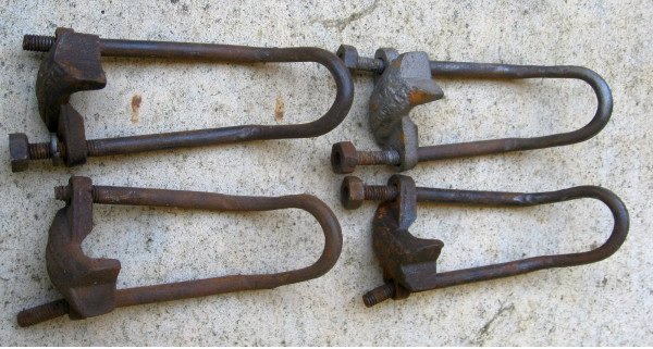

There made an accessory to stabilize a loose perch/wishbone. Steve Jelf was given one for a loose perch last summer at an auction in Indiana.
Perch - wishbone support.jpg (63.1 KiB) Viewed 8171 times

Frank, that's an interesting accessory. Indicates loose perches have been an issue for some time. Puzzling to me why the manufacturing tolerances were so great.

And IIRC, the accessory “support clamps” pictured above were intended to prevent the wishbone from falling off should the perch nut ever come loose or be lost. These clamps could not have corrected any clearance issues between perch and axle. But would be good insurance if you had stripped threads, or didn’t believe in cotter pins or tie wire

Update. I always enjoy someone telling me how their posted problem turned out, so here goes.
I first tried to shim the loose perches in the axle. No luck. The shims refused to stay put, in one instance they tore. I decided to knurl the shafts with a knurling tool on my lathe. It turned out good and the perches fit with a light press fit . No movement. I didn't care if the knurling made a tight fit because the high spots would compress under pressure.

Thanks Richard for the update. Your knurl method seems practical and it worked. Good job. ;)

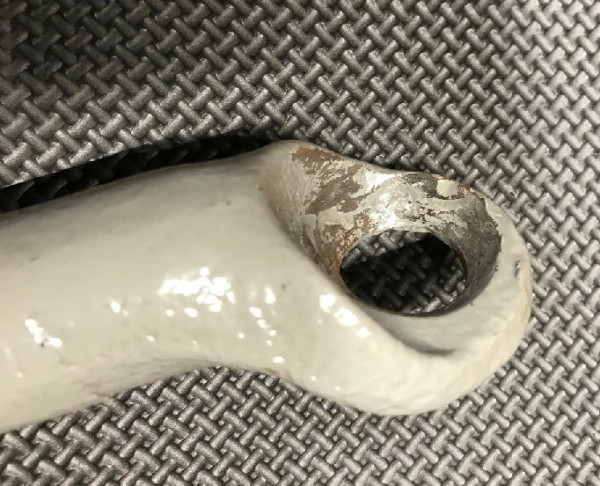

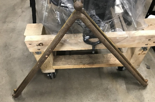

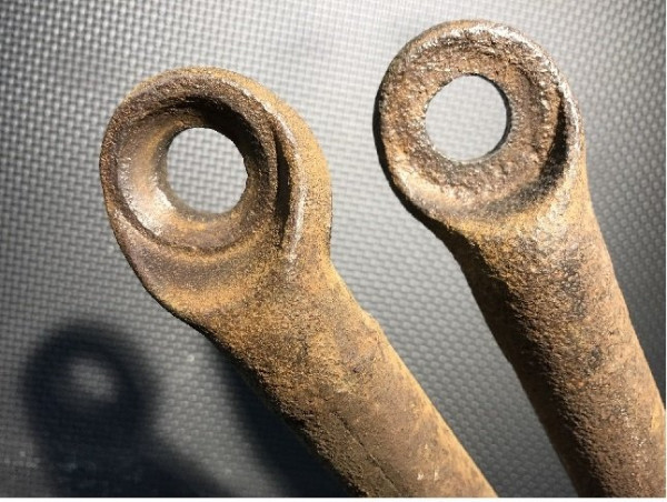

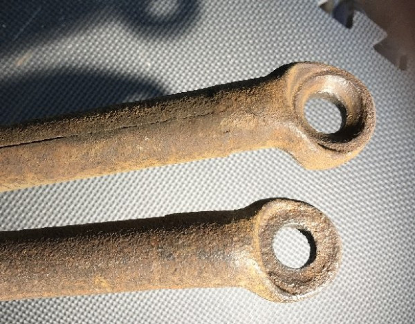

I have to wishbones with different attachment lugs and tube construction. see photos. They also appear to be the same size etc. The picture of the gray attachment lug is one that is so worn that the coned nut couldn't tighten against it resulting in a loose perch

Frank B, et al, I believe that odd one may be a very early version of the under-axle wishbone. Mostly late 1918 on TTs and early 1919, the first under-axle wishbones used a flat bottomed nut, and may have been used mostly on the early TT trucks. They developed looseness issues early, and were replaced by the common coned type after only a few months. I have read of these, but never had one myself

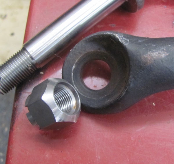

Wayne Thanks for the input. Also the need for a good cone to nut match to tighten down the perch.

On many wishbones I examined before choosing the one I have for replacement, I saw the imprint of a hex nut from wear on the bottom of each arm where the perch nut rides.
From prior experience I discovered one way to smooth out the contact with the cone shaped nut is to make a copper washer to be placed between the bottom of the perch arms where the hex wear is present and the cone of the nut. The washer compresses into the arm recess and keeps the cone nut from bottoming out on the hex recess before fully tightening the perch. I initially tried a brass washer but it tended to disintegrate . The copper I used was better suited
