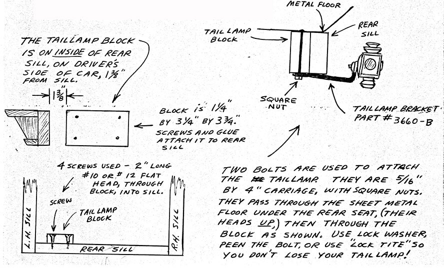

Re: Help!! Taillight bracket failure - Something doesn't seem right...
This sketch was in with my 1914 stuff and shows a block as I was imagining it. Perhaps a similar block was used for the 3-hole bracket in '15
Yes, it's a touring.And that block would make sense - I wonder if, when dad had the car painted decades ago, someone forgot to put the block (or L bracket or whatever) back? Hmmm... I'll jave to do some exploring, see if I can find where said block would have been attached...
That's what I was wondering, too, but I just don't know. If there was a block there originally, it's not there now. I can understand the why of that 3rd hole, but wihtout something to support it, I was lost... after all, I wouldn't think Henry would make an engineering change that is more complex and cost money without a reason or a solid explanation for it, or (in this case) a quick easy and cheap way to put it to use.
I was also thinking a steel L bracket to attach the 3rd hole to the sill via the front side of that same sill block... what I wouldn't give for an engineering drawing from Ford (or Fisher or Beaudette) of that aera to see what they did.

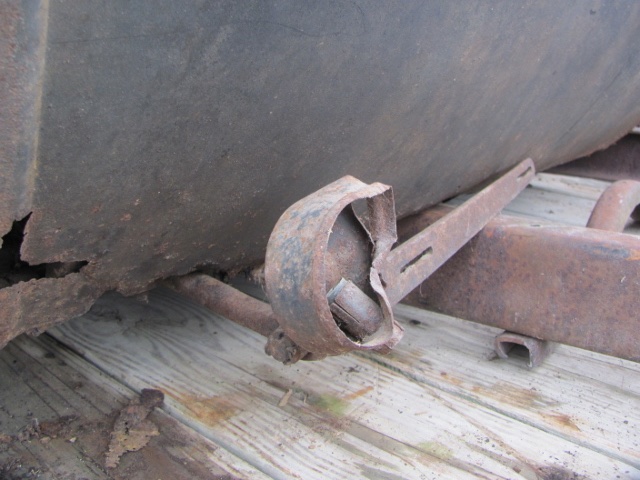

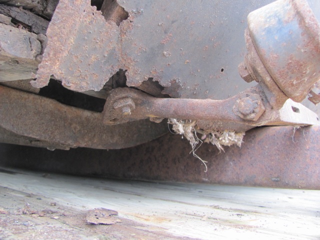

- Posts: 4087
Here are some remains, an elec. tail lamp added, but is an early "15 touring with the 3 hole bracket w/ bolt on license holder, maybe had such a block before the rust out and termites!
Thank you, Dan and Rich... Looks like I have a woodworking project for this afternoon!
I'm noticing in the picture of the electric conversion that that 3rd hole is also bare - so it has me curious if it ever had a support there in the first place...
More mysteries!!
