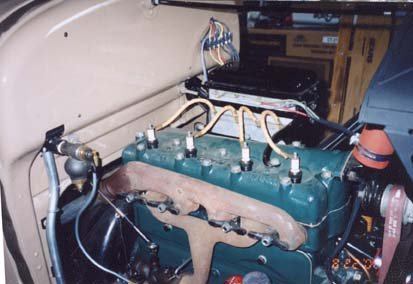

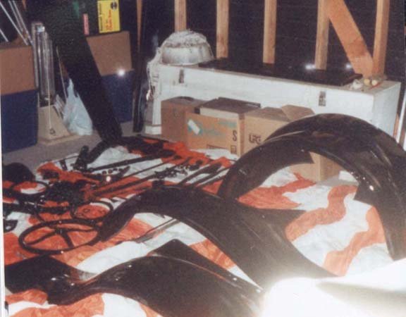

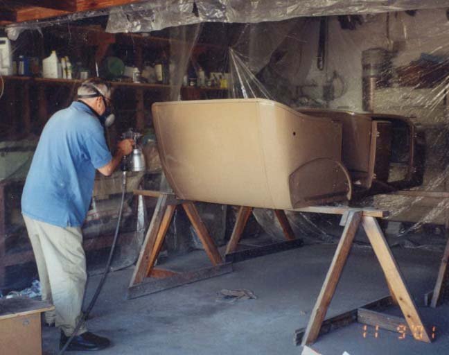

I realize that how you paint depends on which year and which body you have. The one I painted was a 26 touring which is an all steel body. First I did all the dent straightening and welding up rusted out places (which were few). Then I used an epoxy primer on the bare metal including the inside as well as the outside and made sure it would flow into any hidden areas so that rust could not form from the inside. Then I used what necessary body filler I needed to get a completely smooth surface. It is a mistake to think that the final coat will fill in all the imperfections! Must get them filled with bondo or sandable primer. Before you paint try to smooth things out by hammering, grinding or filing so that the filler will be as thin and as little as possible.
I painted each fender, hood panel, door and other removable parts separately with sandable primer and sanded to the smoothest surface as I could get. Then I used acrillic catalitic enamel. Note, I did not use a clear coat. I park inside and when I wash, I use the cleaner which contains wax, so I do not need to wax the finish either. So far it has lasted 18 years and still looks good. I used a color which was from a color chart used on the 27. Although I had a 26, I wanted a little color, but the 26 and 27 bodies look almost identical. I put the body up on horses so I could paint underneath as well as the rest of the body. I did not put finish coat on the inside of the body, but did put black on the fenders and running boards and all the black parts of the car. Both underneath and on top. The chassis was painted gloss black as well as the transmission and crankcase. However since the engine on that year was green, I painted it green. The color is not a match, but it was what I could find in a spray can. You need heat resistant paint for the engine. The horses on which the body was placed were constructed in such a way that I could roll the chassis under. The wire wheels were painted "Straw".
