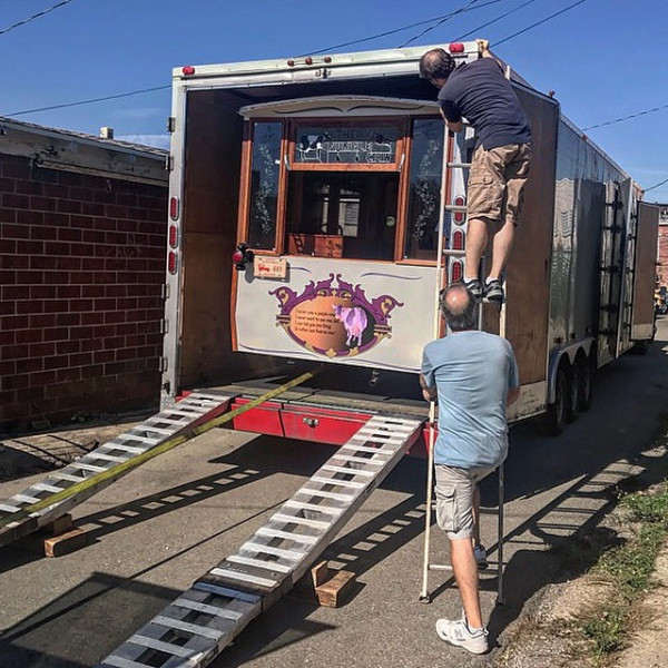

My 16-footer advertises 84" height, and it is if you are stacking boxes, but the minimum loading door clearance is 81 inches. I have a '27 Touring car and it does measure 75 inches at it's highest point; earlier Ts are two to four inches taller but would still fit. I have a friend who has a '24 Touring car and he gets it into his trailer which is the same height as mine, but he almost always drives with his top down. I don't know if it will go in top up or not.

Also consider that the car will bounce within the trailer when traveling. Extra height will be needed. Ask me how I know.

I have a '27 ft Interstate inclosed trailer with vee-nose that I bought from a Trailers Plus dealer. The Model name is "All Sport", mainly because it can be used as a "toy-hauler" but built with all the strength of a car hauler trailer that can handle any full size modern vehicle as well as my Model T's and Model A. A few features that I really like are as follows:
Rear door clearance is 84" which clears my tallest Model T ('23 roadster pickup) with top up. Note that this trailer has the extra height but only 6" extra (not the usual option of an extra foot) which is enough but not more than needed for my tallest Model T. A big help is that the 84" rear door clearance is partly due to the beavertail feature. Also, many trailers with extra foot height look cumbersome but not mine so much with only 6" extra height. And, while it does have a bit of extra ground clearance, which is nice, but not so much as to look "top-heavy" like most toy haulers. (.....it really doesn't LOOK like a toy-hauler!)

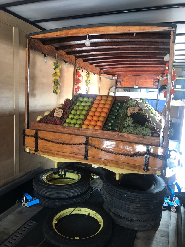

I am very happy with my Integrity trailer. As to fire chief's comment, your T will not bounce if you tie it down properly. I use two straps in front; one over each side of the front crossmember anchored diagonally outward towards the sides of the trailer. I use and two more straps over each side of the rear crossmember attached to an anchor in the center of the trailer's floor. I tie down the front first which pulls the T against a front full-width wheel chock that is bolted through the floor to the trailer's frame. My old T ain't going anywhere - on the trip down to Florida from Massachusetts it survived two separate panic stops when drivers entered my lane at very low speed without signaling. The T didn't move at all.

A antique car mechanic, much smarter than me, cautioned against “over building” the trailer. Very heavy duty axles and suspension mean a harder ride for the car. Torsion axles help.
He tied his brass car and arrived at the destination with the spoke wheels having broken and his car on the ground.
Hard to imagine but I have heard it now from 2 different brass guys.

My personal feeling is that if the spokes failed during a trailer trip they probably needed to be replaced before the trip.

A wheel that fails on a vehicle being transported
in an enclosed trailer would have failed while operating the vehicle on the road.
Unless the enclosed trailer was damaged while being towed somehow.
I had a 1908 Thomas Flyer ( tribute car ) collapse inside my enclosed car trailer during transport
from Colorado to Washington.
Turns out the frame was being held together by C Clamps and angle iron
FJ

I am also in the process of ordering an enclosed trailer. Some place there was a discussion and 7' 3" door and interior clearance was mentioned as a minimum for transporting a T. I can't find it back. Is 7' clearance enough? Seems that's more readily available.

There has been a time or two when my 8 foot rear door clearance had been challenged
