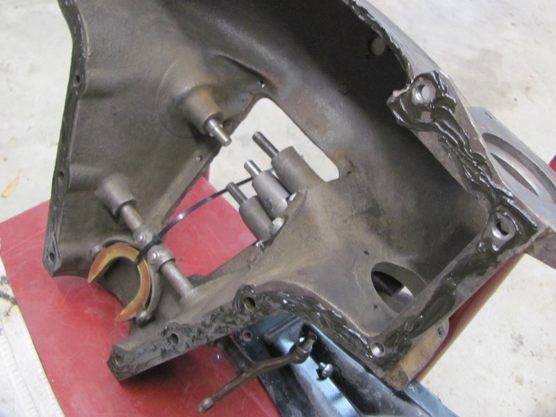

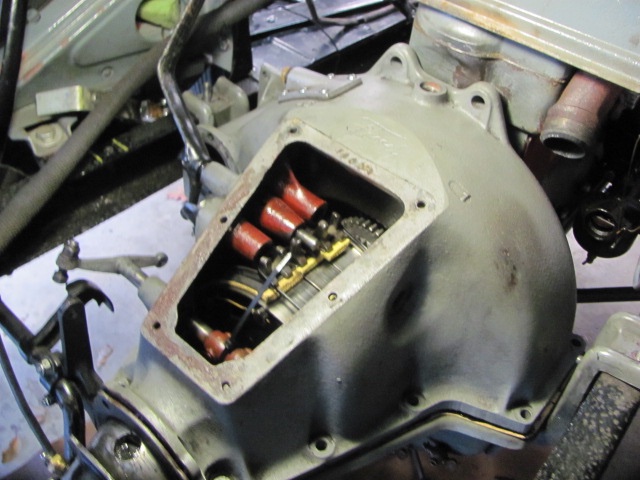

On install, lots of Permatex, and for me, wrapping the dangling clutch fork with nylon tie strap, keeps it in line with the clutch lever, that I hold and direct that fork with one hand, and the other on the interior of the inspection hole, and fit the hogshead back into place.

What I do is as Dan said remove things out of the way. Remove the cover and clean up all the gasket surfaces both on the cover and on the engine pan.
After that’s done use Permatex on the engine pan and lay the gaskets down on the pan and lightly press and position in place and let them set up to secure them.
I found by doing this it keeps the gasket in place and no juggling or maneuvering is required.
There is a piece of felt that goes between the cover and engine block. Also secure it with a light bead of Permatex to hold it in place.
Coat the Transmission cover surfaces with Permatex and then lower the cover onto the engine. When the cover is bolted down use a little Permatex in the corners where it meets up with pan.
Shouldn’t have any leaks.

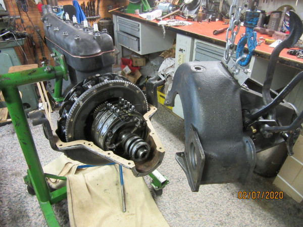

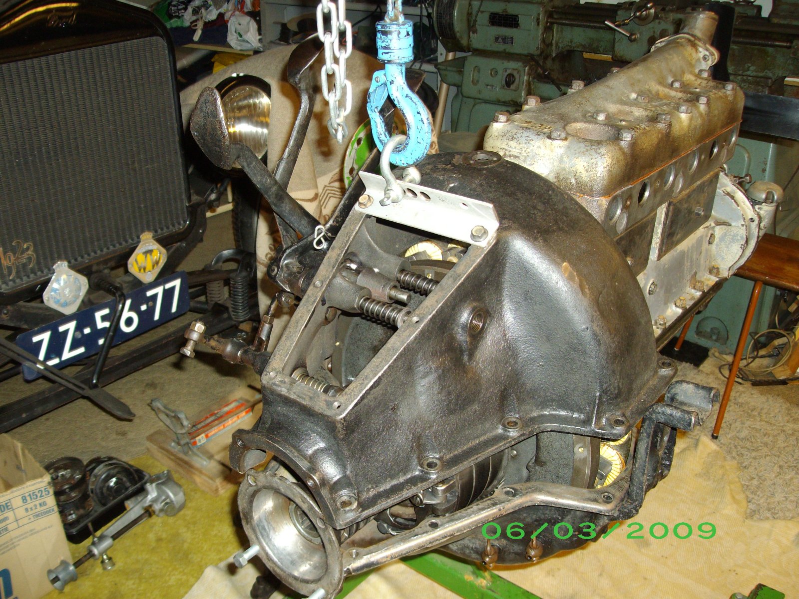

To mount the hogs head , I got some help of my hoist.
Toon
