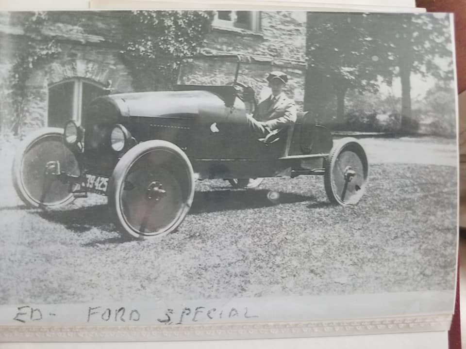

Hi Don, This image was posted to one of the model T facebook pages I watch. I thought it looked like the original version of your car. I have enjoyed watching your build progress. I had a 4 valve Rajo on a Tudor Sedan at one point. Never had any Head gasket issues. It was a newly made composite type with copper and asbestos alternative inside. I think it is important to have a sandwich of something in between the copper to torque down on. I also put valve tops in the seats for the extra support of the gasket.
