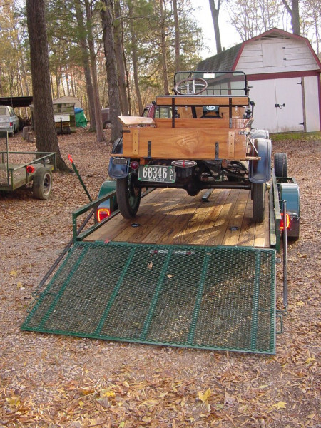

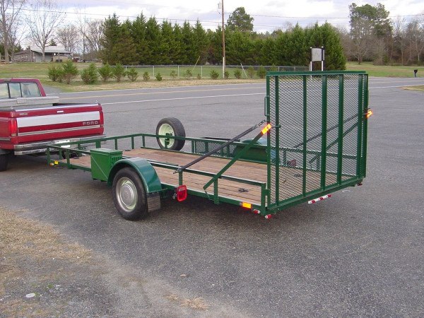

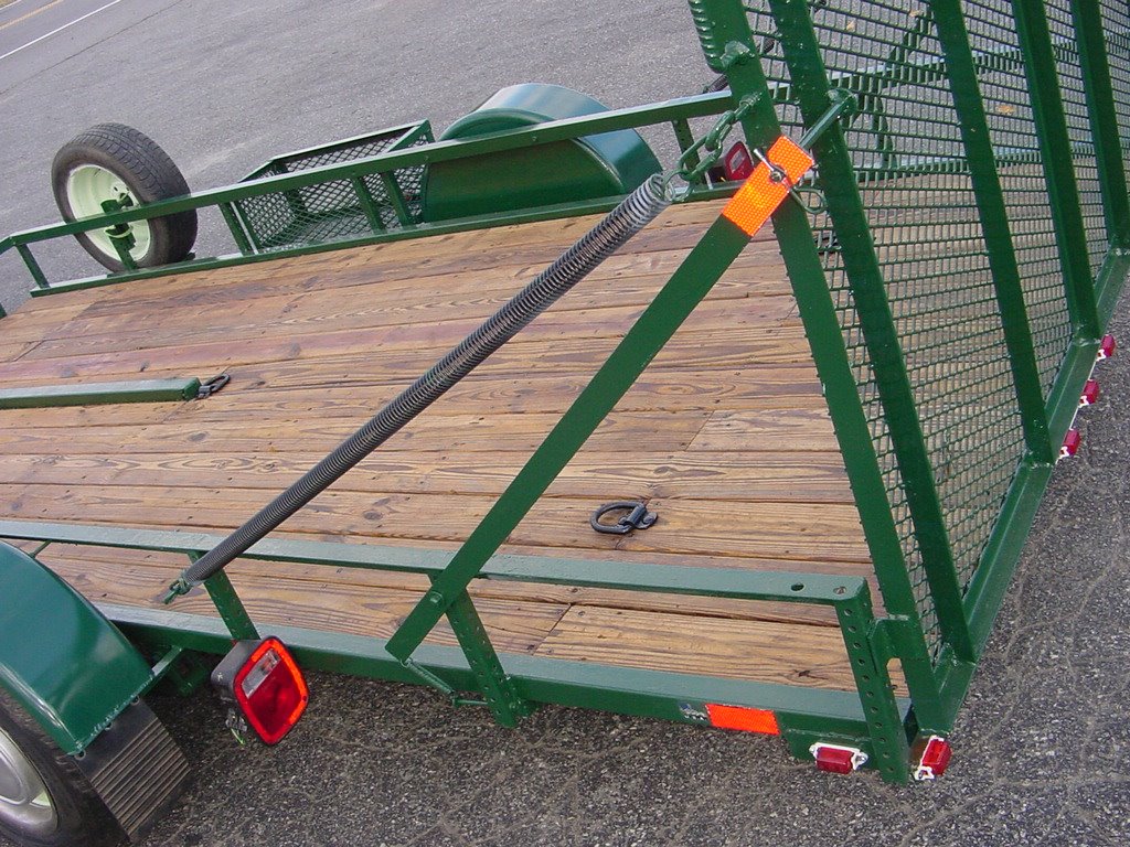

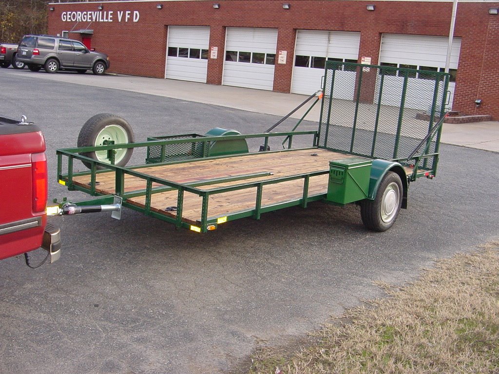

Re: trailer design

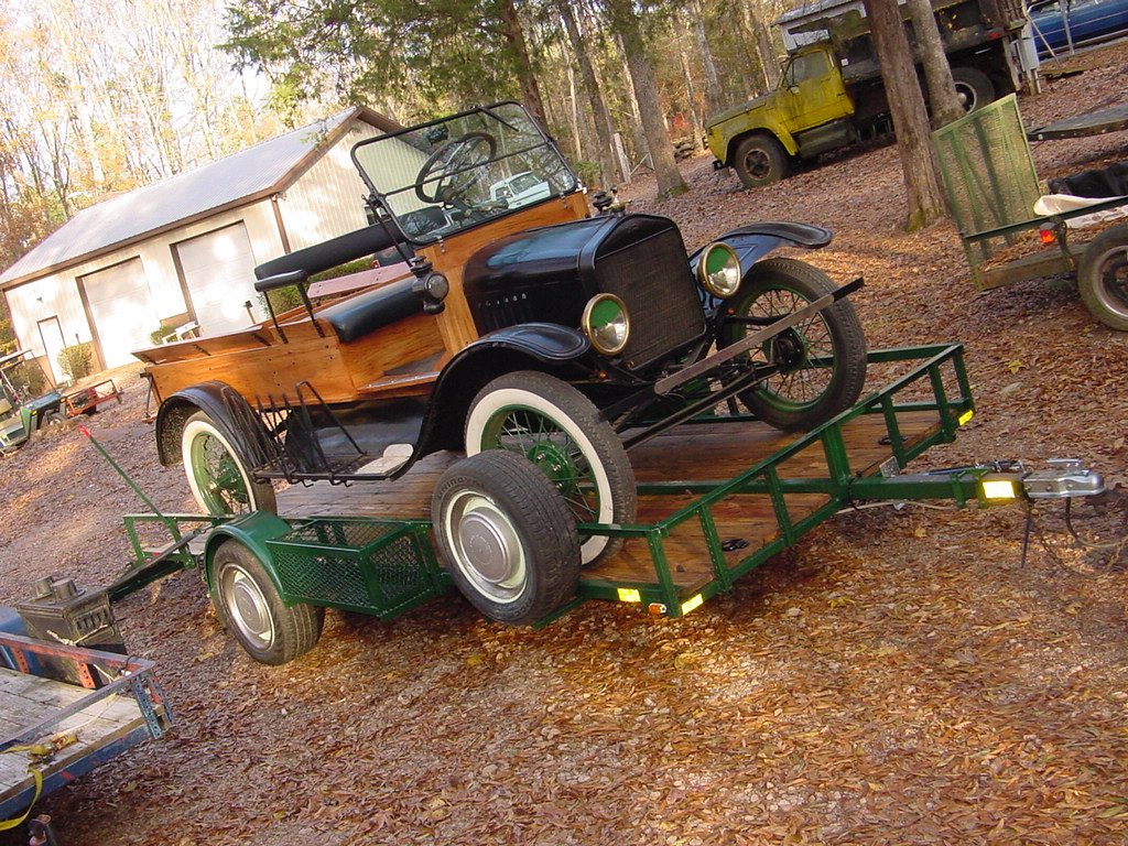

Whatever the length of the trailer,put the axle 1 inch back from center of trailer for every foot of length.
14 foot, 14 inches back from center.
This trailer pulls like a dream,hauls my T well.
I built it myself and could post some closeups if needed.
The spring assist for the gate lift,works just about 2 well,I have to hold the ramp back a bit to keep it from slamming.
tdump
- Posts: 1428
- First Name: Mack
- Last Name: Cole
- Location: North Carolina

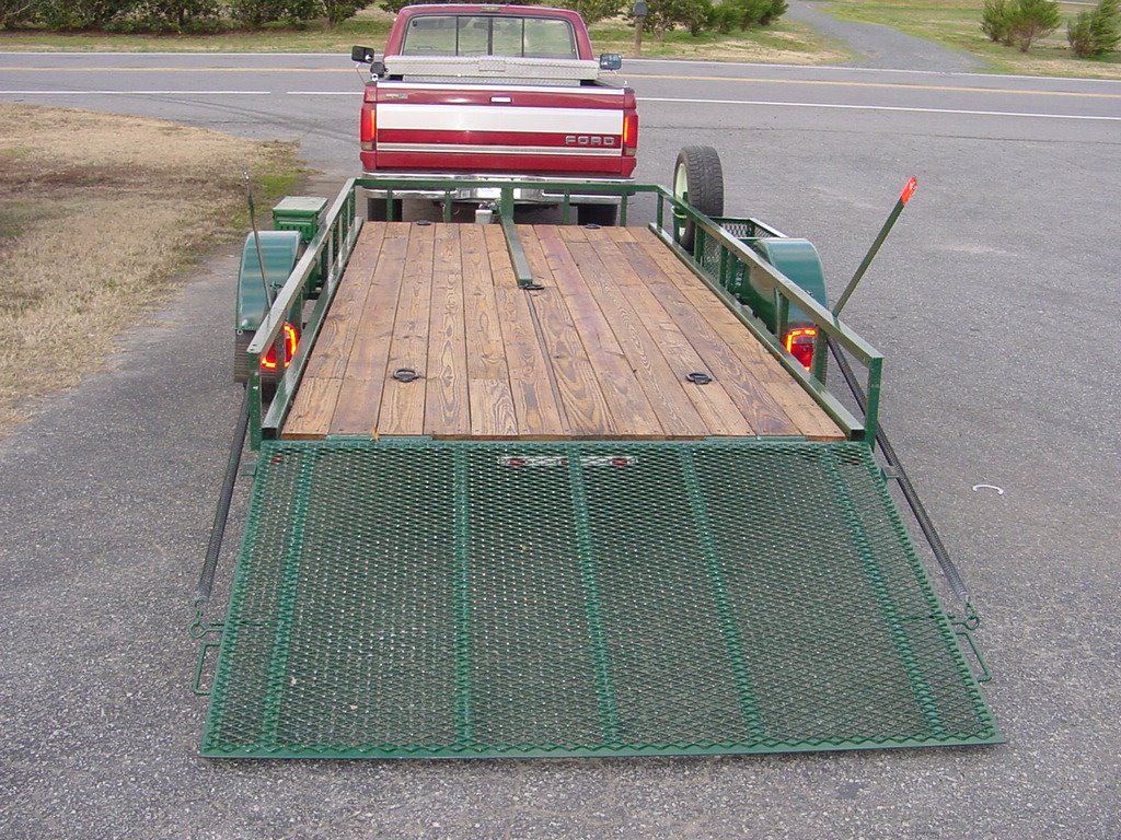

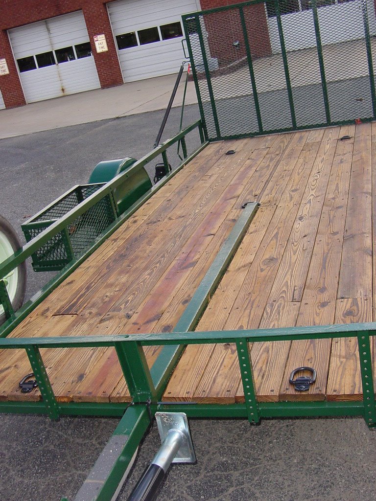

Re: trailer design
couple more
The brackets that hold the ramp shut,I designed them so that a light spring holds them UP to act as guides when loading the T and also it keeps me from bending over to pick them up to latch the tailgate.

The spare was in the other car.
It is single axle. Since then I haul the T on it.
The front rails are great to run the T up to. The straps go from the front axle to the tong of the trailer.
The rear axle get a cross strap tie down. Then I run a strap from the back axle to the tong.
This configuration seem to keep the T in place with undo stress on the suspension.
The utility trailer has served me well. Only once did I have to leave it to get a new tire.
