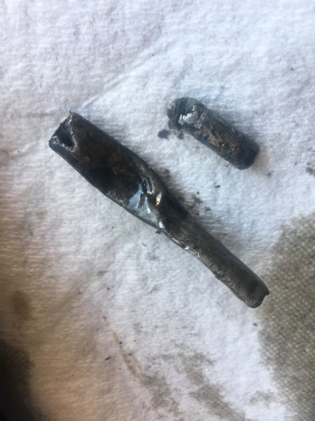

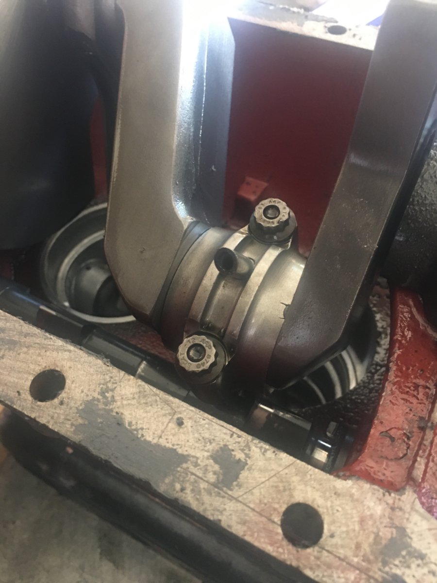

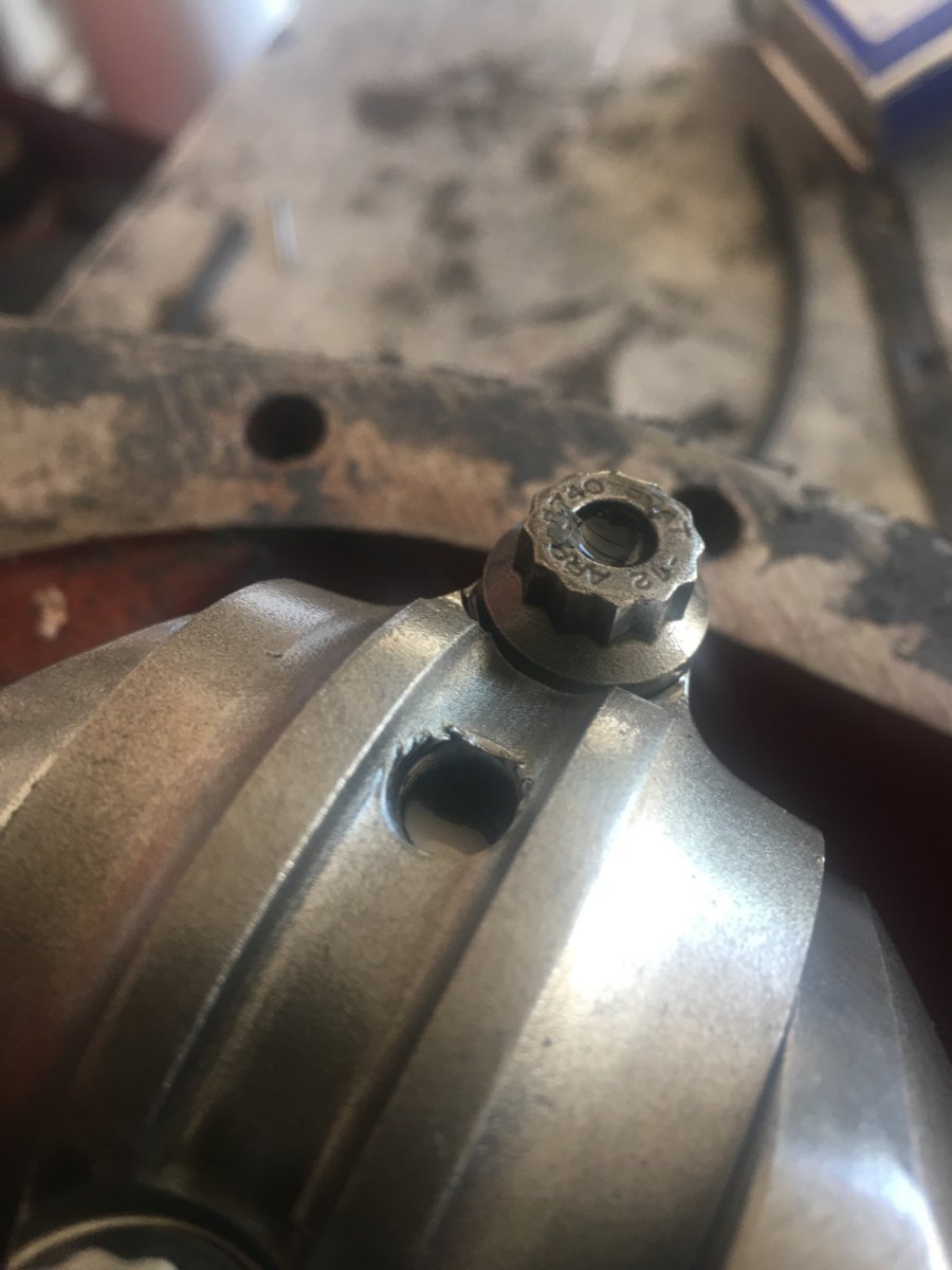

Finely got the flywheel off the crank hit internal oil line not enough clearance! damage mag spools and 2 magnets and the oil dippers it ended up in clutch plate photo 1 oil dipper broken off and internal oil tube broken off photo 2 rod cap missing dipper tube photo 3 rod cap with dipper these are tubes cut and thread into rod cap need like model t but deeper scoop may have to make need a oil scoop any one have one heard model a is bigger

Rich, the oriblem may go right back to the internal oil line, if it was a repro from the vendors. The large scoop end on the repros is poorly fixed to the tube. Before I fit a new tube I re-bronze the fitting at the junction.

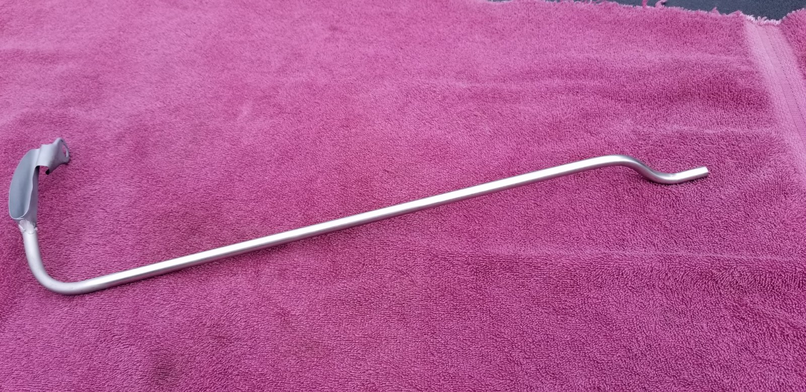

Experienced clearance issues with the factory internal oil line between the block and counter balanced stroker rod cap on Model TT. Purchased stainless steel tubing and bent the tubing (see attached photo) to rise higher in the block to clear the rotating arc of the connecting rod cap. Also, I extended the length of the tubing where it exits the block towards the camshaft gear. With a tapered punch I mushroomed/expanded the I.D. of the tubing to further secure the oil line in the block.

John that oil tube is nice might do that .Hank the oil dam in the pan is good what height! I ordered a oil tube from Langs nice people great to work with the dippers worked fine, if the chev dippers don't work out i will fix them not much were on bearings and main concerning the the fine aluminum chips from the mag thimbles and a few large peaces from the oil tube will plaste gauge rods and mains will have to used the copper head gasket again third time is the charm its good next time will change bearings spent to much money other things engine sounded fine i think it will be fine
