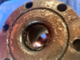

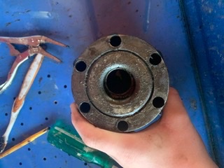

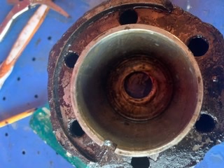

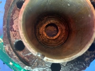

The roller bearing on my driveshaft is stuck inside the spool. Is there any specific way to get it out? Something is blocking its way out the front of the spool and I know it’s supposed to be able to come out but i don’t know how to take it.

That's the "thrust" bearing down there - use a block of wood & press it out.
