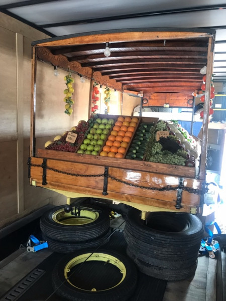

I had a 1908 Thomas Flyer ( tribute car ) collapse inside my enclosed car trailer during transport
from Colorado to Washington.
Turns out the frame was being held together by C Clamps and angle iron
FJ

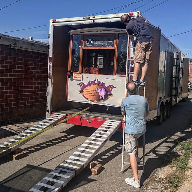

I am also in the process of ordering an enclosed trailer. Some place there was a discussion and 7' 3" door and interior clearance was mentioned as a minimum for transporting a T. I can't find it back. Is 7' clearance enough? Seems that's more readily available.
- Posts: 1722
- Last Name: Jarzabek
- Location: Dayton, OH
- Board Member Since: 2008
8 Feet Might Not Be Enough
There has been a time or two when my 8 foot rear door clearance had been challenged
FJ
