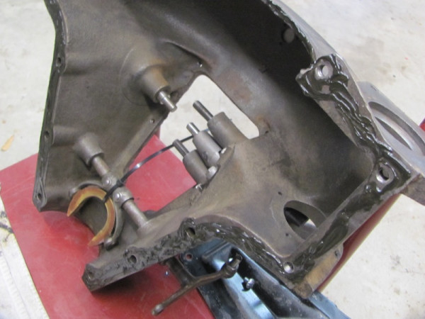

For me, I take time, and remove all the things in the way, exhaust, pedals, any attachments like brake lite switch, out side brake fittings etc.
Then for the rear, like to remove all 4 bolts at the ball cap, that helps make room too. When installing, usually just trim the upper section of the 4th main gasket, and add a new upper side piece trimmed from a complete gasket.
On install, lots of Permatex, and for me, wrapping the dangling clutch fork with nylon tie strap, keeps it in line with the clutch lever, that I hold and direct that fork with one hand, and the other on the interior of the inspection hole, and fit the hogshead back into place.

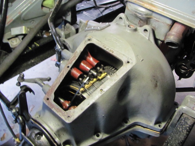

To make room at the driveshaft end, I hook a tiedown strap around the front of a radius rod and loop the other end around the rear cross member. When tension is applied, this has the effect of hauling the driveshaft ball end back as the load is applied to the spring and shackles. That little bit gained is a.big help when trying to lower the cover back down. It enebles the rear of the cover to be a little to the rear, so the front can be more easily lowered at the angle required.
I tie the bronze clutch throw with dental floss to keep it in place. That can stay there right through the process. It doesn't matter if you can't get it all out later. Rather than cut the ball gasket in two, I slit a new one on an angle at the top, and feed it into place before relaxing the tiedown. That way the two lower bolts will hold the whole in place, and you only have the one joint at the top to worry about.

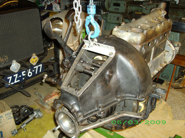

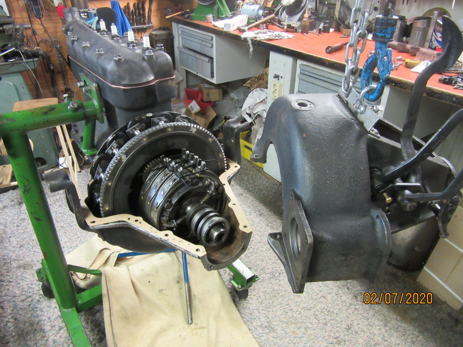

To mount the hogs head , I got some help of my hoist.

I'm with Don and Scott. I'd rather pull the engine and do the job out of the car. Anthonie's suggestion of a hoist is especially good with a cast iron hogshead.
- Posts: 5470
Re: Removing hogs head
Agreed - as we get a bit older, it's easier on the "old bod" to just remove the engine and you get a much better job at sealing up the trans. cover !
