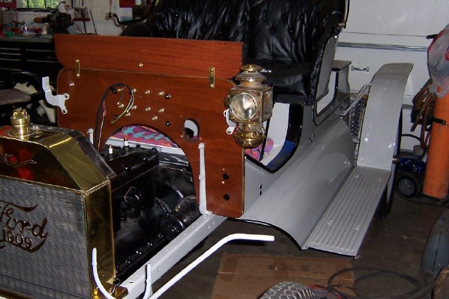

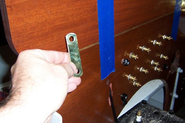

Like most antique auto restoration, parts, if not available, have to be improvised.
Did similar for the faux 09 roadster, took a reproduction later bracket with that bulge for the later rounded dash brass trim, and hammered it flat, then polish. Worked out OK for the project.

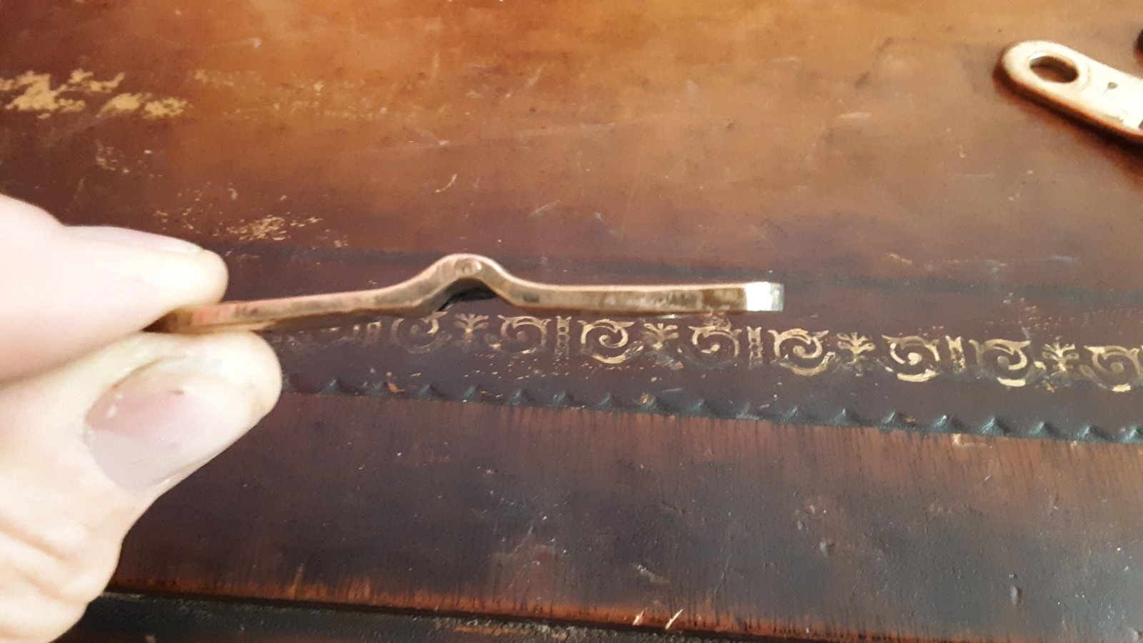

First of all, I would not hammer the bump flat! Ridiculous. I would put the bracket in a smooth jaw vise and squeeze the bump out. Second, by doing so you are going to expand the distance between centers, changing the hole spacing. Why not make new ones?

For those aghast of my modification of the later bump out brackets, remember I phrased the job was for the faux '09 I built! That means it was a fake '09, and so stated on a brass engraved plaque in the rear seat compartment. The frame was '20s, the engine was starter '23 and everything was between '09 and '27. Wood body and metal all reproduction.
There weren't repros of the correct brackets, so my fab was to modify.
Wanting it to look like an '09 which has the flat brass molding around the dash, flattening out the brackets was thing of the day :D
Should ever again build a '09, glad that R.V. will supply the factory correct brackets ;)

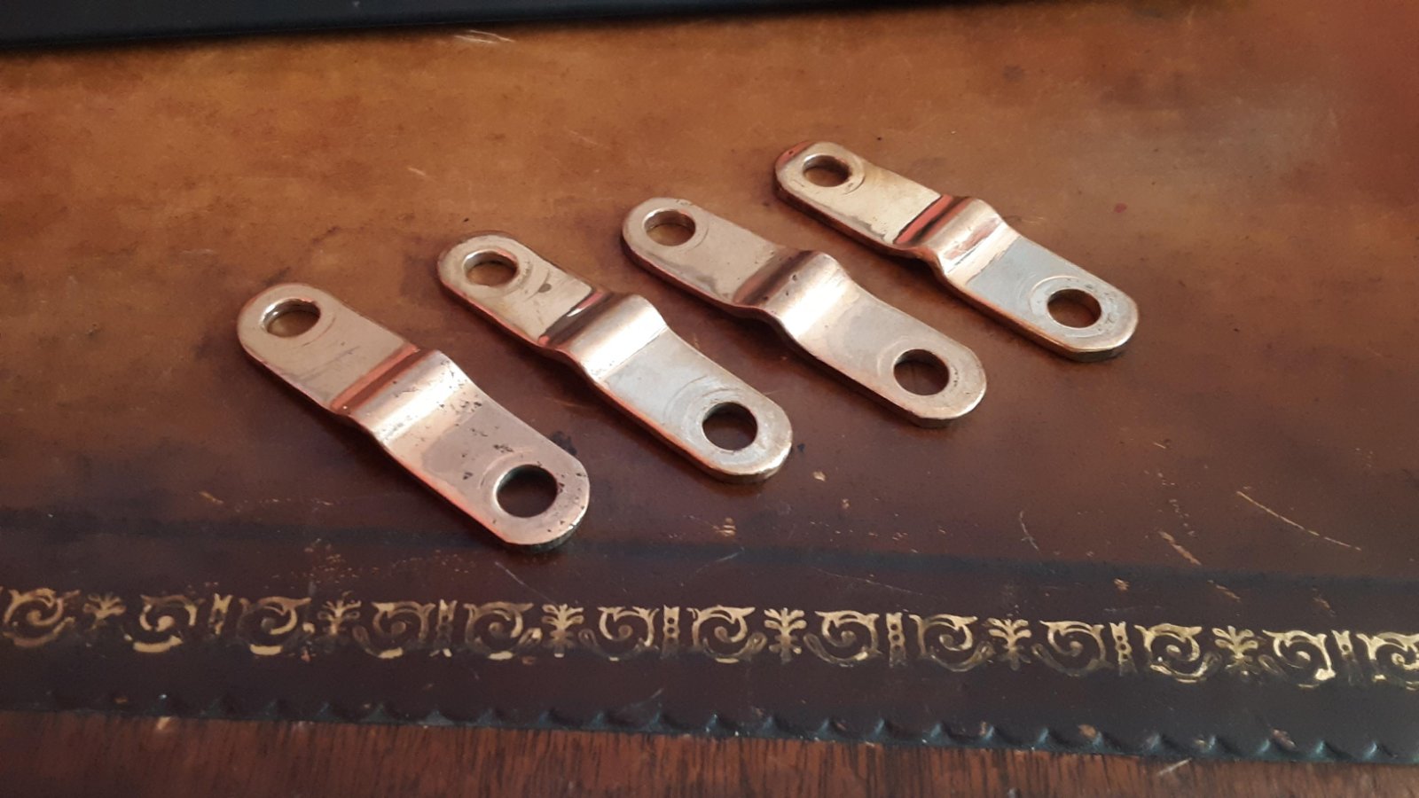

I too had an issue obtaining flat plates for my 1910. A local Brass and metal supplies laser cut and drilled 6 for me. The same
Company also bent the firewall brass trim for me.
