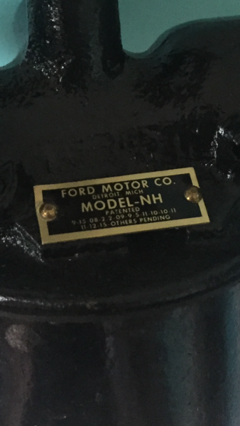

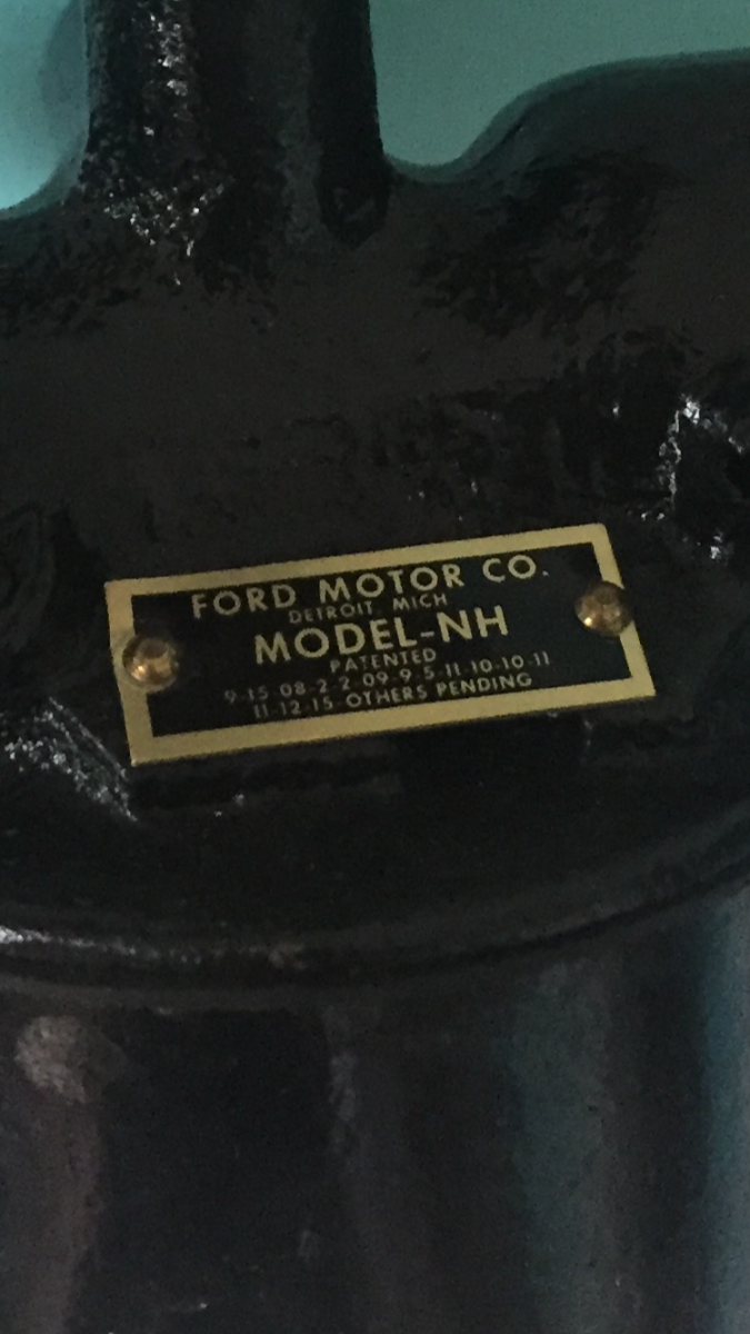

You sparked my curiosity! So, I tried to remove the tag rivets from a carburetor. I was able to get a small screw driver under the heads to pry, but the rivets just stretched a little and then the heads broke off. So, I drilled into them with a 1/16" drill bit and then a 5/64" drill bit, just using a Dewalt cordless drill. It appears that they are out. Now, the question is, what diameter should the hole be for the new rivets? I think I should have stopped with the 1/16" bit?
- Posts: 4642
Re: NH Holly Carburetor
For what it’s worth Lang’s sells the rivets 6200RIV for most 17-27 carburetors,
1/16” dia. X 3/16” long and have a oval head. So says Lang’s.
So if you have a 1/16” hole maybe a tap or two to put them in if the holes are not exactly that size and you didn’t wallow out the hole?

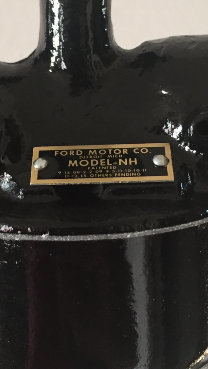

If purchase a new tag they always come with steel drive screws and they look funny. Chaffin’s has the brass ones you can purchase separately.
I’ve only tried to save the tag if it says Model F because the reproduce the other 2 styles. The straight through tags for the ones that have them are slightly different so you might save those.
Once I pry the tag off, I hit the rivets with a cold chisel so they are flush, then drill one with a 1/16” bit. Get the new or old tag and stick a 1/16” bit through the tag into the hole in the carburetor body. Then drill the other through the hole in the tag, it may be slightly off but that way the holes line up with the tag. Make sure they are deep enough because you can’t remove the new drive screw. Start the drive screws into the holes and the old spray nozzle is cupped and fits right over the heads, tap the brass part of it with a hammer to drive them in.
