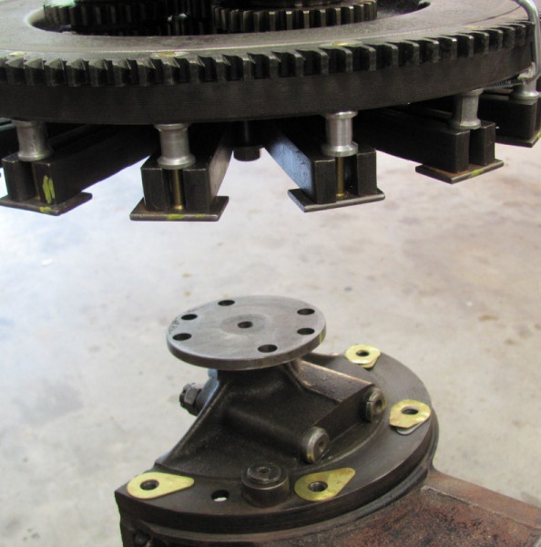

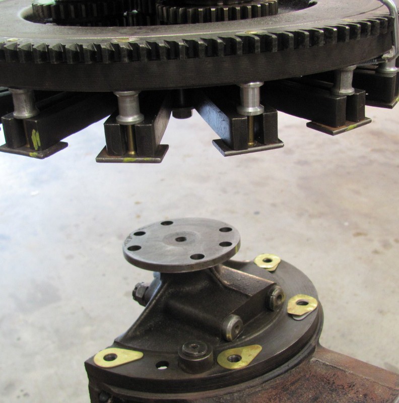

If your question was placing the trans/flywheel on the crankshaft during magneto gap maneuvers then YES, mark one of the flywheel dowel pins , there are two of them, and strive to lower the same two pins onto the same holes on the crank flange.
Reason.....if you keep putting the flywheel assembly on the same place, you are keeping the gap spaces obtained in the same relation to the interface of the crank flange and flywheel, although only little off, at least you are setting the gap to the same relationship of the crank flange and the flywheel.
Just can't quite see, but there is a white line on the edge of the flange to i.d. the singular mating dowel hole.
