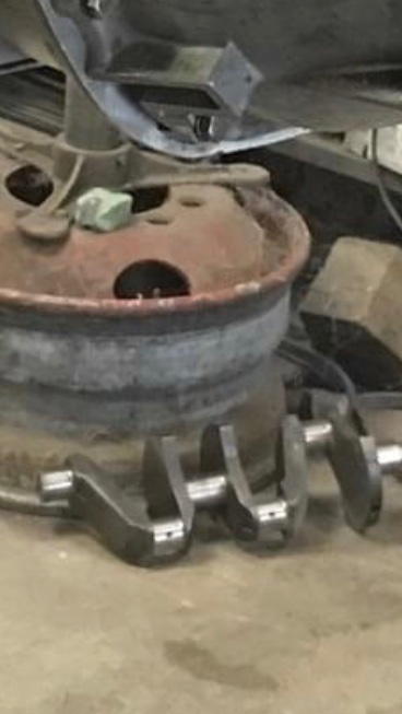

This was a pressure fed crank with less than 10 hours but 6500rpm
Reliability is in the eye of the beholder.
(Picture from Erik Barrett)
