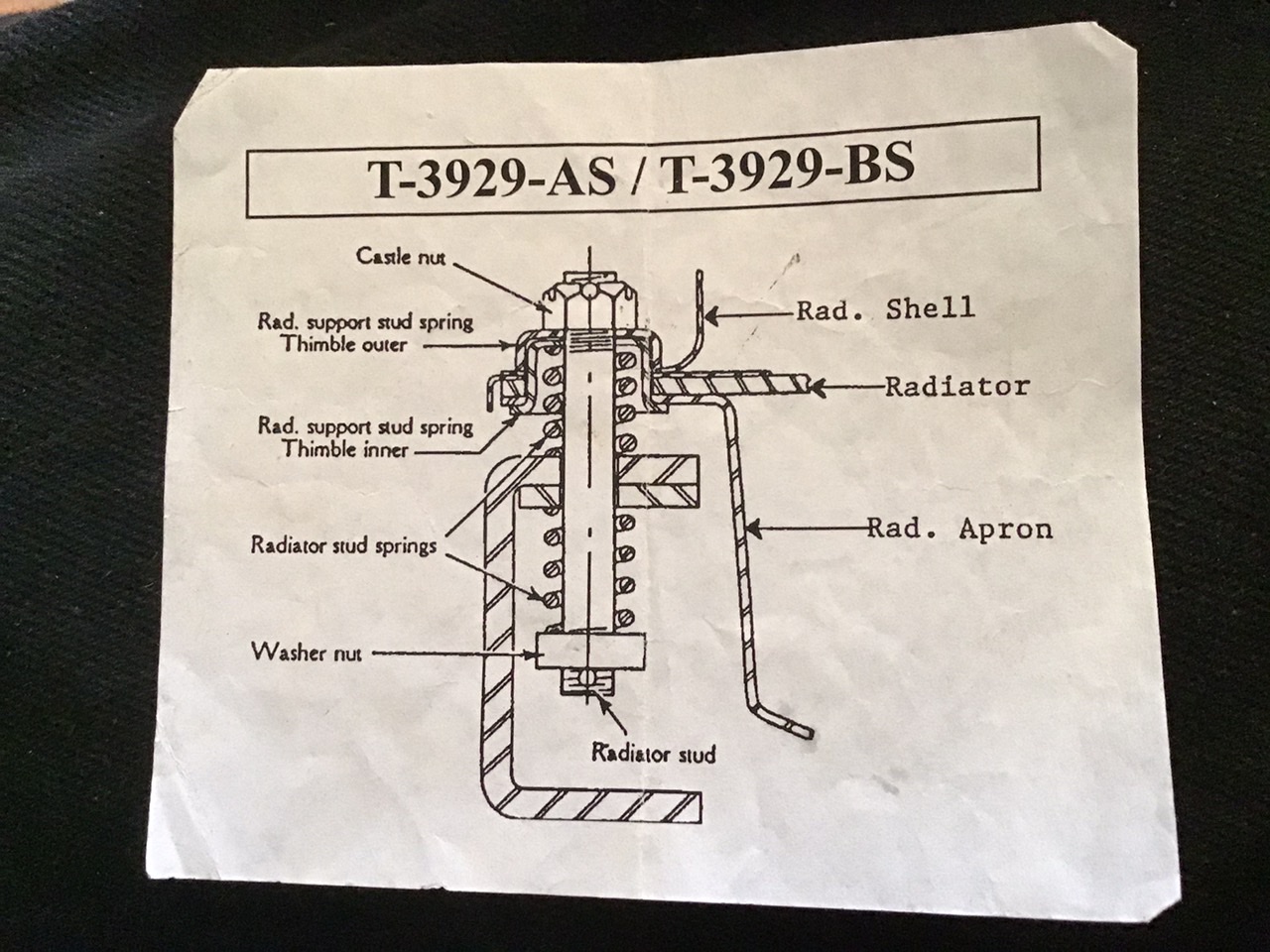

Larry, what do the leather pads do when fitting a 23 radiator? I thought the radiator mountings were supported on the two springs and the thimbles. Have I got it wrong?

Post by John kuehn » Fri Jul 17, 2020 8:24 pm
Here is a drawing I got several years ago from the radiator stud kit for my 24 Coupe. Bought it from from one of the vendors. I was thinking the pads were used up to 1919 then discontinued. May be wrong and not sure. Anyway the drawing gives you an idea of the sequence for the pieces.

Post by Norman Kling » Fri Jul 17, 2020 9:19 pm
looking at the diagram posted by John, the way I do it is to put all the springs and thimbles on with the nuts but without the radiator. Then I tighten it down until the spring under the frame rail compresses. I then put something thick enough to hold the spring in the compressed position. You can use a small block of wood or a metal bar, anything which will fit there and also be easy to remove later.
Then I remove the upper nut and thimble and place the radiator over the lower thimble. At this time you can install the upper hose. Then place the upper thimble and nut and tighten up. Now you can remove the block under the frame rail. Place the support rod and put the hood in place. At this time you can do the final adjustments on the springs and the length of the rod so the hood fits correctly Then place the hose clamps and install the pipe and two short hoses at the bottom. Be sure that cotter pins are in the nuts both on top and under the stud.
