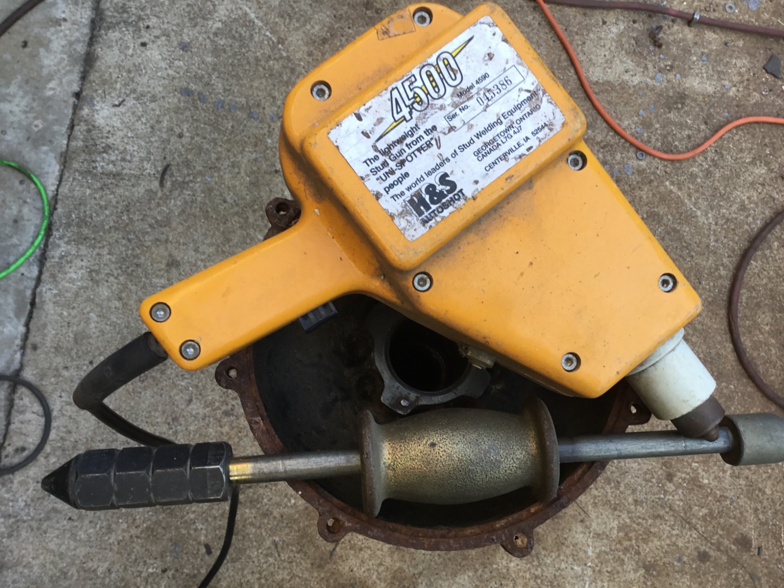

Easy pin removal
BobShirleyAtlantaTx
Topic author - Posts: 361
- Joined: Mon Jan 07, 2019 12:44 am
- First Name: Bob
- Last Name: Shirley
- Location: Atlanta Tx
Easy pin removal

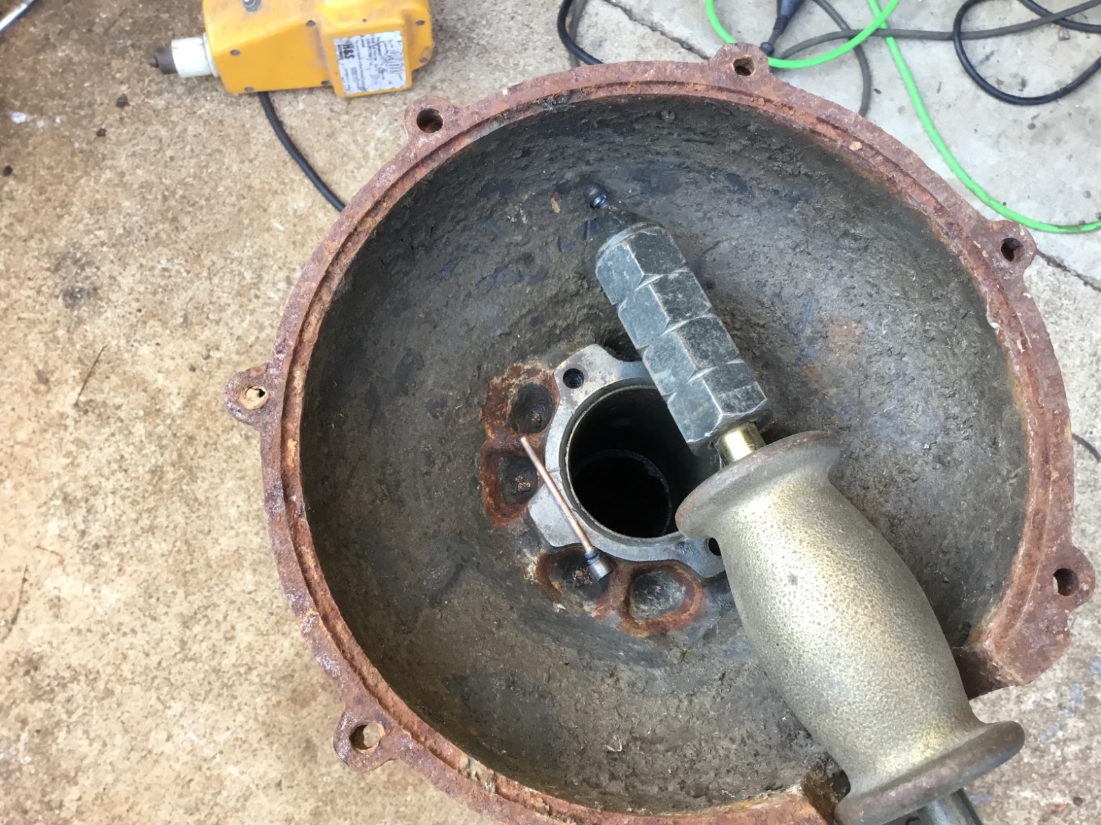

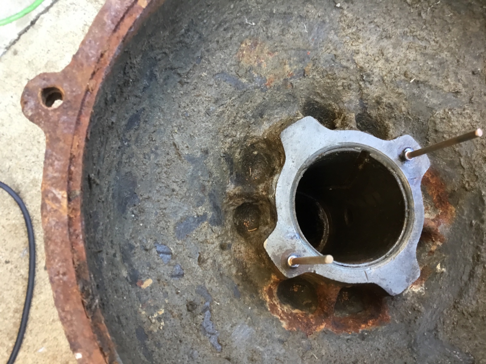

f[attachment=0]image.jpg A pin dent tool is the easiest, least destructive way I have ever used to get the little pins out. Almost every body shop has one and I bet they would help you out, just for the bragging rights. Around here the pin tools are around $100 at pawn shops. Harbor Freight has them and the pins.
