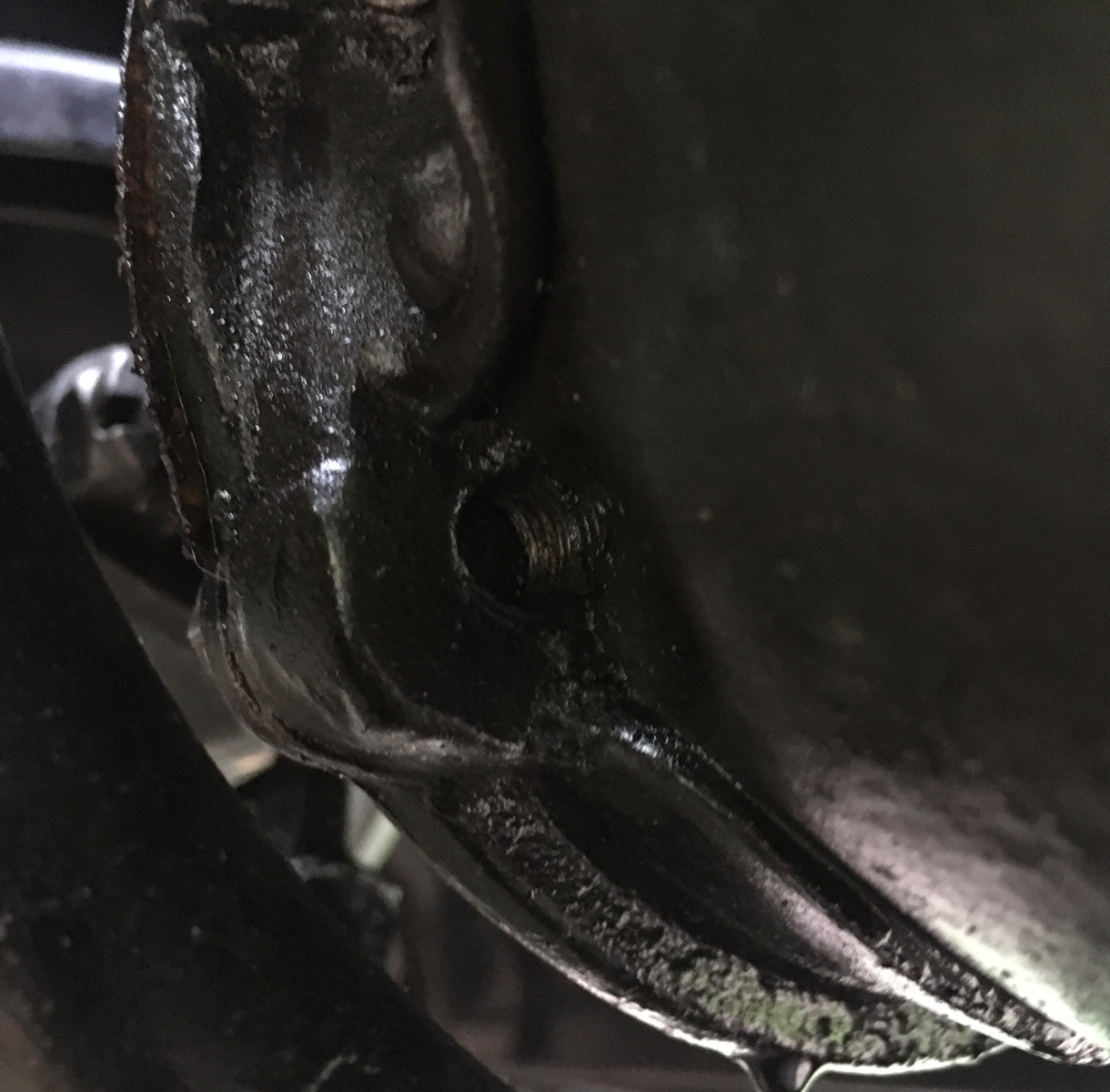

So I just got my first T a couple days ago (very excited!), and I’ve been tinkering with her ever since. I sent in $40 to MTFCA for my membership, and I sent out an email to join my local club. Anyways, I took the battery out to trickle charge it, and when I went to put it back in I realized the previous owners had it set up for positive ground (the positive lead off the battery went to a cable that bolted into the frame). I ran out of time to hook things back up as the cable clamps were seized in the wrong size and I had to cut things short and go to work. I’m guessing a new battery is in order. The car didn’t like running at idle on magneto with the battery reversed, I haven’t tried running it yet with the battery hooked up negative ground which is what it should be. I’ll post an update in this topic tomorrow when I have time to hook up the battery correctly and try to run off magneto.
So I guess my question would be, do you think the battery being reversed would cause any damage to the magneto/magnets? Would it make a difference hooked up properly running on magneto at idle?
Also, where could I find some gits oil caps for the suspension, my T is missing a few gits oil caps on the suspension.
Thanks for any help in advance 🔧🤗

There are several Model T parts suppliers, who will have things like the caps. You might find that that will be the least of your worries, once you get into the car some more... :)
The magneto and battery systems are completely separate, so you won't have any issues with the magneto because of the battery connection being backwards. It will have it's own set of problems

Brendan, welcome to the hobby. You're in for quite a ride in more ways than one :D What Jerry said about avoiding any contact between the magneto and the battery is really good advice. You can easily demagnitize the magnets, rendering your magneto useless. If you think your magneto is weak, there are ways to regenerate the magnets without removing the engine from the car.
You didn't give any details about your Model T (year, body style, etc.) which is always helpful when you're asking for advice. You also didn't mention whether you had a 6 or 12 volt battery. I've attached an electrical schematic that should provide some insights. You will note that the battery has a negative ground.
As to the gits... I'm not a purist and my goal has been to produce a safe touring car, not a show piece. I replaced the oil cups with grease zerks to allow for more efficient lubrication (at least in my view.) You can even buy grease cups that have a zerk hidden inside or you can modify them to accept zerks yourself.
This forum is a wonderful source of information. Most topics have been discussed many times before. If you pose your questions to google you will find that it will bring up threads from both the current and previous forums. After you've done your research don't hesitate to ask your questions.

oldav8tor, I just wanted the gits oil caps so no dirt or rocks get inside the tiny holes where they should be.

I found this site selling gits caps, what kind of threads do the caps use on the T?
https://www.gitsmfg.com/catalog/oil-hole-covers/

I would go to www.texastparts.com and on left go to free downloads. There you will find an excellent wiring diagram. Use it along with the one that Tim posted. It will help.

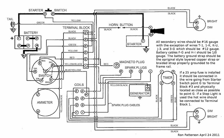

Since you say the wiring is original, I would recommend you purchase all new wiring. You may have to buy from different vendors to get all the sets. Do not order online. Speak to someone and then you will know what is available and what is on backorder. You might have to ask here on the forum if you cannot find the set you need. Do not forget to include a fuse.
I use the oil caps with the zerk inside. Makes life easier and looks authentic. Your call. Do not forget there are 2 on the driveshaft.

I got a wiring diagram and a complete wiring kit from Lang’s, it arrived today!

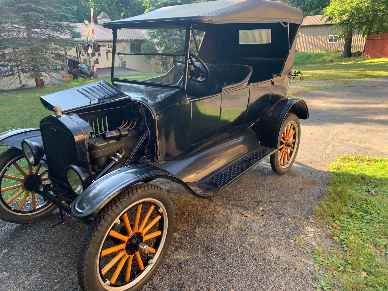

Attached is a picture of the car. Engine #6,484,060

A very nice looking Touring!!!

That car looks like a 23. It has a slant windshield and one man top. The change came somewhere toward the end of the year 1922. I have seen cars with a straight windshield called a 23 and some with a slant windshield called a 22. The year model was introduced in the fall for next year, but sometimes the cars were dated from the date forst sold so you will find 22's which were first sold in 23, and 23's which were first sold in the fall of 22.
Concerning the battery. You can install the battery with a negative ground but be sure the generator puts out a positive charge. Sometimes the polarity of the generator can be reversed, and a Model A cutout will still work on a reversed polarity generator and battery. Also you might need to reverse the leads on the ammeter.
Concerning the magneto. First check the output of the magneto. It should have at least 6volts AC at idle with the voltage increasing with engine speed. Also check the coils. Some coils will run OK on battery but not so well on magneto. You might also try a different setting of the spark lever. Sometimes if the coils are not in correct adjustment, you could have a flat spot. If you slightly retard or advance the lever it will smooth out. With all that said, I would first check the timer and the coils and even the spark plugs before you go into the engine to fix the magneto. You might find it will work fine if everything is in good condition. If not, you can run on battery until you are ready to pull the engine for other reasons and fix everything at one time.
Your car looks very good.

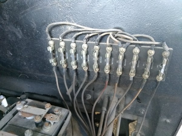

FUSE HOLDER LOCATION
Post by Novice » Tue Jul 21, 2020 5:00 pm
Install black in line fuse holder at or near fire wall electrical block. insert in the power wire going from terminal block to the foot switch battery side post. This gives easy access without crawling under the car to check or replace fuse. and a convenient place to disconnect power if You are working on the car. and the chance of a short in the heavy gauge three foot wire going between the terminal block to foot switch are slim and none. some folks don't use fuses since Henry didn't. I didn't either until first night I had the car turned on the headlight's and sparks flew out of the ignition switch could have started a fire but managed to turn switch back to off position and sparks stopped. But it got my attention! some use a fuse block and fuse several circuits others fuse everything with ten fuses like the modern cars do but I don't think that is needed the one fuse will protect in most situations. be sure electrical block screws are tight but not too tight are You will strip them out. If loose terminal will can get hot and fry wire end and discolor terminal lug. Don't fix it if it aint broke and then one item at a time so You don;t wind up with several alligators biting Your BUTT at the same time.
My 2 cents worth maybe less.

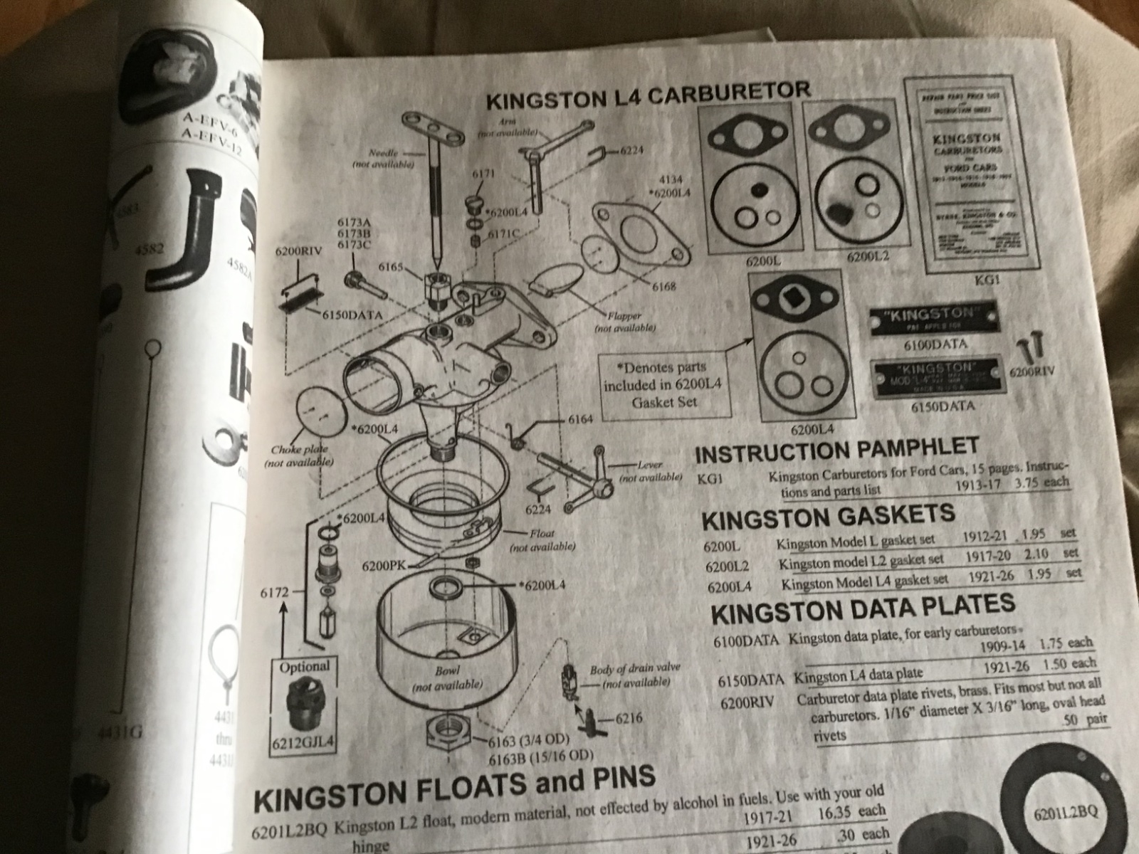

I also turned the nuts on the bottom of my Kingston L4 carb and now the engine is backfiring. I thought the carb was flooded and I tried to drain it after removing the fuel line and the nuts just kept turning. What does the big nut and little but do on the bottom of the carb? I read the MTFCA book about the carbs and I can’t seem to find out about the little nut on the Kingston carb.

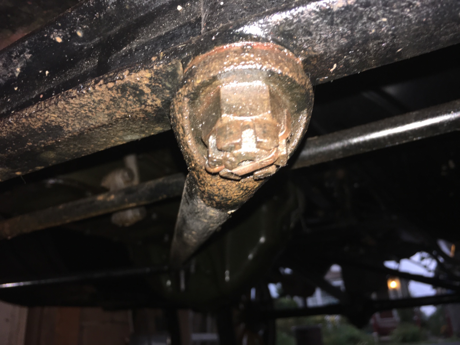

I’m also missing a bolt under my engine, which specific bolt do I replace it with?
Having trouble uploading pictures. :/ I’ll try and get some uploaded soon.

Here’s an exploded view of a Kingston L4. It may give you an idea of what the parts are for. Click on the pic for larger clear view. It’s from Lang’s catalog.

She still runs and drives fine, just sputters at idle and higher revs. Guessing it’s an electrical issue.

The bolt that’s missing is exactly the same kind that’s right above it. Not trying to be a smart ***** but the bolt is a fine thread like most of the other engine pan bolts. That paticular one is an all thread 3/8 24 x 1 1/2“ length but not exactly sure about the length.
Be sure when you replace it and be careful not to cross thread or strip out the threads that are in the pan that it screws into. The pan bolt holes can be stripped when putting the engine and drive shaft together if they aren’t lined up correctly.

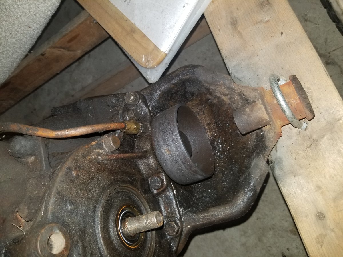

The "small" bolt on your Kingston SHOULD be a drain petcock - the large nut holds the bowl on.

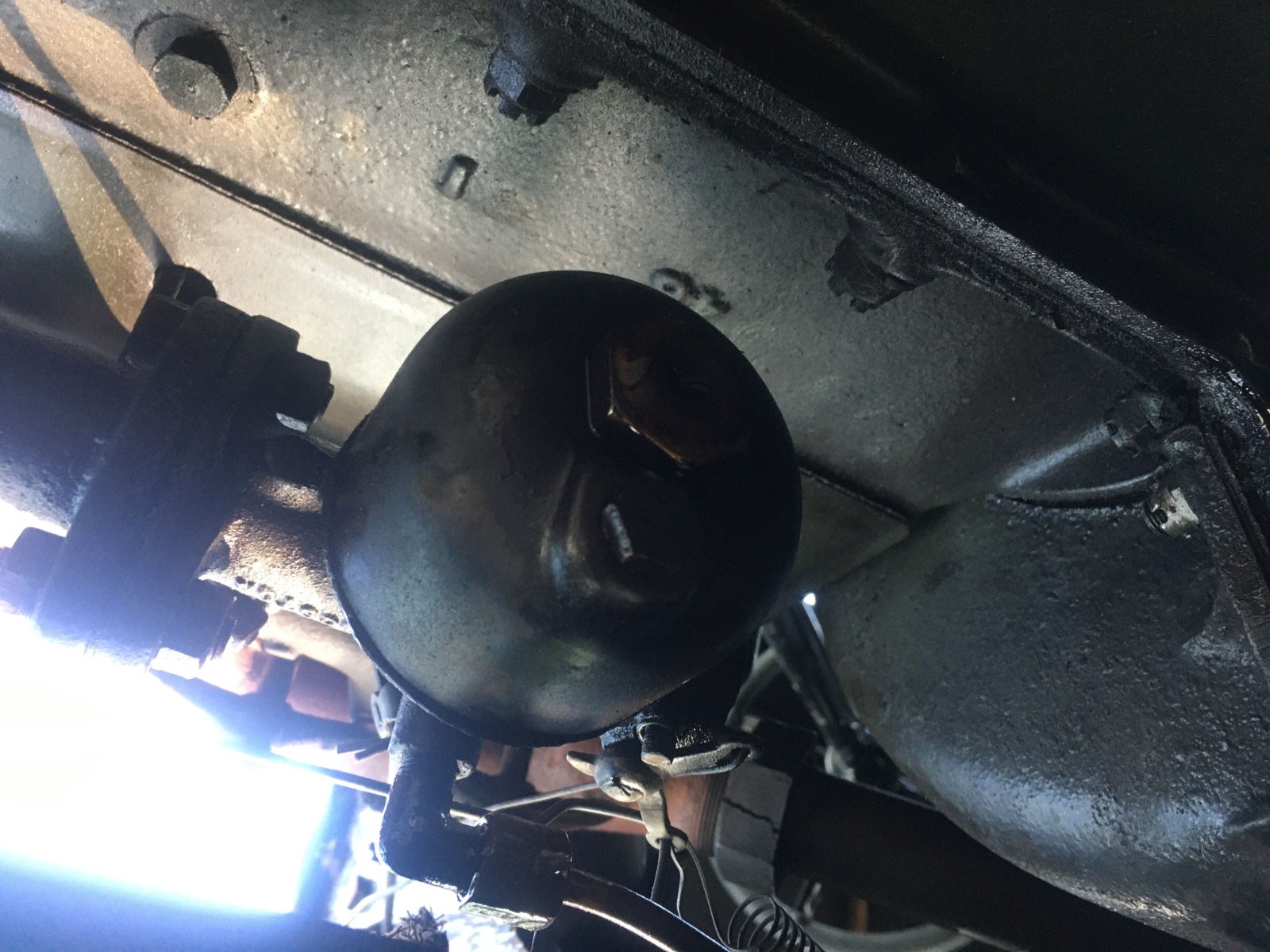

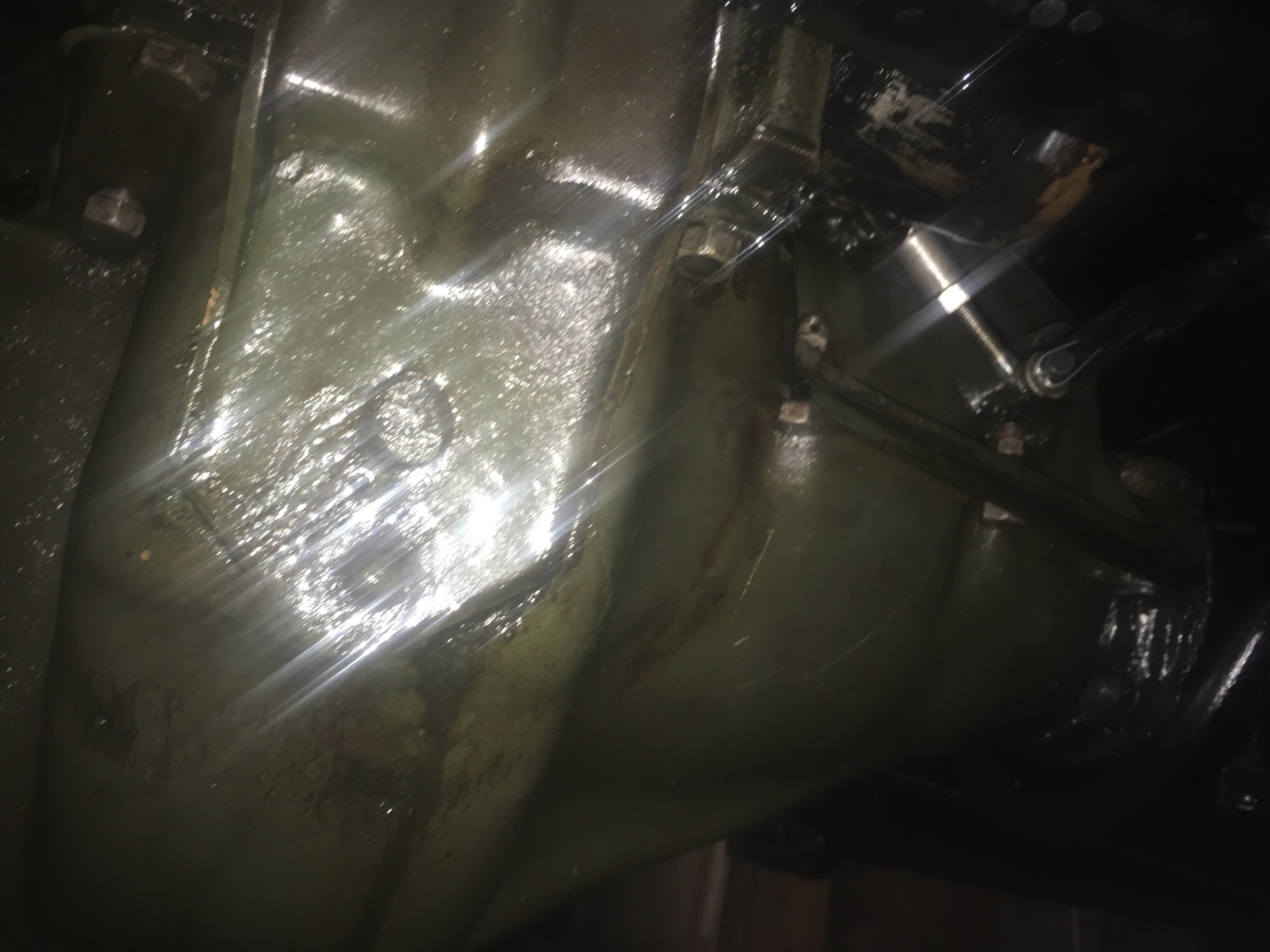

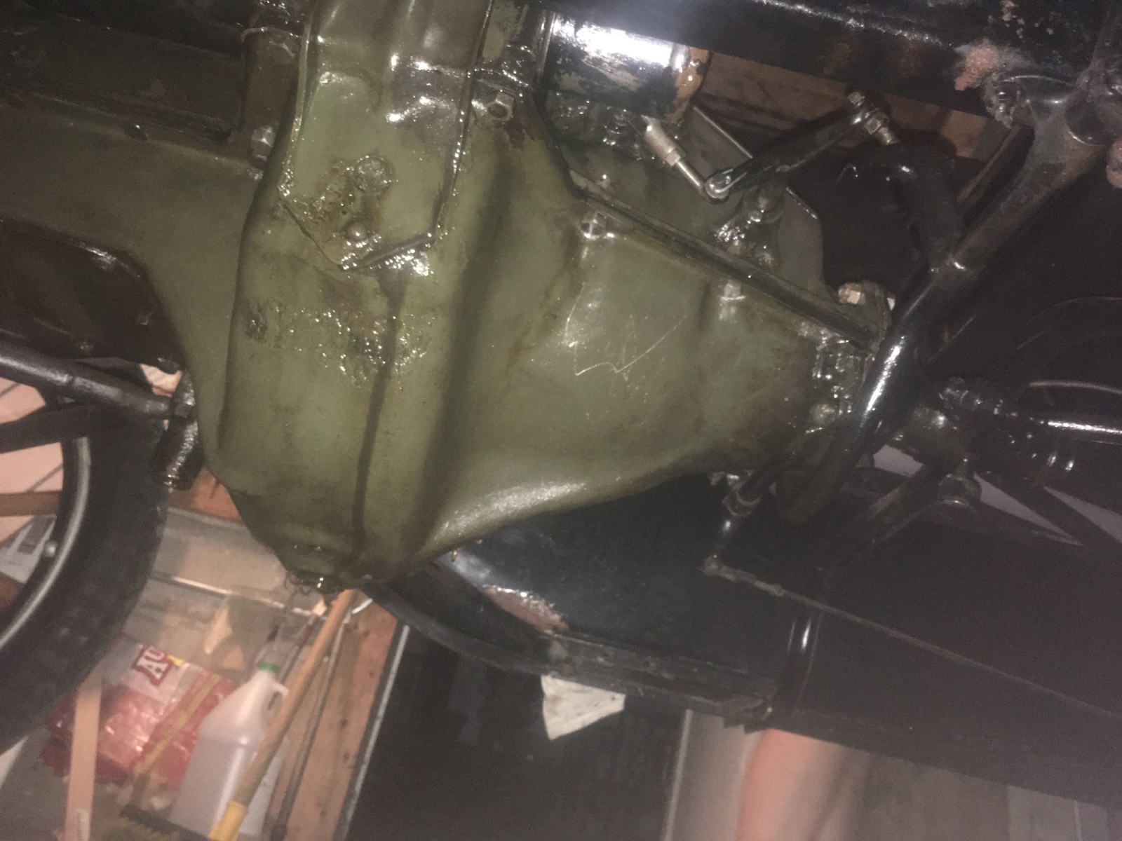

You are NOT missing a bolt. I can see the the edge of the bolt head. What you photographed is a bolt hole that goes all the way through the flange. The bolt is installed from the backside and simply does not go all the way through.
I know you're excited about your car and that's really great, but slow down a bit and tackle one thing at a time!

Post by Oldav8tor » Tue Jul 21, 2020 9:21 pm

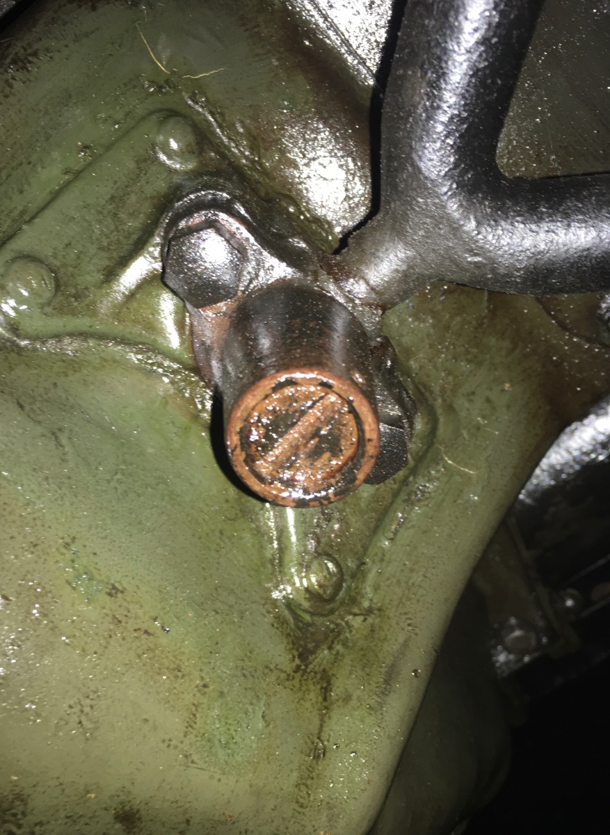

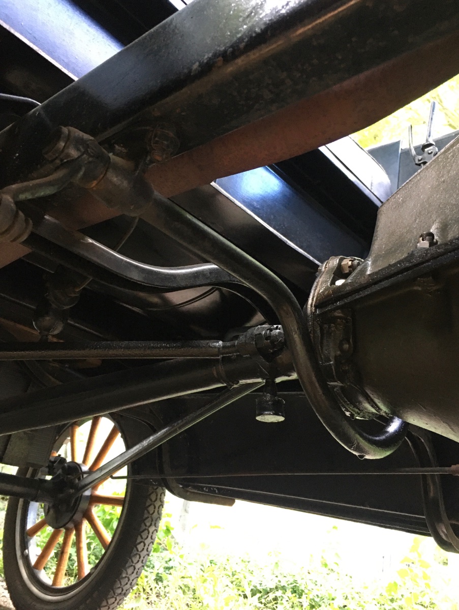

Looking at one of your photos it looks like the big grease cup on the drive shaft where the ball of the shaft tube meets the transmission hangs down which is opposite the way Ford did it. Some guys did this so they could access the grease cups without taking the floor boards up, but it does create a potential problem. If you flip the tube you need to remove a little material from the mouth of the ball or there may be some interference. Others can explain it better and it was discussed on the forum not that long ago. Hopefully the person who flipped it was aware of the issue and took care of it.
I don't see the smaller grease cup at all. It greases the bushing that the driveshaft runs thru. If it is missing you might want to replace it. More pictures would tell the story better.
If you remove the timer cover (you can leave the wires attached) and take a photo of the inside and another of the brush it will tell us what you've got. I have a New Day and it should not be oiled or greased. Some timers you do, some you don't. Timer problems can lead to sputtering and the like as can faulty coils, etc., etc.

Post by RajoRacer » Wed Jul 22, 2020 10:53 am
The grease cup pointing down IS the d.s. bushing greaser albeit a large one - can't see the u.j. grease cup.

Post by Its_Always_T_Time » Wed Jul 22, 2020 11:41 am
I only see one grease cup near there, I’ll take more pictures of it after work when I get home.

Some folks use grease cups with Zerks inside so they can use a grease gun. I haven't done that with the small cups because using them as designed is no problem for me. The giant u-joint cup is another story. Arthur Itis told me to put a Zerk in that one. :D

But the big one for the u-joint....I replaced that with one with a hidden grease zerk in it because of the volume of grease involved. It still looks stock on the outside but it's way easier to use.

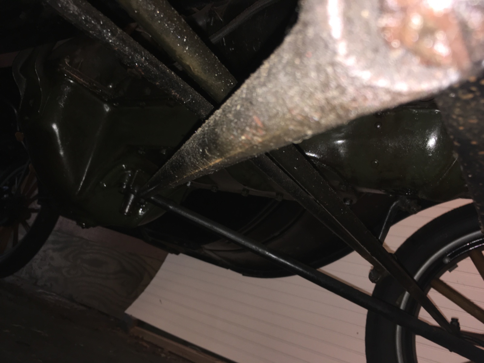

Post by Oldav8tor » Wed Jul 22, 2020 3:38 pm
Not only should the cap on the ball of the wishbone be safety wired, the ball itself should not be loose in it's socket. They make shims for it but sometimes if it is badly worn, you may need to replace the ball and maybe the socket that is attached to the oil pan. Another subject to google :-)
If you're going to go thru the rear end then you'll be pulling the driveshaft at the same time. You'll want to look at the condition of all the moving parts. On mine, I replaced the driveshaft (it was scored) the brass bushing (mine was babbitt) the pinion bearing (with a new, modern pinion bearing from Birdhaven - strongly recommended) both axles (again, they were scored) changed to a 10-tooth pinion gear, replaced the outer hyatt bearings with floating safety hubs (won't lose a wheel if the axle breaks....less likely to break an axle) and added disc brakes for better stopping power. Whew.... Originally I just wanted to see if I had brass thrust washers but one thing led to another....... At least I know what I've got and can trust it.

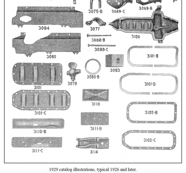

Re: Just Got My First T, Need Some Advice
Post by Steve Jelf » Thu Jul 23, 2020 9:53 am

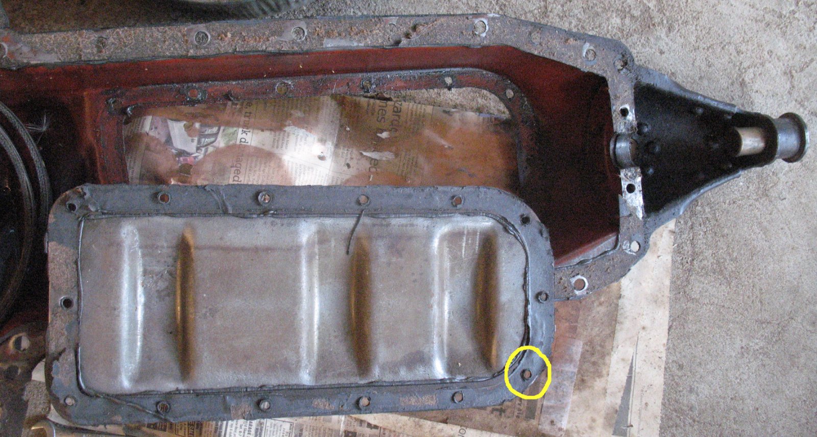

I think that would be #3101, officially called the crank case lower cover. It bolts onto the bottom of the pan.

Post by Its_Always_T_Time » Thu Jul 23, 2020 9:57 am
Thank you! I’ll unbolt that one front right bolt and wait for oil to flow out, if none does I’ll have to blow out the oil line.

Post by John Codman » Thu Jul 23, 2020 10:26 am
The photo of the wishbone attachment to the engine scares me. Those are bolts that could unscrew themselves from the engine. It is possible that someone has put Loc-tite (thread locker) on the capscrew threads, but there's a reason why Henry made the T with studs and castellated nuts. When installed as Ford intended the wishbone cannot come loose from the engine; as it is installed in your photo, it can. Ask me how I know...

Post by Dallas Landers » Thu Jul 23, 2020 12:06 pm
Re crankcase cover would be 3100 re Steve's chart. Right front bolt on that should be where oil comes out. 3101 is inspection cover.

As for the wishbone fastenings, how should I replace what fastens it to the motor.
Post by Steve Jelf » Thu Jul 23, 2020 3:47 pm
After reading that I had to take a look at the VF piece Brendan mentioned. It's in the May/June 2020 issue, and is an article written by Murray Fahnestock in 1918 and updated this year by Mike Vaughn. Fahnestock refers to the crankcase cover plate. I believe this is #3101, which the Ford book calls the crank case lower cover. Ford calls the engine pan (#3100) simply the crank case. If you look at the right front bolt on the engine pan (crank case) you see that it's just one of the bolts attaching the pan to the block with a castle nut. There's no way that oil could get to it.

Post by Dallas Landers » Thu Jul 23, 2020 4:59 pm
Which bolt should oil come out of if removed ?
Posts: 7411
Post by Steve Jelf » Thu Jul 23, 2020 5:49 pm
I believe it would be this one down on the bottom. The oil tube empties in that vicinity.
Its_Always_T_Time
Posts: 129
Joined: Tue May 19, 2020 5:25 pm
First Name: Brendan
Last Name: Patterson
* REQUIRED* Type and Year of Model Ts owned: 1922 Touring
Location: City Island, Bronx, NY
Post by Its_Always_T_Time » Thu Jul 23, 2020 6:23 pm
You guys are amazing. I’m in the garage with Lizzie and I’m going to loosen that bolt right now! Just adjusted the low output intermittent spark coil to ~1.3amp and much better spark, if oil comes out of that bolt hole when the engine is running I’m going to install the oil screen and change the oil!
The Little Ford Will Ramble Right Along!
22 Touring
Its_Always_T_Time
Posts: 129
First Name: Brendan
Post by Its_Always_T_Time » Thu Jul 23, 2020 7:01 pm
OIL LINE IS NOT CLOGGED! HOORAY!🔧🤗

I replaced the cracked pack nut, and with the adjusted coils and fixed exhaust leak, the engine no longer misses! Hooray!
Now there seems to be a large leak of oil coming out of the left side of the hogshead where the upper and lower halves meet just below the pedals. It doesn’t seem to be from the pedals. Hmmm...🤔

Post by Its_Always_T_Time » Thu Jul 23, 2020 10:43 pm
I think I‘ll tighten all the bolts on the hogshead starting from the center and work my way out. Looks like it’s coming out of the bolt near the engine. 🔧🤗
22 Touring
Posts: 7411
Post by Steve Jelf » Fri Jul 24, 2020 1:12 am
I haven't tried it, but I've read about this cure for a leak between the hogshead and the pan.
1 Wash the leaking crack thoroughly with lacquer thinner. You want it to get into the crack, not just on the outside.
2 Run a bead of Ultra Black along the crack and squeeze it in with your finger.
3 Add another small bead along the crack.
4 Hook up a shop vac to the oil intake and suck the Ultra Black into the crack. Be careful to suck only air, not oil.
Maybe somebody who has actually done this can tell us how it worked.
Its_Always_T_Time
Posts: 129
First Name: Brendan
Post by Its_Always_T_Time » Fri Jul 24, 2020 7:51 am
I don’t see any cracks on the hogshead, just looks like she’s leaking near the bolt by the engine. I’ll see how that fix works.
22 Touring
Posts: 4472
Post by Jerry VanOoteghem » Fri Jul 24, 2020 9:42 am
I don't think he means "crack", as in a fracture. I think he's just referring to a gap between the pan and hogshead where the gasket may be bad.
However, there is the possibility of there being a crack, (as in fracture), in the pan, where the motor mount bracket attaches. That's not so uncommon and will cause a stream of oil like you're getting. Clean up the whole area really well, then run the engine while looking to see where the oil begins to emerge.
Posts: 7411
Post by Steve Jelf » Fri Jul 24, 2020 10:28 am
I wasn't thinking of an actual crack in the hogshead. I was thinking of a leak between the hogshead and the pan. Maybe I should have called it a gap or an opening.
