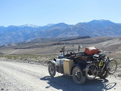

An Englishman named Tim Moore did it a couple of years ago. Here are some links to get you going.
http://www.mtfca.com/discus/messages/70 ... 1498858636
http://www.mtfca.com/discus/messages/70 ... 1500331120
http://www.mtfca.com/discus/messages/70 ... 1501470613
http://www.mtfca.com/discus/messages/70 ... 1502848538
http://www.mtfca.com/discus/messages/70 ... 1503721068
http://www.mtfca.com/discus/messages/70 ... 1505322904
http://www.mtfca.com/discus/messages/70 ... 1505392537

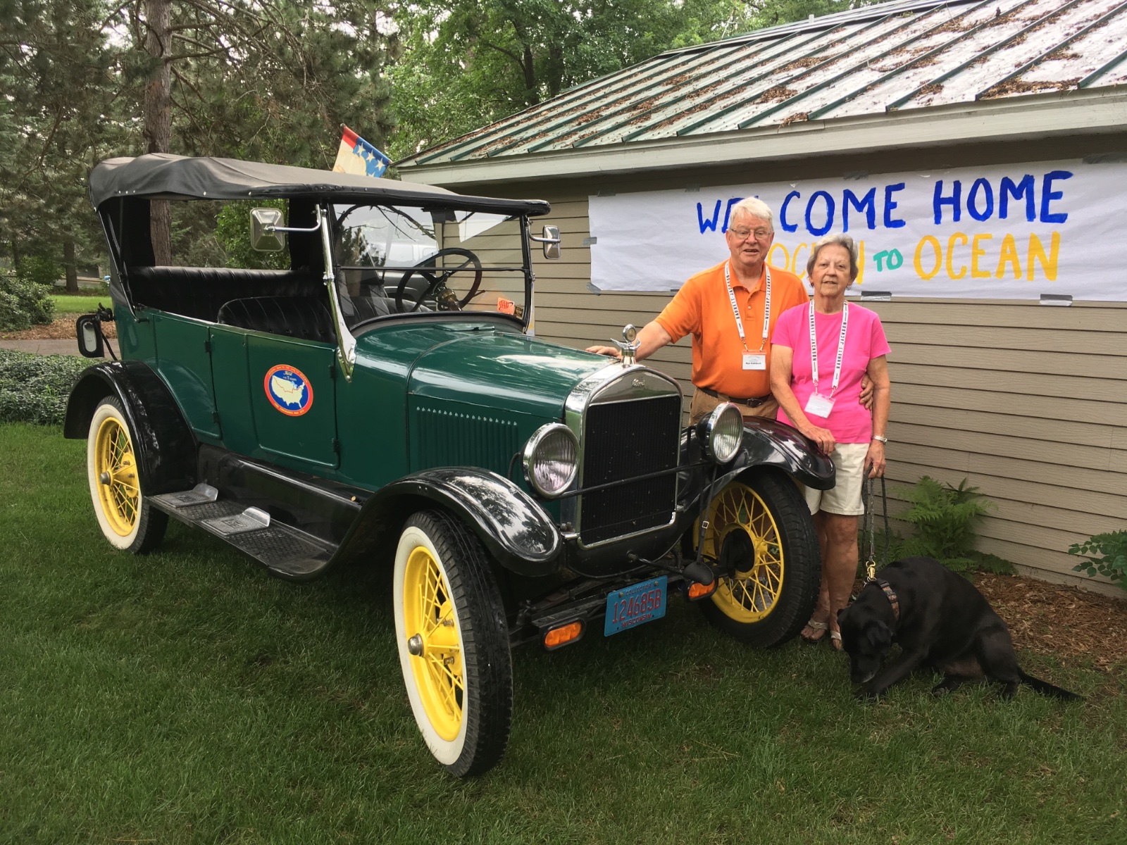

We drove our 26 Touring on the 2019 Ocean to Ocean Trip. We were on the road 29 days driving 3 days with the 4th day off for maintenance and rest. Our lay over in Dearborn, MI was 3 nights. My GPS recorded 4083 miles total almost all secondary roads with less than 30 miles of Interstate and 1.5 miles of pasture. Morris Dillow and John Griesenbeck planned and ran the trip as close to the 1909 route as possible. They did an excellent job.
I knew my wife and I would be 80 when we made the trip so spent I a lot of time on the car to avoid all the problems I could on the trip. The following is a list of the major items completed approximately 2000 miles before hand.
6 New Coker Firestone tires and tubes
Bosh distributor and Pertronix Electronic Ignition
All new timken bearings (no Hyatt bearings any where)
KC Warford
New Berg flat tube radiator
Scat crank
Stipe 290 cam
Prus head
Texas T water pump and 160 degree thermostat
12 volt alternator
12 volt led signal and brake lights
The car ran great and except for the original muffler coming apart I had no failures or adjustments.
I took 2 spare tires and never used them. The front still look new, but the rear show some wear.
It was the trip our life time and like all Model T Tours we met great people.
If I can provide additional information my email is ronffish@gmail.com.
