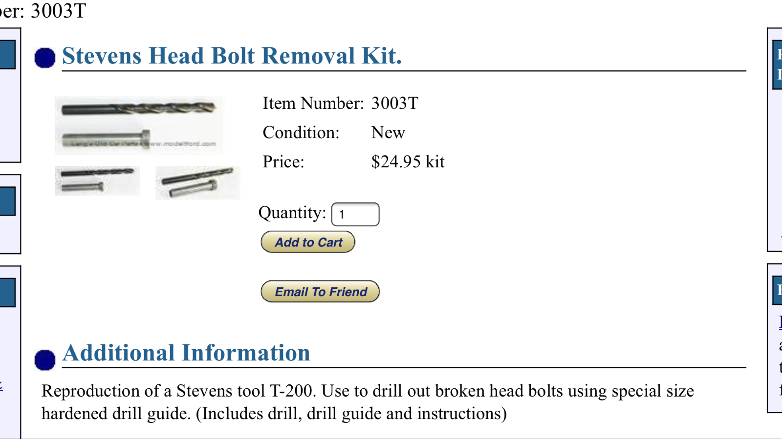

Had that happen to me. Bolt broke at the block, top half stuck in the head, bottom half stuck in the block, bolt sheared flush with top of block. Head was the easy part, heated it up, applied candle wax, and the broken bolt poped out with one gentle tap. The bolt frozen in the block was the real problem, no protruding stub to weld to... Well I found a Stevens T-200 drill bushing and drill bit and using the head as a jig, inserted the bushing and drilled it out with a special size drill. All that was left was a little coil of metal on the threads which came out by chasing the threads with a regular tap. I liked it so much I reproduced it and it is available through Langs and Snyders. Also have a different size for Model A available through Snyders.

Thank you for your post and your contribution to the hobby. I haven’t had the need (yet), but it is good to know that (1) there was a period tool for this specific problem, of course, and (2) a dedicated enthusiast is making them available again. I checked the Lang’s website and your tool is reasonably priced (probably much less than the damage I could inflict trying to wing it). Hopefully, I’ll remember the answer if (when) the situation presents itself.

This is the tool in the Lang’s catalog
