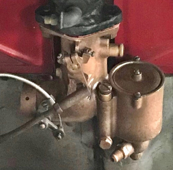

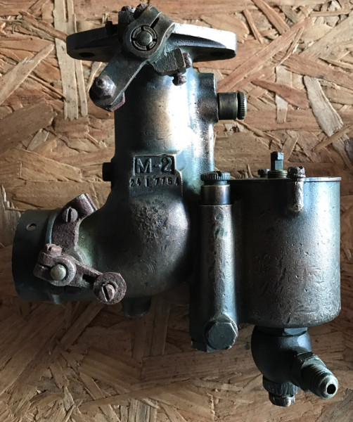

I used vinegar..
Before cleaning
Before cleaning
After cleaning
After cleaning
After cleaning, blow it out and wipe it down good to clean off any loose gunk, then reclean again to get the best result.
I then clear coated it to try and extend the life.

PDGx wrote:
Tue Jul 21, 2020 11:14 pm
I used vinegar..
(Pix removed to save space)
I gotta try this.
