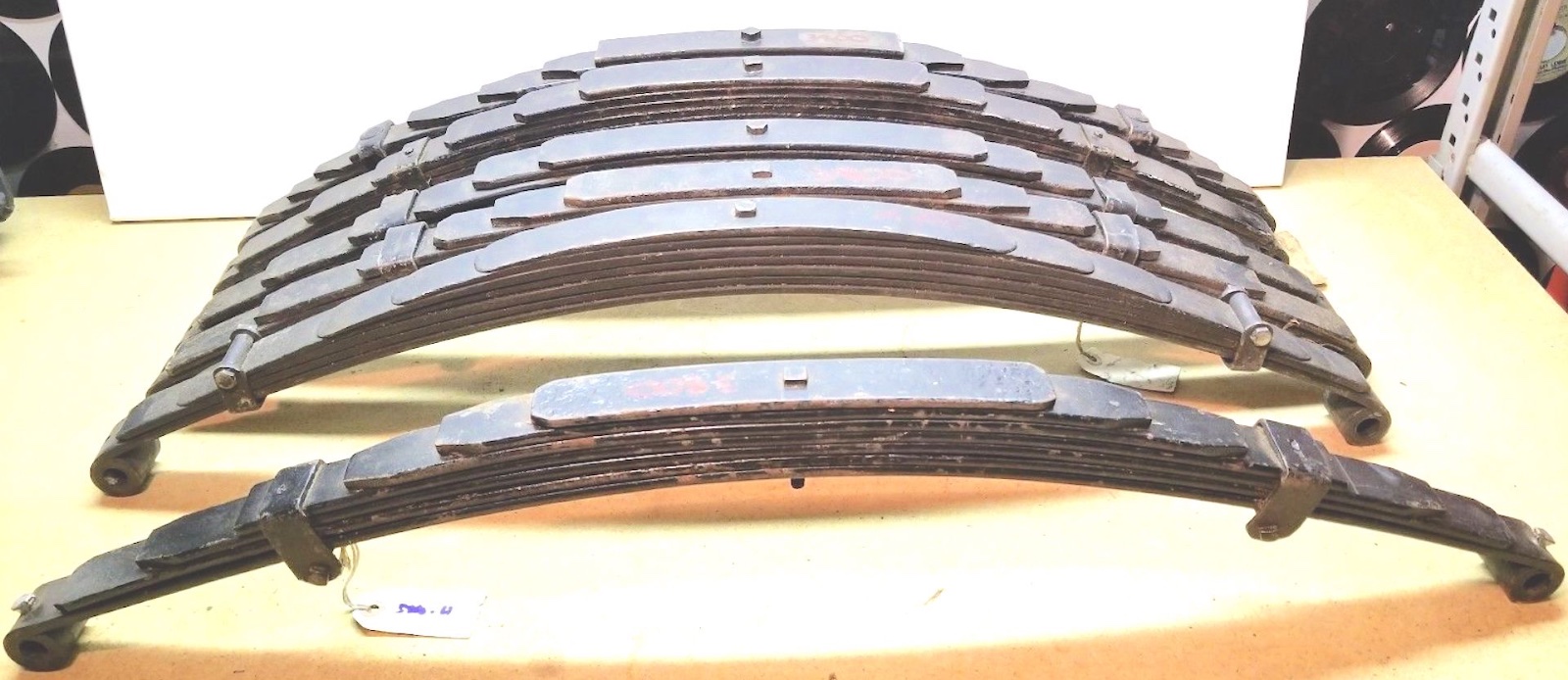

This photo compares some various from Model T springs, and the second in line from the front is a typical taper leaf front, you can see the top leaf is longer than later clipped end top leaf that are short about 9 3/4" long.
Click on photo to enlarge
