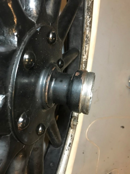

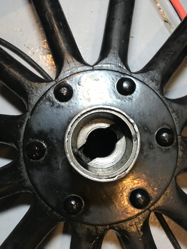

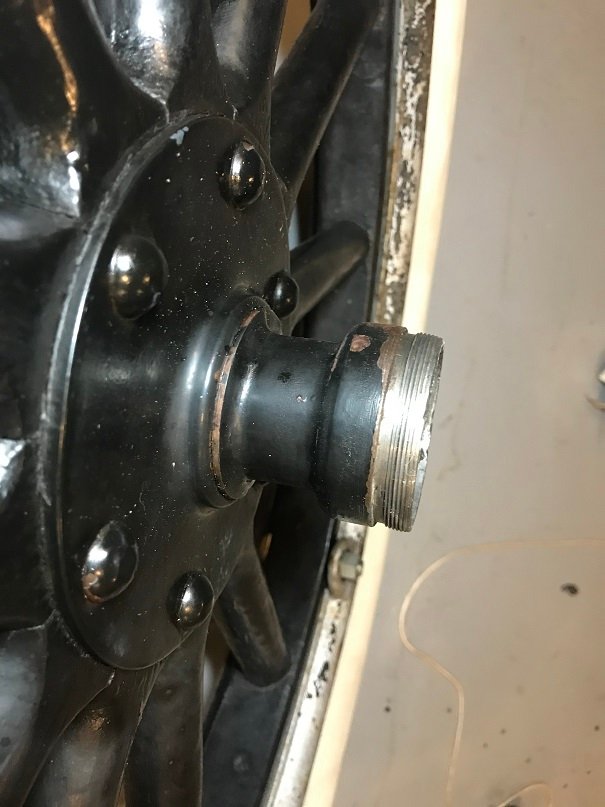

Just got the engine in my car and got it on the road recently. I know I should have pulled the front wheels and cleaned and repacked the bearings before I ever took it on the road. But I didn't. Did about 100 mile drive the other day and all was well. I took a short drive a couple of days ago (about 3 or 4 miles) and when I got home the drivers side wheel bearing was smoking. After letting it cool, I pulled the wheel to check it out. The first thing that I discovered is that the last owner had assembled it with the spindles on the wrong side. The bearing had tightened up so tight it smoked. I got the spindles switched out and bearings pulled. The one that smoked inner bearing was toast. Cage fell apart and rollers all fell out. No problem. I got a new inner bearing and matching cup for that wheel. Today I drove out the old cup and installed the new one. The new cup is sloppy in the hub. I pulled it out and measured the ID of the hub and the OD of the cup (yes I verified that I had the right cup) and the difference is .054'"
What do you guys suggest I do with this? Can I shim between the hub and cup and get it to hold OK? Or is the hub ruined and I need to find a new hub / wheel? Any suggestions would be appreciated.

If you spun the race and the hub is now 0.054 oversize I'm wondering why you had to drive out the old one. If you had said that it was 0.005 loose I would have said just reinstall with Loctite Sleeve Retainer. Any chance you got the decimal point in the wrong place?

Walter: No, I didn't misplace the decimal. I know it seems as if that would be the case. It did take quite a bit to get the old cup out, but the new cup drops in and you can visibly move it from side to side. I measured the bore with the T shaped bore gauge and caliper, and the cup OD with the caliper. 54 thousanths difference. 2.013" OD on the cup and 2.067" ID in the hub. I know that is too much for a locktite product without a shim to take up some space. Do you think this is doable or is the hub scrap?

Not to second guess you because it sounds like you're being thorough, but both the new and old race also measure the same o.d.?Steve Hughes wrote: ↑Wed Jul 22, 2020 3:23 pmWalter: No, I didn't misplace the decimal. I know it seems as if that would be the case. It did take quite a bit to get the old cup out, but the new cup drops in and you can visibly move it from side to side. I measured the bore with the T shaped bore gauge and caliper, and the cup OD with the caliper. 54 thousanths difference. 2.013" OD on the cup and 2.067" ID in the hub. I know that is too much for a locktite product without a shim to take up some space. Do you think this is doable or is the hub scrap?
In any event, 0.054 is too much clearance without any heroic efforts and I would say the hub is scrap unless it is a very significant early hub. Gluing in a shim is not kosher in my book.

I see no sign of the hub being cracked. My suspicion is that when the bearing tightened up that the inner cup started spinning in the hub. The bearing then continued to tighten pressing the bearing tighter into the cup and expanding it as it wore the hub. That would explain why it took a lot of effort to get the old cup driven out.
